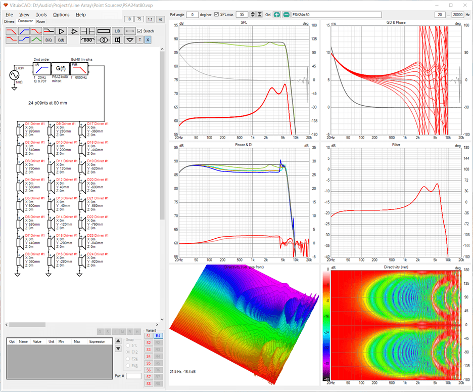

I keep wasting hours and hours trying to come up with a sim of a CBT array in VituixCad that doesn't look like crap, but every time I try to do it with 64mm full range drivers, the performance above 1khz is terrible, no matter how long the line is.
The only thing that seems to improve the performace of the array a lot is to be very far away, like four meters or more. But I live in a 4500 square foot house, and despite the very large size, the furthest I can sit from the speakers is about two meters. (Like a lot of newer homes, there's a lot of rooms, but the actual size of the rooms isn't much different than a 2000' 3br/2ba home.)

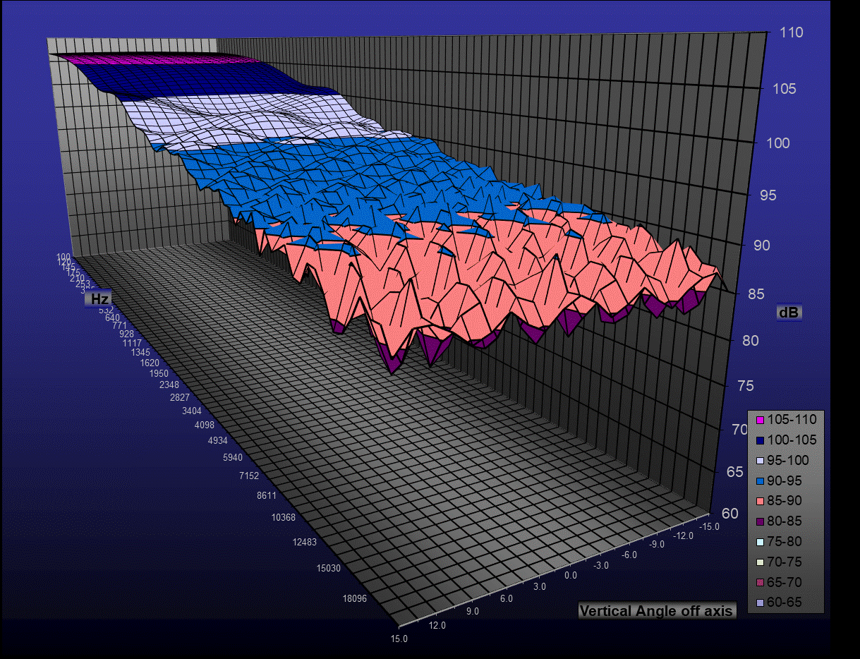

Those 3D surface charts really help illustrate the response. You can create them in Excel, and there is support for 3d viewports in .NET WPF applications, but they aren't available in .NET Forms, unless you buy a scientific charting component from Nevron, Telerik, or some others, with price tags in the $1000 range. I had given up on ever being able to do 3D charting for .NET Forms a while back, but I just found Chart Director. It looks promising, and it is only $99. If it works out, I might try modeling the CBT.

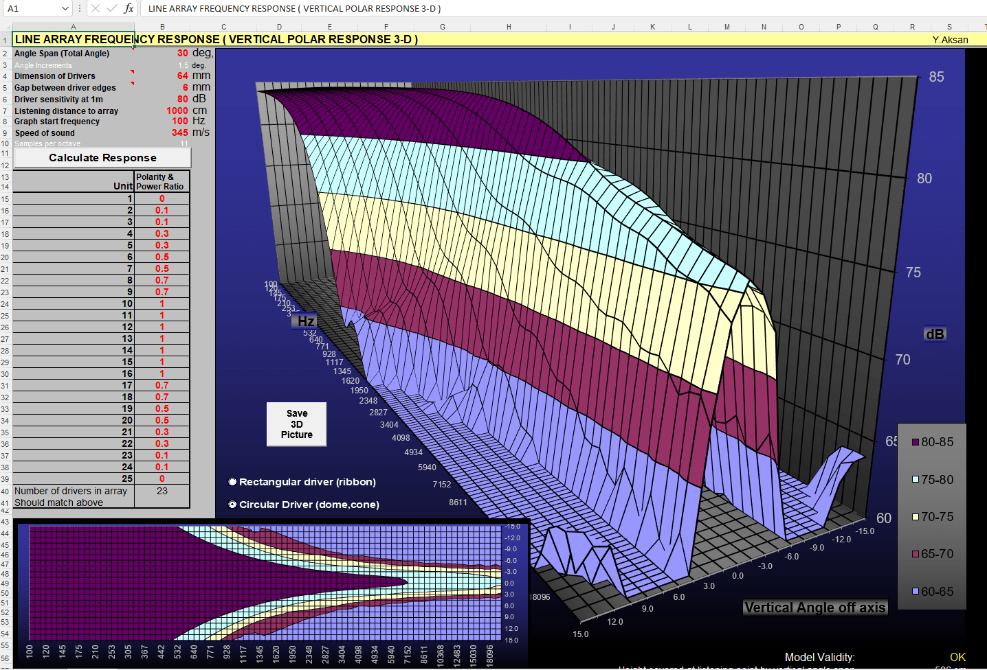

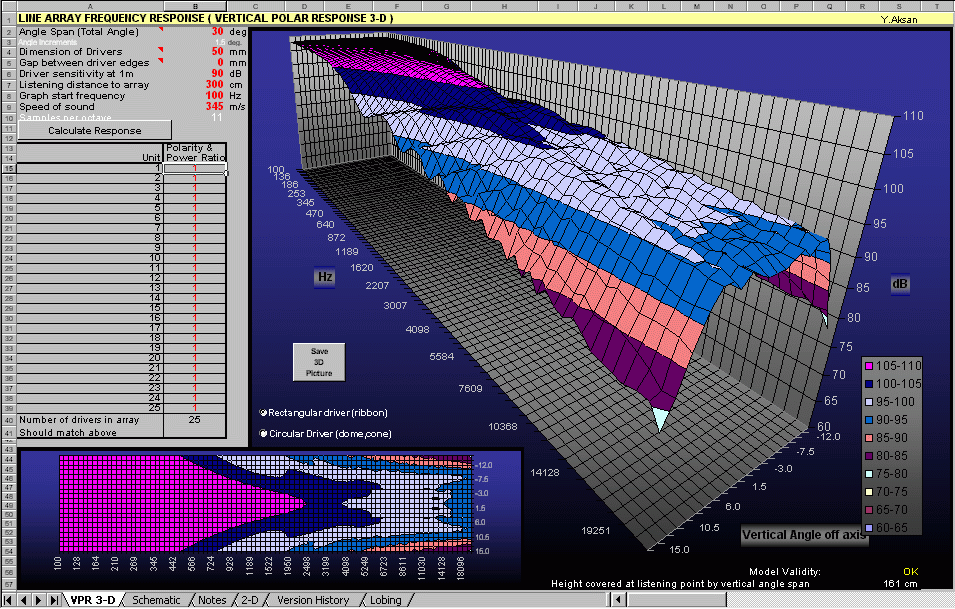

It just occurred to me that we already have software that will do those 3D charts. I believe John Kreskovsky made it, about twenty years ago. I'll see if I can find it.
I found the software in The Wayback Machine and attached it. I did a virus scan using Windows Defender before uploading it.
Here's a description of the software:
"The Vertical Polar Response: Line Array is a design estimation tool to predict Vertical Dispersion, Polar Patterns and resulting Frequency Response in discreet driver grouping Line Arrays and Bessel Arrays. Program can be used to predict long, variably sized, arrays of Circular Piston and Rectangular Drivers in the Near and Far Fields with different inter-driver spacing. Saves 2D Response and 3D Frequency/Angle surface pictures in GIF format, saves Frequency Responses in FRD File format.
Current Version 0.40 Date: Feb 24th 2002
Copyright - Yavuz Aksan 2001, 2002"

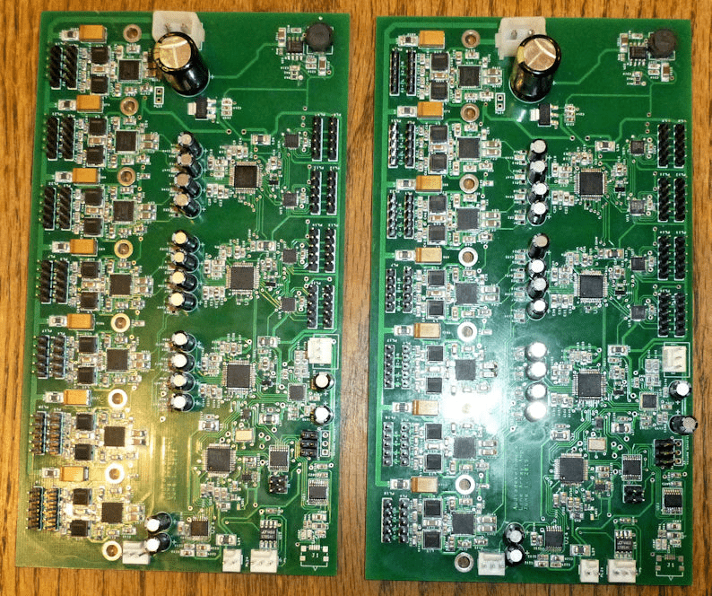

Doesn't this depend on implementation? With DSP, you can easily get very large delays. These boards each have 24 channels of DSP (3 ADAU1701 chips) with 20 small class D amps (the woofer amps are separate).Interestingly, you can simulate curvature with electrical delay, but only for a modest range of angles.

You can delay the drivers on the end to implement a convex array or delay the drivers in the middle to have a concave array. It's the relationship of those delays that determine the direction.
I can change the effective curvature on my line arrays using a Bluetooth app that manages those delay relationships, and the maximum delay I use is about 16". It makes a huge difference in the sound quality, but it's hard to make sense of the comparison because the frequency response changes as the drivers become "focused", and I don't have any provision to change the response with curvature right now. But that's one of the reasons I might try modeling them--to better understand those interactions. I had given up on my old Active Speaker Design code with the 2D charts, but I may try one more variant.

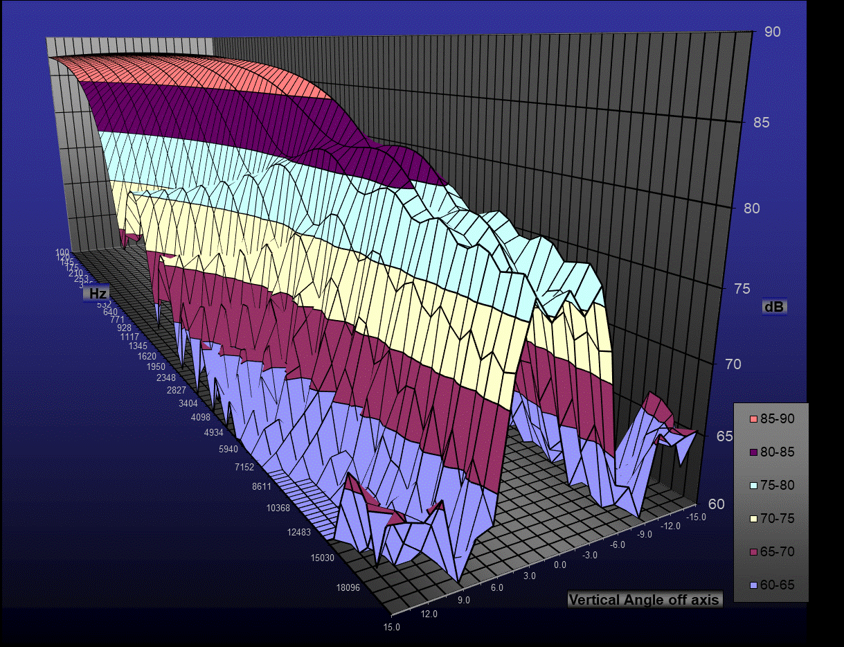

Here's a 3D sim of a straight array modeled using Aksan's VPR spreadsheet.
Both sims feature twenty five 64mm drivers with a spacing of 6mm between each; the only difference is the distance of the sim. One sim is at ten meters and one sim is at one meter.
It's interesting to see how much the output narrows as you get further and further from the array.
Also, this sim seems to make an interesting argument for SHORTER not LONGER arrays. IE, the reason that the response of the array is so chaotic up close is because the pathlengths from your ear to the ends of the array are so LONG. A convex array like the CBT only makes this worse (and may be why it sims so badly.) A concave (focused) array solves this issue, but only solves it at one distance.

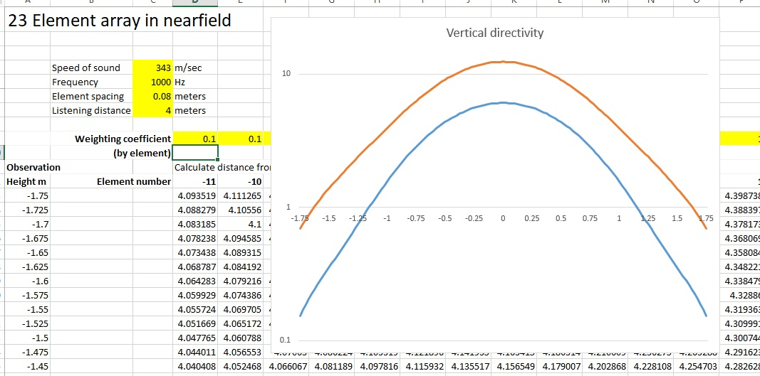

Here are 2 log plotted vertical response profiles. Remember that these are a scan of from 1.75 meters above the array center line to 1.75 m below. I suppose that rotating it 90 degrees clockwise would make it a little easier to picture (excel...) We can see a smooth polar with approximately even response level from 0.5 meter above to 0.5 meter below its center line.
Now these 2 plots, quite similar except for level, are plots of 2 different profiles at 2 different frequencies. The orange curve is 1000 Hz while the blue curve is 2000 Hz. How do we achieve the same vertical polar at 2 different frequencies? Remember that arrays are always scalable. If you want a given array to look the same an octave lower then you simply scale it to be twice as big (you expand it...).
The weighting profiles were as follows:
0.1 0.1 0.3 0.3 0.5 0.5 0.7 0.7 1 1 1 1 1 1 1 0.7 0.7 0.5 0.5 0.3 0.3 0.1 0.1 was used for 1000Hz (orange curve).
the second version for 2000 Hz (blue) was:
0 0 0 0 0 0 0.1 0.3 0.5 0.7 1 1 1 0. 7 0.5 0.3 0.1 0 0 0 0 0 0
Note that the 2000 Hz profile has starting and ending zeros such that its final effective length is, due to only 11 active elements, roughly cutting its length in half. This is how we can have the same vertical directivity as 2 different frequencies an octave apart. The shorter array length leads to lower response level (fewer elements playing at full strength).
This should suggest how we could achieve constant directivity over a wide range. Simply expand the weighting profile in proportion to wavelength as you go down in frequency, shrink it as you go up. In frequency terms this suggests that giving each element a 6dB per octave rolloff with corner frequencies in proportion to its distance from the array center is all you need to do!
The directivity that the above illustrates isn't magical. If you wanted a more directional array then you would just shoot for a longer weighting profile for a given frequency. A shorter profile (fewer active elements) would give broader polar response. The key is making it proportional to radiated wavelength for as wide a frequency range as possible.
Also remember that we are creating a sampled array rather than a continuous one. That means that at higher frequencies aliasing (lobes) will always raise their ugly head. It is, of course, possible to crossover at higher frequencies to a shorter but denser array (say, 7 or 9 dome tweeters close together crossing over to a similar number of more broadly spaced mids).

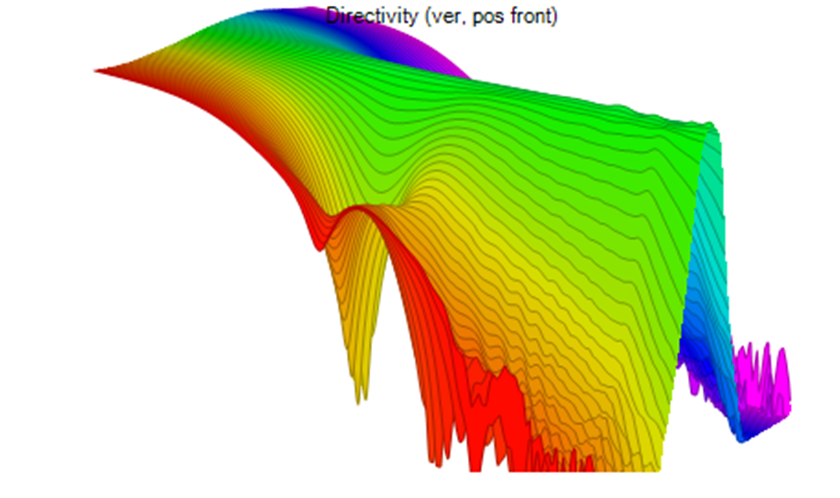

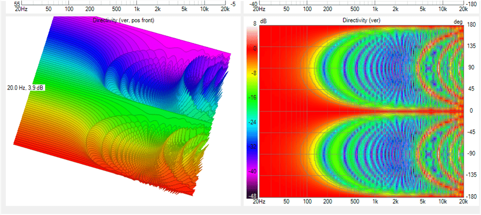

re' 3D plotting - Vituix has it as a surface chart
screenshot is 24 points spaced 80 mm, plots are normalized at 4m
2nd plot is from 10m to raise the onset of combing
