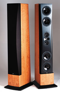

Yes, and in line-source mode, all four midranges are enabled, and the largest main midrange will have higher efficiency than the three smaller midranges. That's what they called it, the "weighted line-source" system. Is this unusual to the conventional line-array speakers?As I recall, it's a 3-way which gave the option of running with either a single midrange dome operating (presumably the one just below the tweeter) or with all four switched in.
Right. AFAIK, the 2030 doesn't use midrange drivers of different size. It just used 4 x 2in domes. It 'simply' gave the option of what it called a 'point source' i.e. with just one of those domes operating and three switched out, or 'weighted' line source where all four of the midrange domes were running, the additional three having a smaller magnet structure -presumably to reduce their sensitivity relative to the primary unit, so they provided a degree of natural output-tapering without actually needing to electrically power-taper.
This is, at the very least, intriguing to me.the additional three having a smaller magnet structure -presumably to reduce their sensitivity relative to the primary unit, so they provided a degree of natural output-tapering without actually needing to electrically power-taper.
According to the brochure, the main midrange driver has a flux density of 1.7 Teslas and a magnetic flux of 1,630,000 nanoWebers. The three auxiliary midranges each have 1.55 Teslas and 1,450,000 nanoWebers.
Can we deduce the degree of tapering from these driver specifications?
No.
As replies go, short & sweet.
But no -you need a lot more information than just two flux density specs. to infer, let alone deduce, anything about any possible output tapering -assuming there was anything particularly significant in the first place. Full driver and crossover data needed, or some fairly comprehensive system measurements -anything else is just guesswork.
