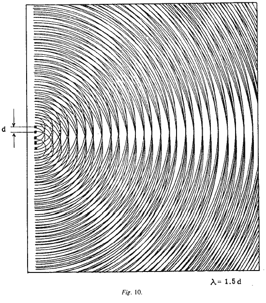

To get rid of the comb filtering you need to use small FRs very closely spaced. Jim's paper gives the math -- IIRC you need a driver smaller than 1.5" to approach 20k (that means like 144 holes & drivers to wire if you use something like the HiVi 1").
Another good paper on the subject is "The Line-source Loudspeaker and its applications" by Paul H Taylor" (Jan 1963, published in the Mar 64 British Kinematography)
In particlular it has a graphic display of comb-filtering. With 5 sources, this should be of particular interest to 7V, shows what happens when you stand up. Note: the chart is for a wavelength 1.5 the driver separtaion, higer frequencies will have a smaller "open" area.
