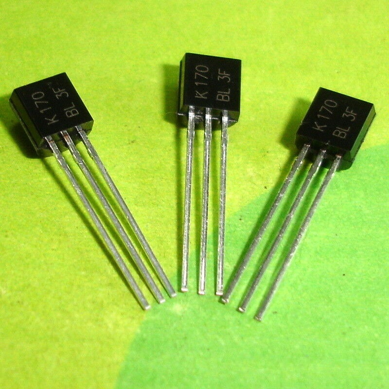

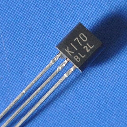

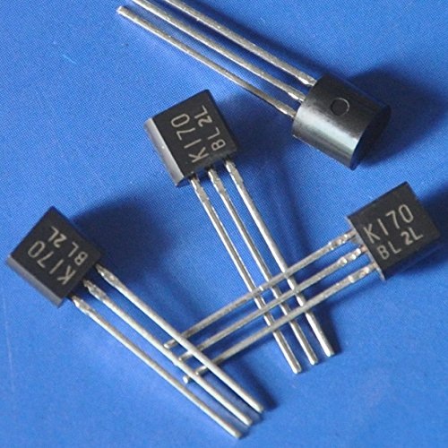

How about this.... 100 PCS 2SK170-BL TO-92 K170-BL Low Noise Audio Amplifier Applications | eBay
100 peaces 2sk170 for 12 dollar.....

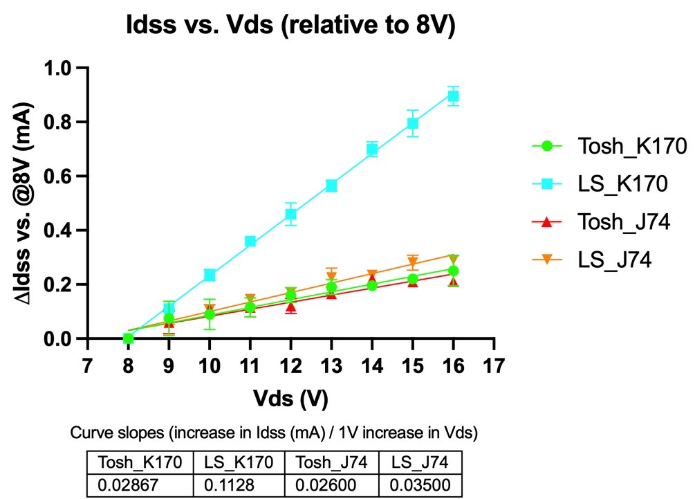

Are you sure? I measured Idss vs. Vds for two samples of Toshiba and Linear Systems K170 and J74 JFETs and I find that Idss increases with Vds. Between the four types of JFETs the Linear Systems K170 indeed stands out with an almost 3-fold increased Vds dependency.Idss of both JFETs drop with Vds, but the NJFET a lot more than the PJFET.
You are trying to correct my English, I guess ? 🤓
I meant Idss of both JFETs drop with dropping Vds.
(Did not say increasing Vds, did I ?)
In any case, our results colerates, and I will avoid LS parts.
Patrick
Patrick
From China, you can get them from me for free, but mayby its only a peace of plastic....How about this.... 100 PCS 2SK170-BL TO-92 K170-BL Low Noise Audio Amplifier Applications | eBay
Not trying to correct anything - and I did miss the 'dropping' part of your sentence, so my wrong.

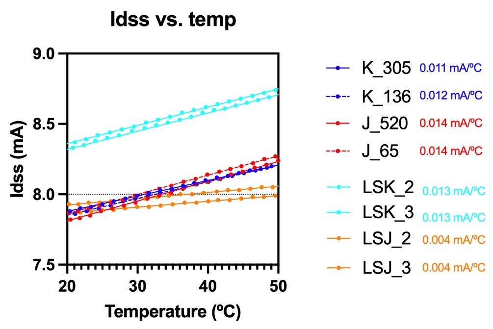

Quite interesting also the (relative) temperature behaviour of these JFETs. Attached is plot of Idss vs. temp for these FETs. This time the LSJ 74 stands out, but for a flat response.....
Did not normalise these data yet

But the Toshiba's have almost identical tempco.
Hence they track each other.
Also tempco depends greatly on Idss, Yfs, etc.
As mentioned in Borbely's legendary article on JFETs.
https://audioxpress.com/article/JFETs-The-New-Frontier-Part-1
You can calculate the zero tempco point with the following formula:
Patrick

I'm doing these measurements as quality control on a lot of degeneration matched NNPP-sets I'm sorting out and the LS FETs were measured just because I happened to stumble upon them in the same drawer 😉
I'm indeed happy to see that matched (Idss and Yfs) Toshibas track nicely largely independent of Vds and temperature.
Can't say the same for the (few) LS samples in my hands.

I have enough LS JFETs to confirm that your measurements are quite typical.
The LS only sit in my drawer.
Won't be used; maybe only for high-rise experiments.
Patrick
