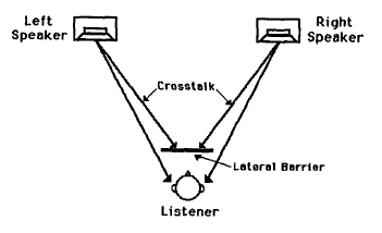

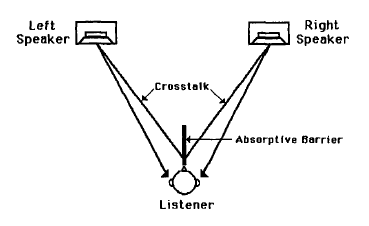

Put a door in front of you and there you have it. Play "Empire Brass in Japan". Amazing depth.
attachment.php
I had similar perception with speakers directly at the side walls with an opening angle of about 90°. It's probably as simple as attenuating the confusing cues from interaural crosstalk.
P.S. Picture is from an Bock/Keele AES preprint.

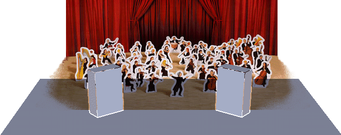

I've tried to visualize the stereo impression that I can get in my room with good recordings:
Grey is (The front part of) my room floor with the speakers >1m off any walls. The recorded space "intrudes" somewhere behind the speakers and can easily fill the complete width of the front wall - if the recording allows so. If I close my eyes I can make the front wall disappear completely. Still I am sitting in an extra loge which is not part of the recorded space.
I can literally walk into that loge by increasing the D/R ratio (sitting closer to the speaker base line). At the same time the recorded space becomes more detailed. Not exactly as detailed as in my illustration, but to some extent. There may be some sound effects from the sides or even the back (when provided by the recording), but there is no continuous recorded impression of space in this loge. I'ts still just my room.
The illusion works best, when the sweet spot has become very narrow.

A board is probably easier to handle and mattresses have unknown properties. An absorptive board would be best but absorption isn't that critical, non-transmissiveness is.
Have you experimented with RACE software to eliminate the need for the door? You're about halfway there on your way to Ambiophonics :D.
