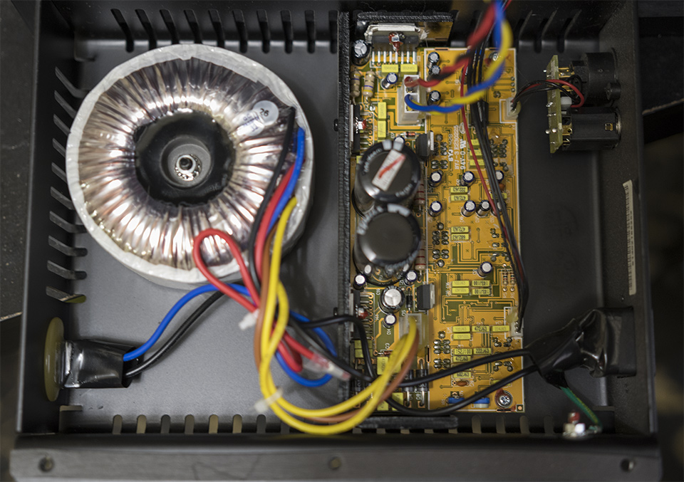

No Class-D amps in it:There must be something wrong. I could not stand listening to the Behringer B2031A
for more than 5 minutes. The sound was quite harsh, probably due to the class D amp in it. I think it would have been a more credible comparison if the Behringer B2031A
had a better amp.
Source: Behringer Truth B2031A Studio Monitor Review @ noaudiophile.com![]()
What we have here is 3 TDA7293 Class A/B chip by ST, two are run in parallel to power the 4 ohm woofer, the single is powering the tweeter. The shared power supply is using a toroidal transformer, two nice large smoothing caps, and it's all put together under a very thick sheet metal housing that acts as a heat sink.
Anyway I own the passive version (B2031P) and - even if are good for the price - I don't like the "kind" of sound produced.
The main problem is the bass-reflex load that - to me - isn't "usable" for studio monitoring applications where trasparency is the key.
Actually, a couple of the B2031A iterations use LM3886 amps in the scheme. Regardless, no Class-D, and no DSP either. All the filtering/shelving/etc is done in the analog domain with standard op-amp circuitry. A fairly nice design actually.

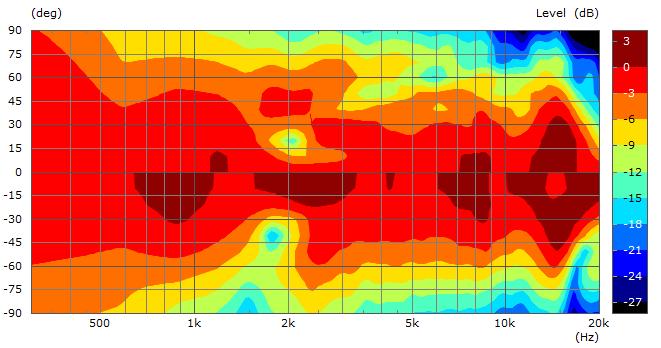

![oJb9NRq.png](https://imgur.com/oJb9NRq.png)
Here's the polar measurement of the B2031A that I measured last week. At the moment, these are my reference speakers, having replaced by trusty Vandersteens which have been banished to the garage now.
The measurements illustrate an irritating trend that I've noticed, which is that manufacturers are producing loudspeakers where the 'stock' response has a recessed midrange. It's very similar to what you see when people in the 70s and 80s would buy an EQ for their HiFi and immediately set the EQ to a "happy face shape" where the curve looks like a smile.
The Vandersteens don't do this.
I imagine this intentional response shape is there to move units; it will sound better in a demo situation.
The solution, obviously, is to flatten out the treble so that it's not so hot. Once the treble is dealt with, the B2031A sounds like a completely different speaker. In particularly, I was stunned at how much better it images.

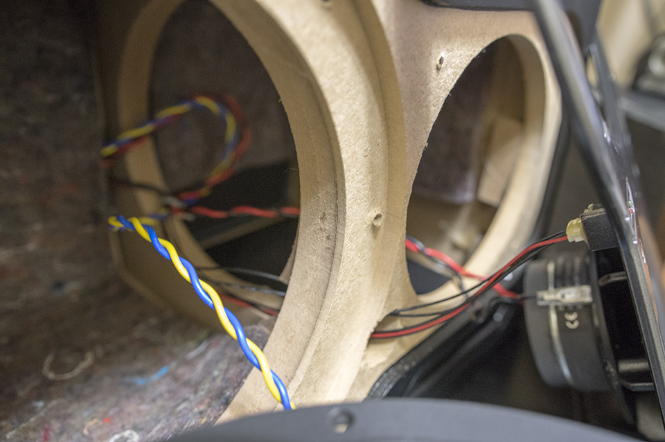

![Behringer_Truth_B2031A_Cabinet.jpg](/community/proxy.php?image=http%3A%2F%2Fnoaudiophile.com%2FBehringer_Truth_B2031A%2FBehringer_Truth_B2031A_Cabinet.jpg&hash=de41f807080aff69ade3c88318d263a1)
Maybe the most impressive thing about the speaker is the cabinet. I've bought speakers at every price point from $40 to $4000 and I'm really not accustomed to cabinets like this.
"noaudiophile.com" wrote "MDF quality is very nice dense stuff, not the usual chinesium crap. The front baffle is a complicated heavily machined piece which is 1/2 inch behind the tweeter, and 1 1/8" behind the woofer which is precision flush mounted to the surface. The center brace is a solid 3/4 inch piece and all of the cabinet walls are covered in a thick carpet padding type material. This is a better box than the Infinity Primus, which was over built massively for the price point. I would say that only the B&W 686S2 beats the Behringer Truth's in cabinet construction quality of reviewed speakers.
Since it's a give that the speakers will need some EQ to tame the recessed midrange, it would be interesting to replace the entire front baffle and use an improved waveguide. Maybe extend the directivity cutoff from 3000hz to 2000hz.
