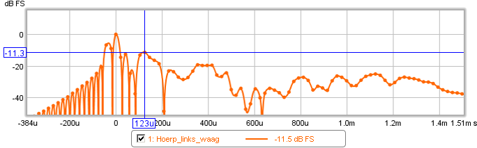

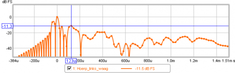

Rudolf's posted IR is nice example; it shows strong reflection(s) at 0.125 ms and 0.4ms:
![rudolf ir.png rudolf ir.png](https://www.diyaudio.com/community/data/attachments/312/312811-a6b647cdf10ed802d7529c358f5cb692.jpg)

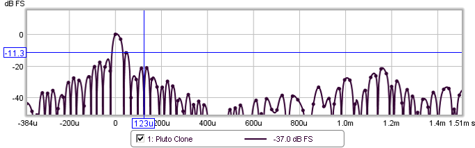

For comparison here is IR of my Pluto Clone:
![pluto.png pluto.png](https://www.diyaudio.com/community/data/attachments/312/312829-39cc5cfcaa2b67bb1e38580c79d94341.jpg)

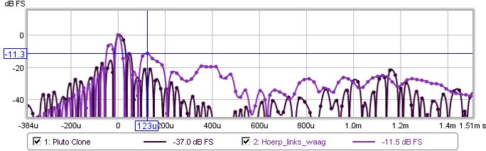

And an overlay of the two IR:
![overlay.png overlay.png](https://www.diyaudio.com/community/data/attachments/312/312847-aa2a74c8f3567e497ca747d81ba958da.jpg)

![334756d1362755281-linkwitz-orions-beaten-behringer-what-overlay.png](https://www.diyaudio.com/forums/attachments/multi-way/334756d1362755281-linkwitz-orions-beaten-behringer-what-overlay.png)
Nice comparison indeed. Thank you very much for taking the time do do it!
I had a hard time initially to get the time scale right in my mind. Rather unusual presentation to stop the ETC at 0.5 m into the room.
0.125 ms equals 4.25 cm - that is the averaged radius of my high- and midrange sound sources (B&G Neo 3 and Peerless HDS PPB 4-25/8). It's the time when the ring radiator formed by the outer dimensions of the drivers sets in (there is no baffle around them). I have no idea yet where I get the 0.4 ms energy from. But we are still very much in the dimensions of the speaker itself.
Do you have any idea why above point zero your response curve oscillates more than mine? Has it to do with measurement resolution?
