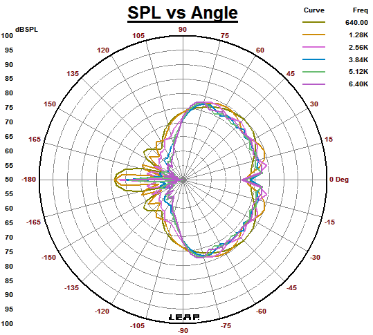

Just two small additions. The smaller the wavelength, the more gets absorbed/scattered upon reflection. The frequencies that cause the most issues imo are those fairly low in the spectrum, where reflections create comb filtering.
The brain is very adept at filtering out room reflections that are perceived by two ears. In other words, your room may be filled with reflections, but the ear/brain systems knows how to give precedence to the direct sound. That's what it does for a living.
The planar concentric ring source will deliver the smoothest radiation pattern by far. Tim Mellow and Leo Kärkkäinen have worked on this lately:http://www.audiodesignguide.com/esl/esl63ph.jpg
The signal for each ring is progressively delayed by using an all ladder style pass filter, each filter provides a small time delay.
http://www.mellowacoustics.com/articles/Dipole_speaker_with_balanced_directivity.pdf
The point source on a large baffle is much worse:
http://www.mellowacoustics.com/articles/Disk_in_a_circular_baffle.pdf
This is the point source on a large baffle:What causes the more “puffer fish” radiation?
![point source large baffle.gif point source large baffle.gif](https://www.diyaudio.com/community/data/attachments/314/314711-ca6eef7afd7a457a656620b854891dc5.jpg)
