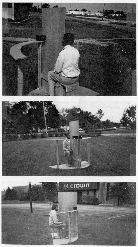

It works very well. For a single listener it is better than stereo triangle.
any loudspeaker of a no matter how high directivity simply cannot transform a room into an effectively anechoic space
it is rather the listening room that would have to be made extremely dead for low freq ITD cues to work
It does not have to be anechoic, not quite. It's not like it takes infinite time for perception to extract ITD cues. Just keep the RFZ

I did try it with a rather large cardboard panel and Behringer B2031P's too but it just sounded like two very close speakers. The sound stage was more or less like in a standard stereo triangle but very close.
Specifically tested the songs Keele listed. Maybe the cardboard was too flimsy or the the board needs to be absorptive or the speakers are too big or...
yep, you need something sturdy. it worked for me with tiny speakers with not much bass output and a 4cm extruded poly barrier. it did not with the main speakers. I tried again yesterday with a 8" matress, did not work either. Probably the best is still a thick wooden planck?

I think that is a bit of an over-simplification ( Right channel to right ear, left channel to left ear) which is easy to understand, and put about by its advocates. The attenuation to the contralateral ear below about 1kHz is so small that cancellation is not practical, however...you don't have to end up with mono at those frequencies. At least with computer simulation, you find that RACE does produce some level of ITD cues from recorded interchannel amplitude differences, although not as large as I would like. I woud expect a (thick) mattress would too, due to the increased path length around the edge.. My own filters produced ITDs close to the maximum, with a constant interaural group delay from 20Hz to 2kHz, ahem, 'on paper'.. The trickiest region is around 500Hz.
