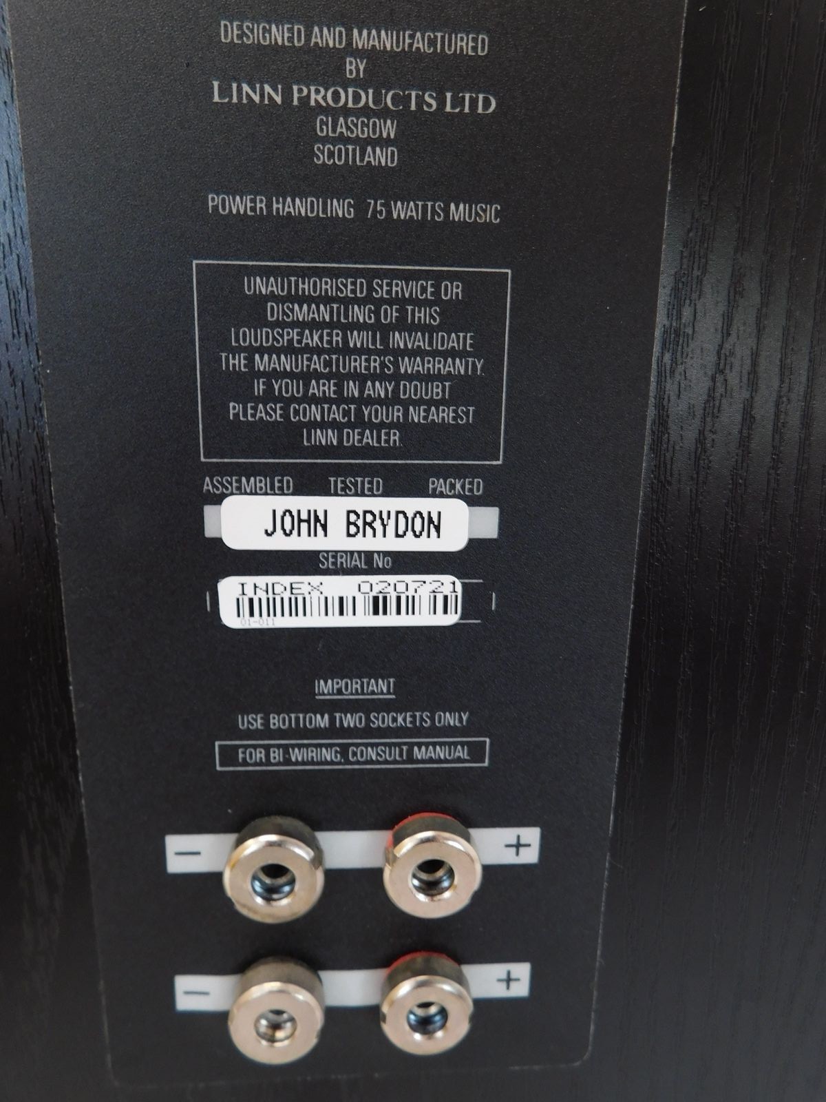

Obvious point - sorry if I am teaching granny to suck eggs - but the photo of the rear that has been posted has bi-wire terminals - therefore are you bi-wiring or bi amping because if you are not then there needs to be a link between the posts (+ to + and - to -) on the rear of the speakers to get the signal from the amp to both low and high drivers. What you may be hearing is just the bass driver working and not the tweeter which would reduced the top end clarity a lot.
Link below shows normal, bi-wire and bi-amp combinations. If you haven't got the metal type connectors then a bit of speaker wire will work.

No, please don't apologise, you might have just solved my problem. I have my wires plugged into the bottom terminals and nothing plugged into the top ones.

The rear of my Indexes:
I would keep it simple to start with, just add a wire between the top and bottom L and R speaker terminals and single wire them as per the top diagram in the link. This will tell you if the Linns are working OK. If you are on spotify ther are a number of speaker test playlists that have frequency sine wave tracks, try these from 50, 100, 1000, 2500, 5000, 10000 to check both woofers and tweeters are working.
Well, I made a couple of bridges from some bits of wire and found four spare banana plugs and wired it up....
Big difference, they now sound great,the missing detail has returned

Well if that turns out to be the case, then it's another example - not that one is never needed - as to what assuming does. That said, the Index was still not my favorite standmount of that era - and certainly not my favorite Linn. I did own a pair of Khelidhs for about a decade before falling down the rabbit hole of DIY in the late '90s or so.
It's nobody's fault. The speakers must originally have come with copper links on the biwire.
Once they were lost, the instructions don't make sense! 😀
