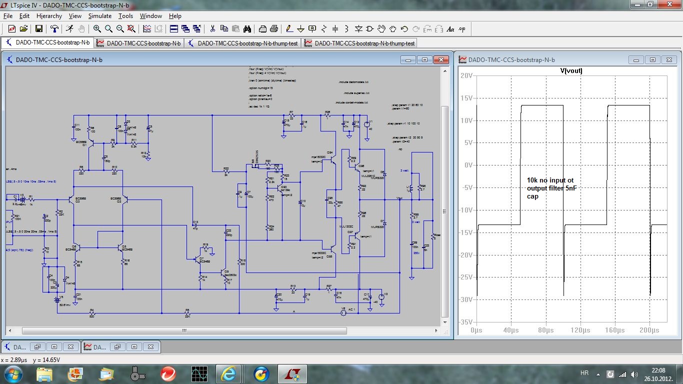

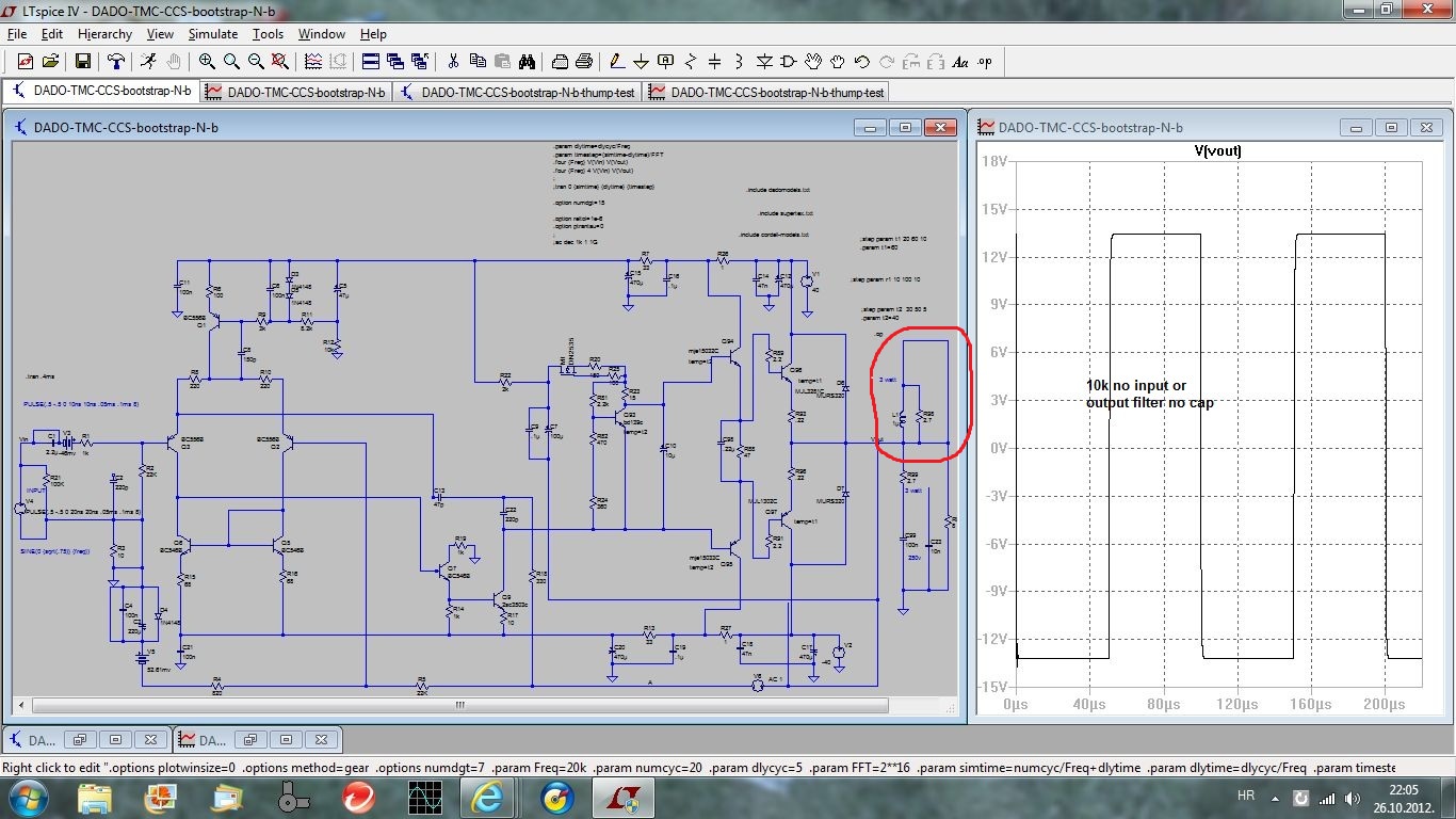

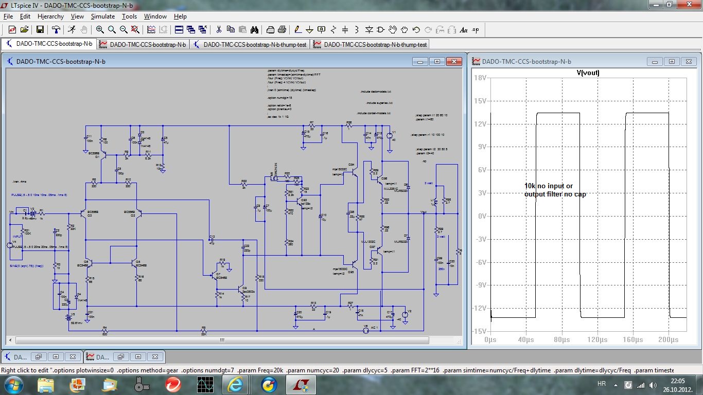

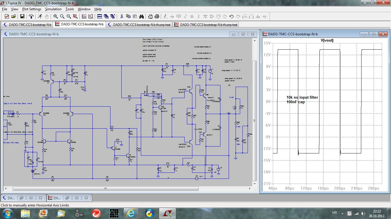

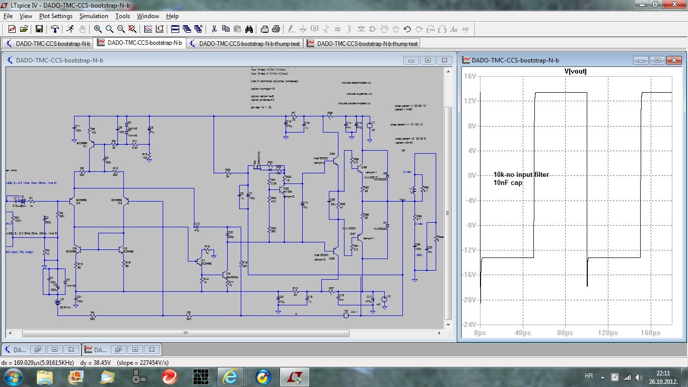

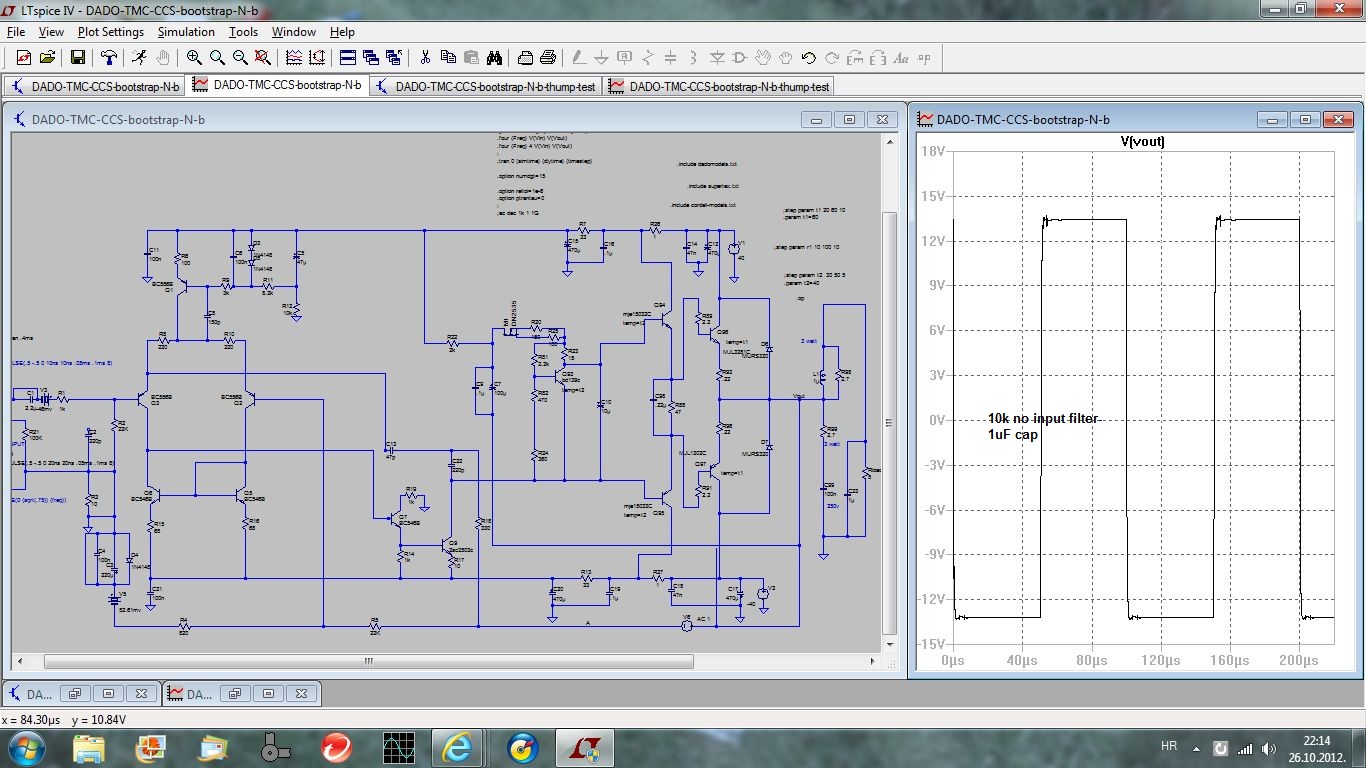

Here is 10kHz square wave simulation without input filter and with and without output filter.
The zobel is changed now, I use 2R7 and 100nF now. Output inductance is 1uH parallel to 2R7 resistor.
dado
dado
Have you adjusted the slew (risetime) of the test sq?
I don't understand you captions.
Some plots say no output filter, but I see the Thiele Network always connected.
I use 20 nsec now.
By output filter I mean an inductance parellel with a resistor. Zobel should always be connected(this is my opinion) and I shorted the inductance for those tests.
dado
I can't see the short across the L.I use 20 nsec now.
dado
Tap the output before the L or after the L.
I would only investigate by tapping before the L, I cannot recall advice to investigate a particular operation by tapping output after the L.
Look carefuly first three screen shots and compare for the rest.
I still cannot see a short across the L.
I can see that sim1 shows the C across the load disconnected.
Do you get a warning that a component has an unterminated end?
Look here again!
No worning, LTspice allowes one side of a component left not connected.
Take a look at the Spice Error Log, there should be warnings for floating nodes.
-Antonio
Yes I remember that now, I have seen it. Thanks
