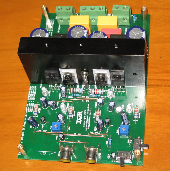

MY DESIGNER。
Reference IR official circuits and wiring.
IRAUDAMP7S-150
By IRS2092 + IRFI 4019 MOSFET FOR audio only.
Full-line design,
Supply voltage range of + - 45V ---- + - 60V

Interesting, that combination is the same as my 2092 design.
The 4019 has low gate capacitance and I use four of them in my design.
I tried the reference design but had a number of issues with it.
To start with the 2092 just kept resetting.
1/ I had to decouple the mosfets very closely.
2/ The VCC rail had glitches on it and needed extra decoupling.
3/ My 12 volt regulator didnt like the 2092 pulsing current and needed extra decoupling.
4/ I kept getting huge thumps through my speaker on power down. The startup capacitor was too big in the ref design and I used 1uf.
I blew up 7 2092's trying to get it working as unplugging the 2092 then plugging it back in with charge on the capacitors blew it up.
Finally got there now with a good solid design.

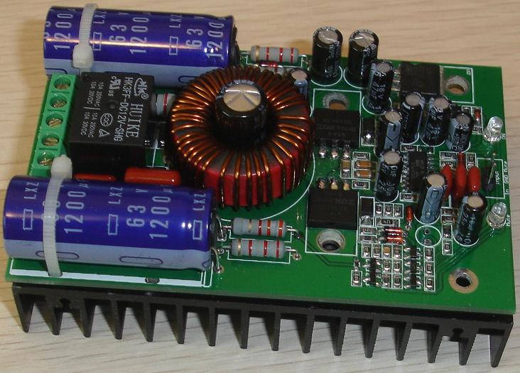

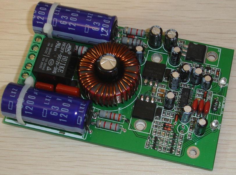

Here is mine...
Single channel, IRS2092S driven class D amp, output power up to 600W (with other MOS-FET's and caps) the shown one has 300W. the main application is multi-channel amplifiers. it only requires the main differential supply voltage, and has some ingenious power management scheme to save power as much as possible. Dead-time is set to min. 25ns, and the pk-pk overshoot is about 2V only, due to the tight layout.
I've made them for a friend who integrates them in some amps which he build. Soon i will have a batch for sale on my site too.
