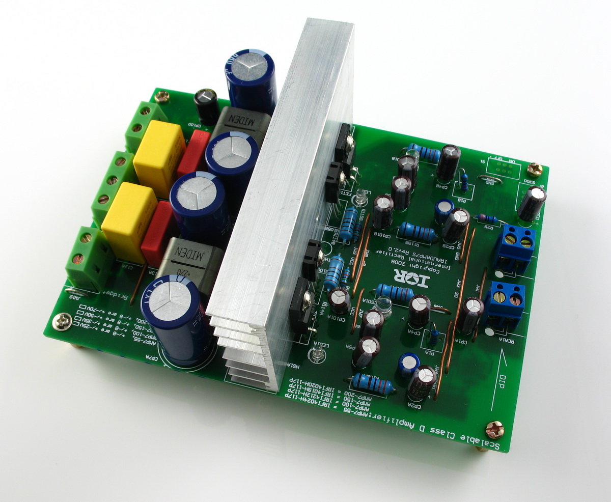

Single channel, IRS2092S driven class D amp, output power up to 600W (with other MOS-FET's and caps) the shown one has 300W. the main application is multi-channel amplifiers. it only requires the main differential supply voltage, and has some ingenious power management scheme to save power as much as possible. Dead-time is set to min. 25ns, and the pk-pk overshoot is about 2V only, due to the tight layout.
I've made them for a friend who integrates them in some amps which he build. Soon i will have a batch for sale on my site too.

hi people,
I have build a prototyp with irs2092 and irfb4212. Two things struck me.
-the amplifier have a strong noise, I can it hear till 50cm from the box.
-the amplifier disturb the the radio(HF-radiation).
Do you have similar experiences?
AMP in the use of noise in this very small, I took him to work in 680K HZ.
Using shielded filter inductance. 22UH, will be about +-40V 680K square wave signal filtering is very thorough.
The remaining approximately 200MV + - 680K HZ sine wave.
Most of the noise because the ground is because the PCB LAYOUT interference caused
Please refer to IR IRAUDAMP7S PCB LAYOUT.
I also have IR official template design products. In use, did not hear a difference.

I had a problem with my first 2092 pcb.
I tracked it down to noise on the VCC line.
I fixed it with a 47uf right next to the 12 volt regulator.
I have a question about that. My circuit isn't really functioning well.I had a problem with my first 2092 pcb.
I followed the application diagram except i added some decoupling. A BIG capacitor over the drain and source of both fet's, a BIG capacitor over the B+ and B- and a pretty big one from my VCC to B-.
For the VCC i used a 7812 with input +B, reference (gnd) -B and output the VCC line. I found this in the IRAUDAMP document, but that means it has a voltage drop of 40V or something? Isn't that way too high?
THen my last question: Is it possible to test it without connecting the low pass filter and speaker? I want to measure it first before adding a big load..
I use a 200ohm dropper resistor from 45 volts to the regulator.
You will need to decouple the regulator on the input and output as close to the regulator as possible
I was getting something like a 1KHz tone when the regulator wasnt decoupled properly.
I was also getting quite a bit of background noise until I earthed the input ground.
