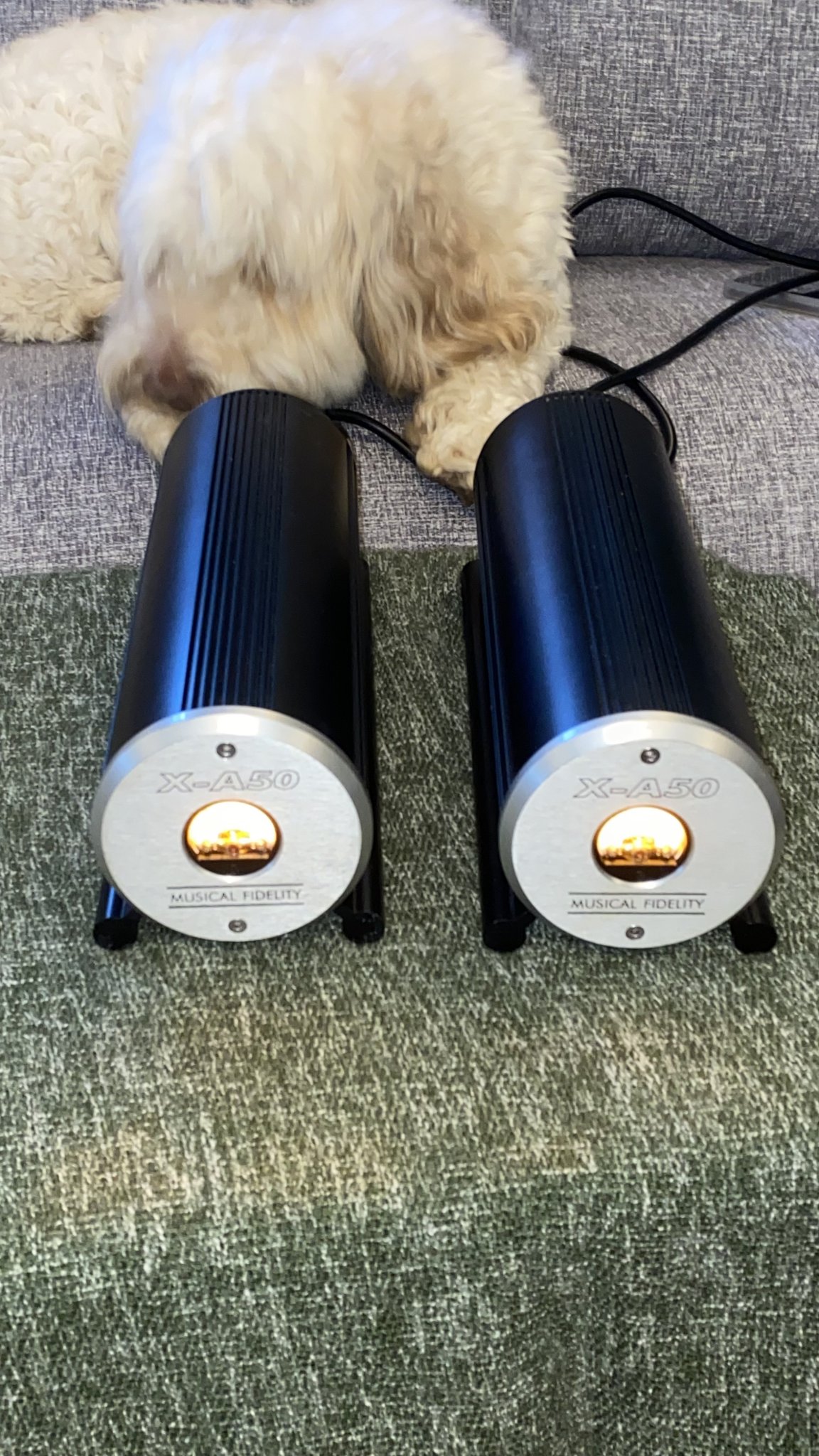

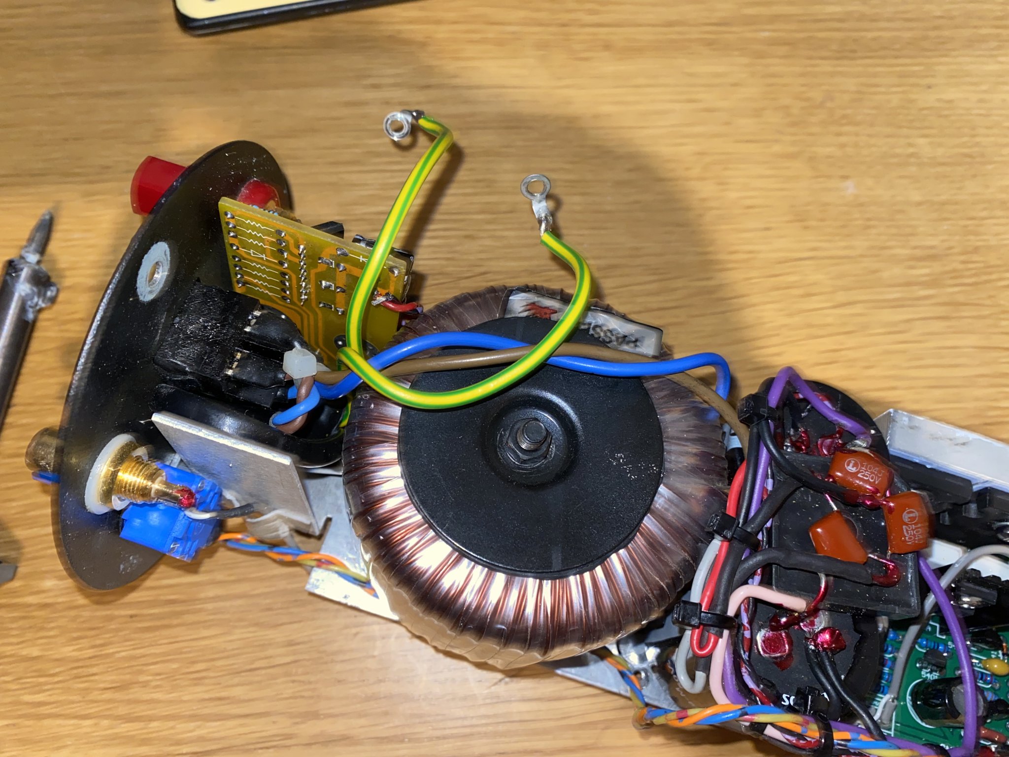

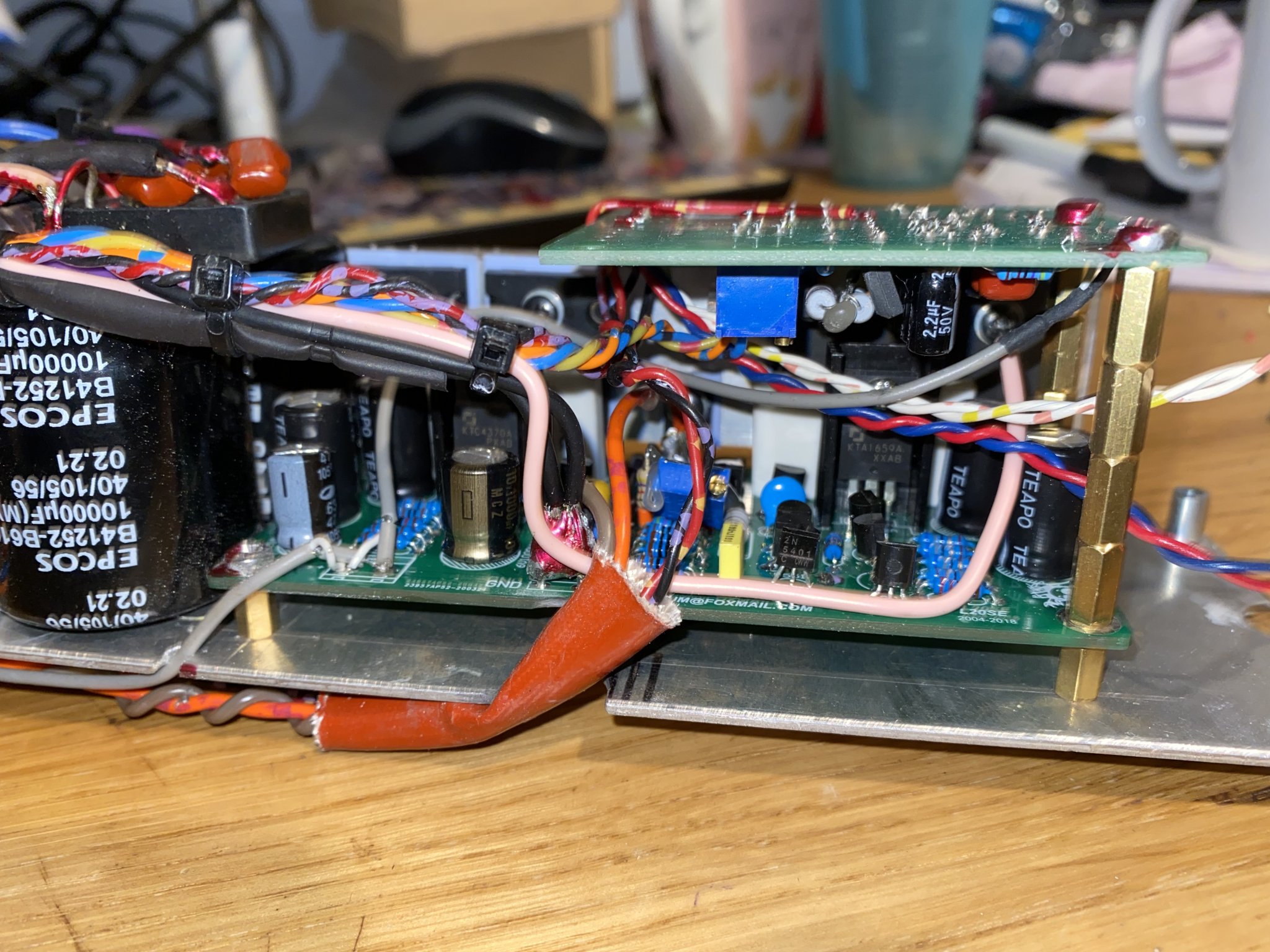

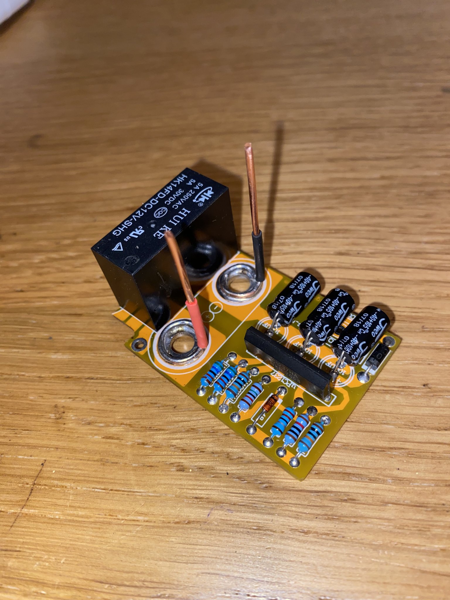

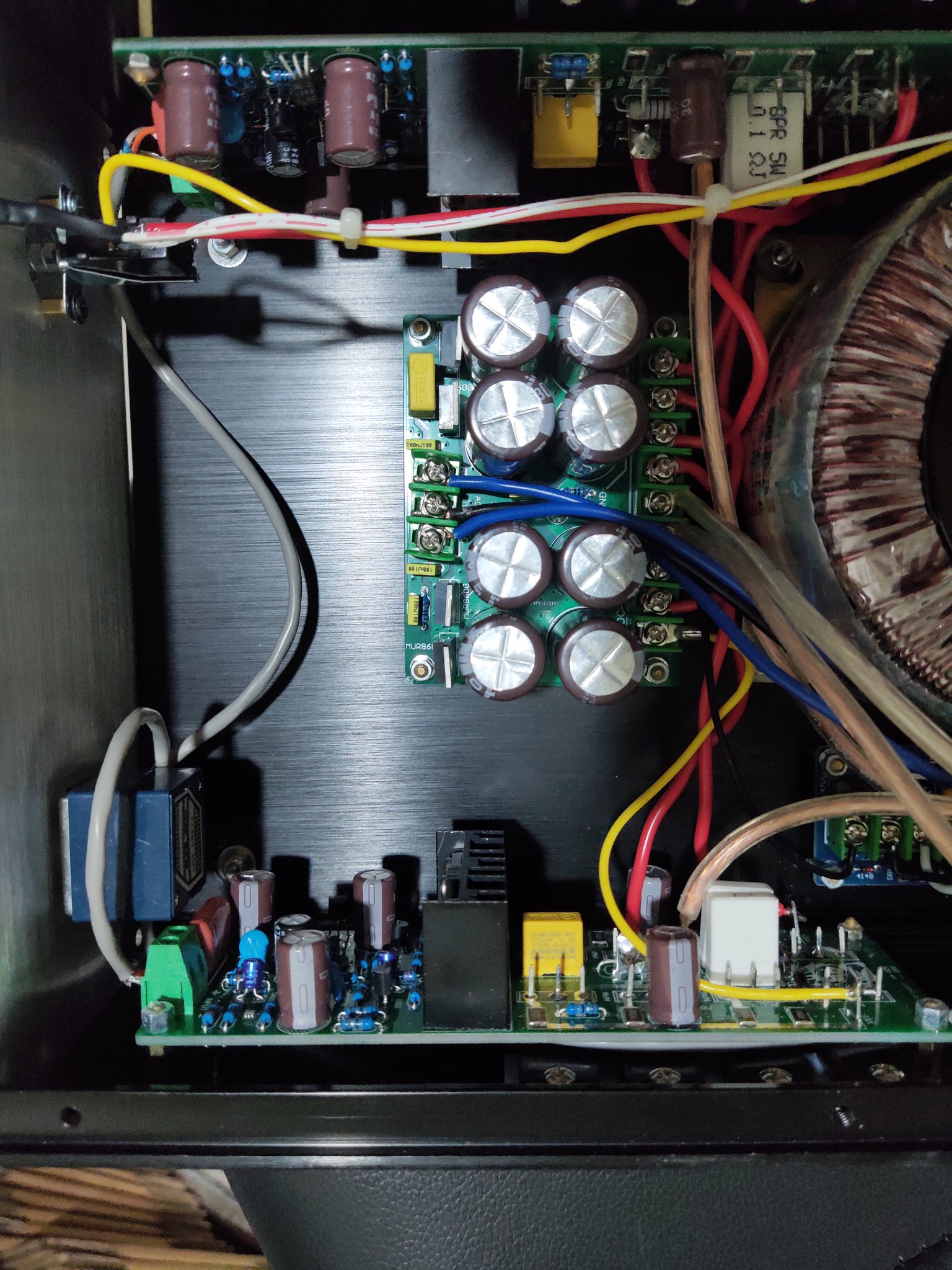

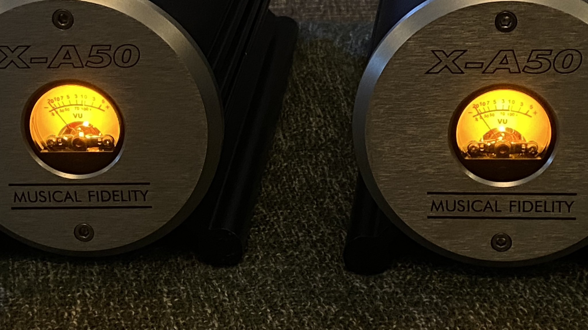

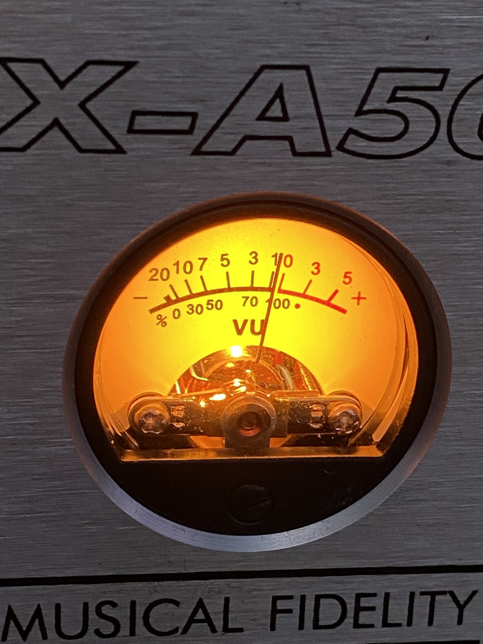

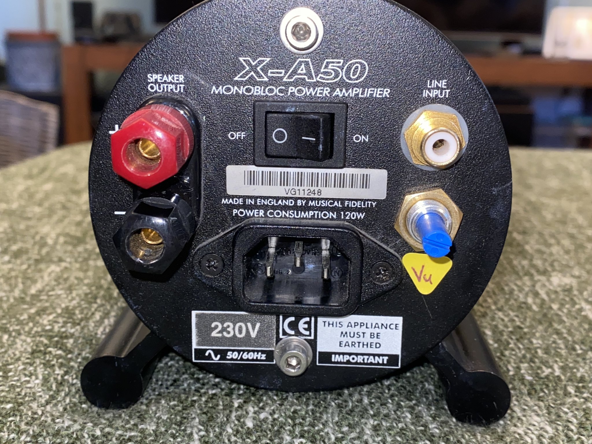

Been working on a rebuild project for a pair of mono bloc musical fidelity x-50’s. These had no protection and had blown the outputs. After deliberating I decided to go with a full rebuild using The amazingly clean L20SE amp boards with new caps etc but also fit power meters and protection.
All done. Sound is so clean, no noise and very balanced and detailed low to high at comfortable listening levels. Was tight to get it all in. Pics to follow.
Pics of finished project.

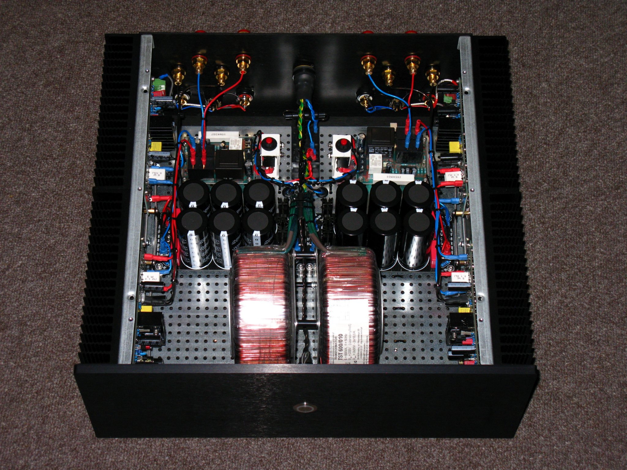

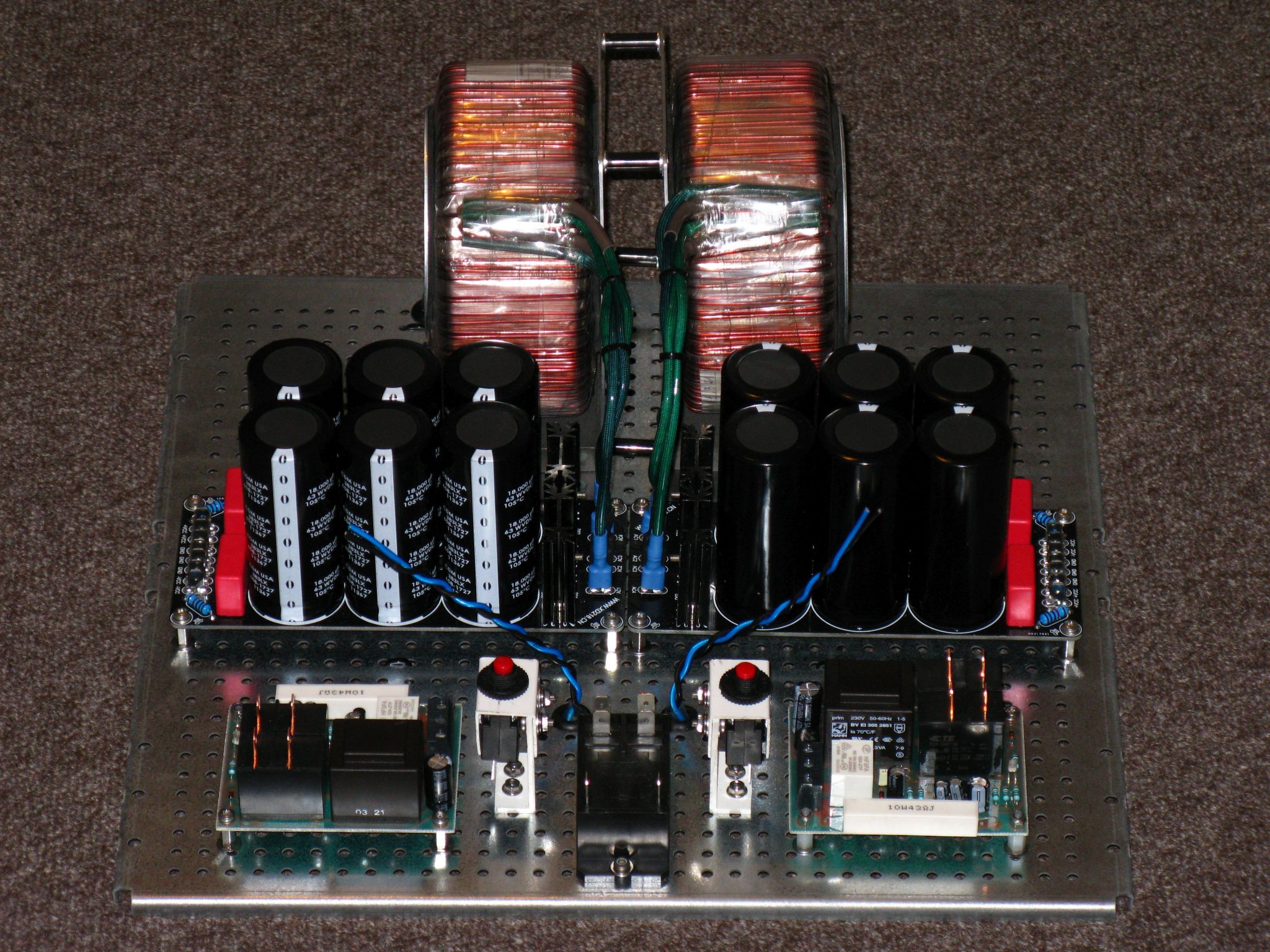

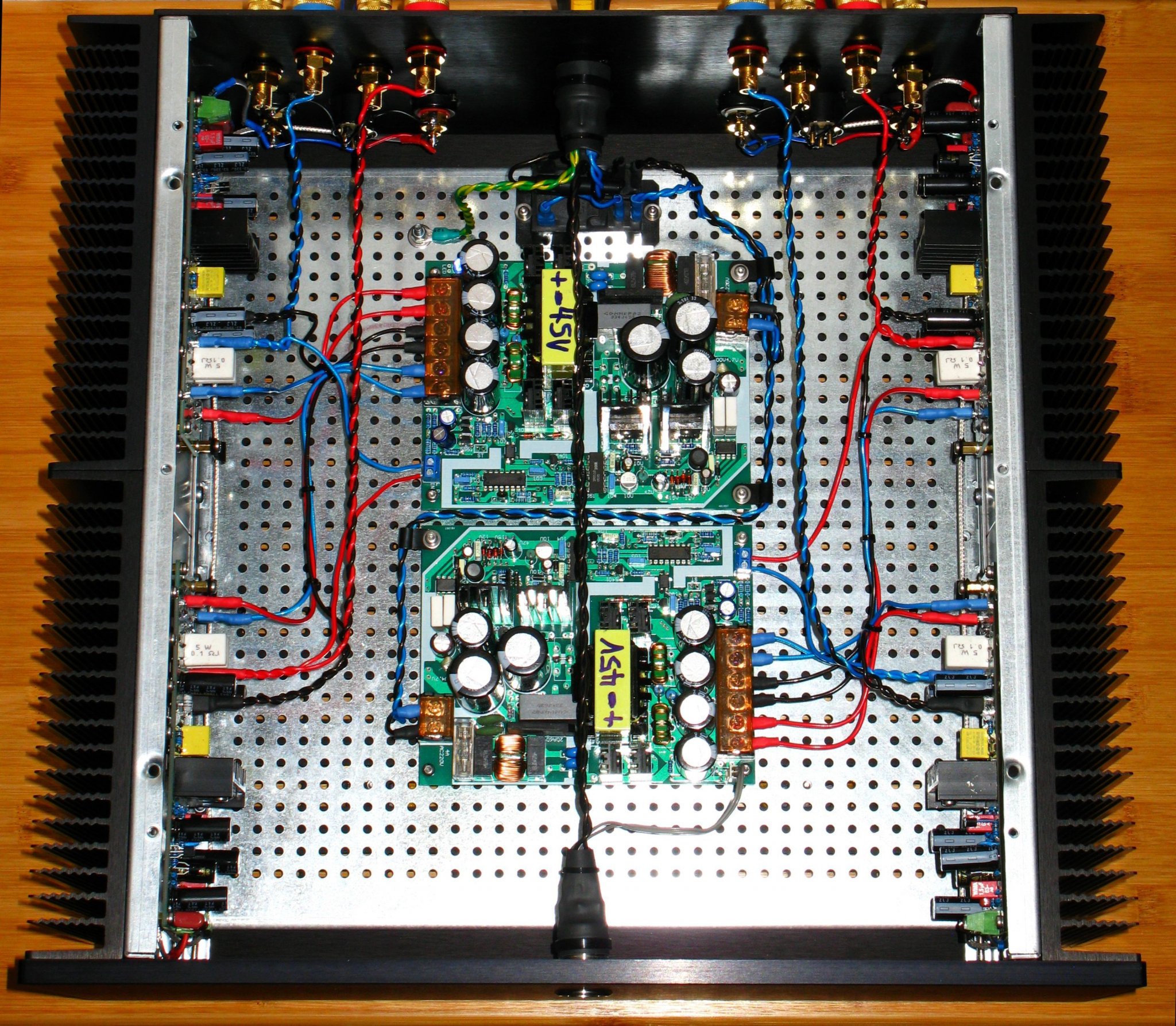

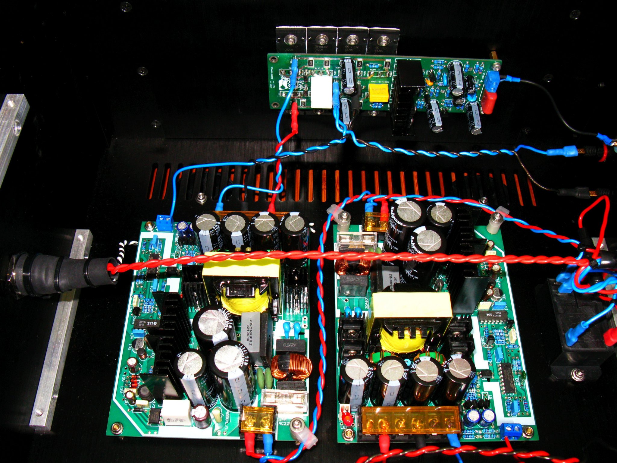

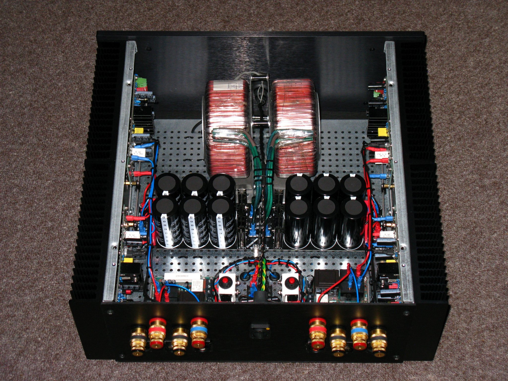

Hey,
L20.5 Bridge-Amp ( or 4-Channel Amp ) with conventional power supply .
Greeting
Michael
Greeting
Michael

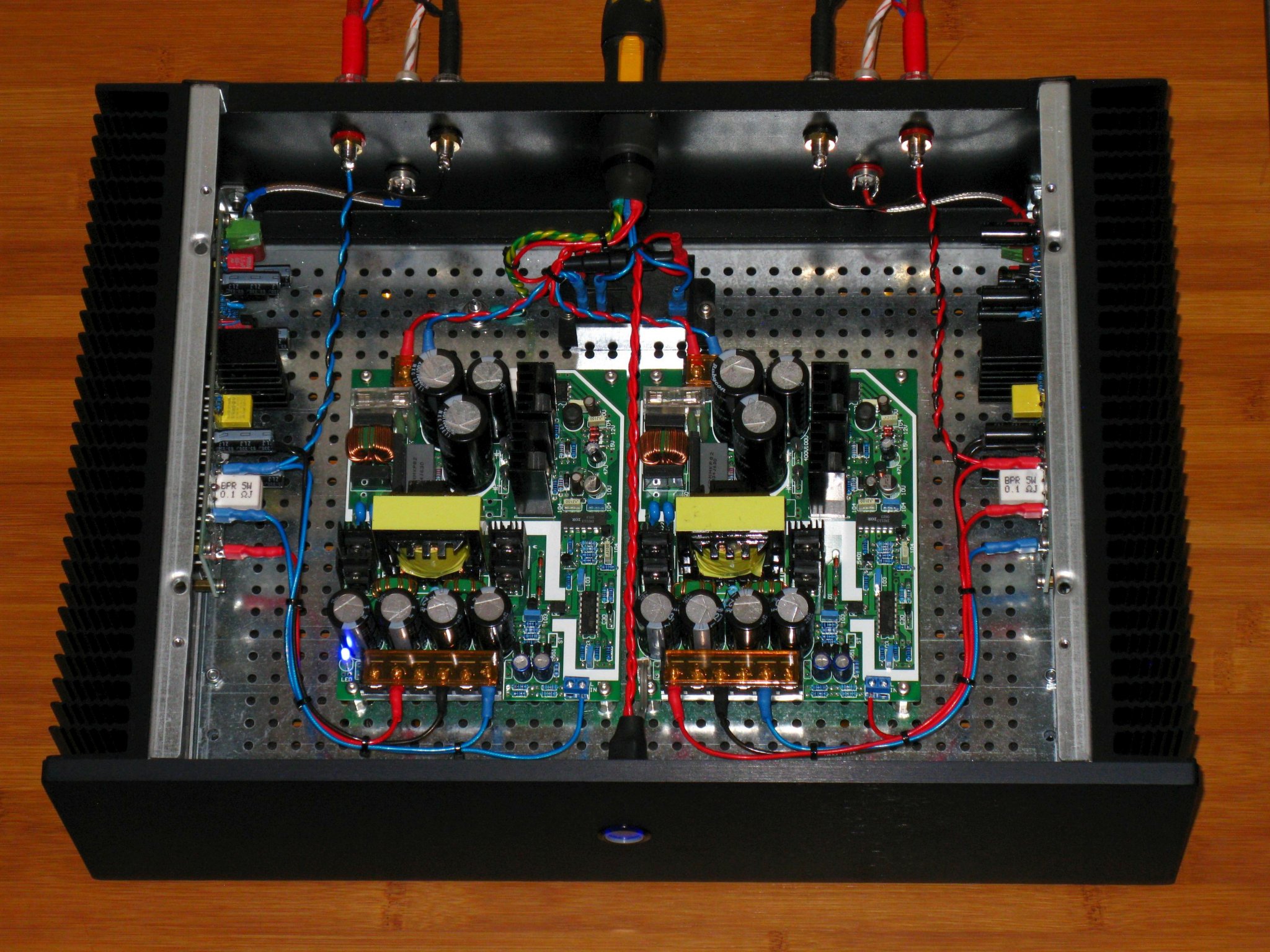

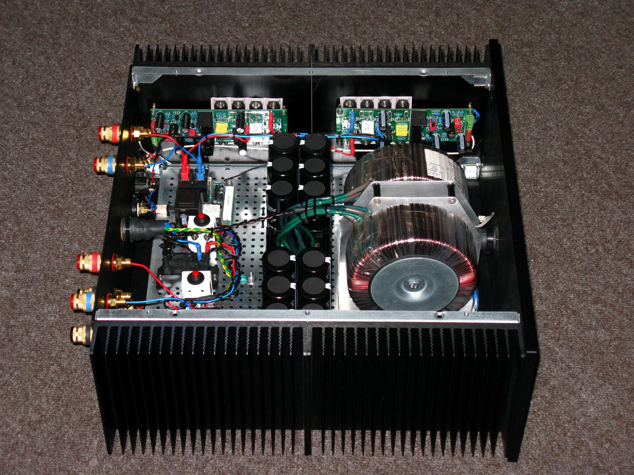

Hello,
my L20.5 DIY-Amps.
L20.5 No.4 Bridge-Amp
L20.5 No.3 Stereo-Amp
L20.5 No.2 Stereo-Amp
More information: HERE
Regards
Michael

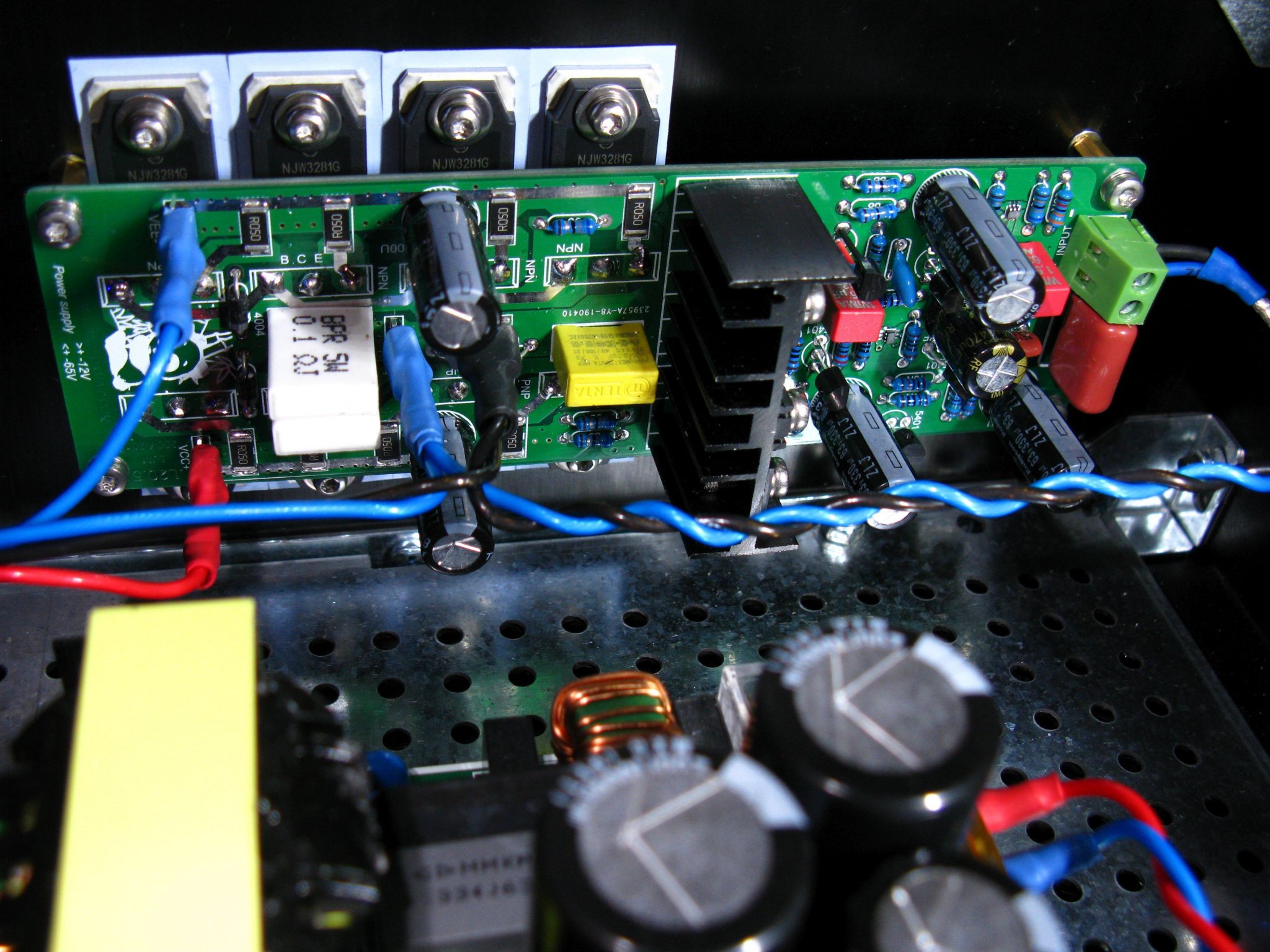

look amazing as always, i actually am finishing up my 20.5 which i modeled after yours. i purchased 2 of the exact smps units you use (58v), but one arrived DOA and the other got blown up when my 20.5 modules smoked. as many have stated, had the D1047 & B817 combo and they didnt last much past the 3rd power up
so i had to rebuild the boards, and after reading your posts in the diy hifi forum, looks like you and i went the same route in 'modding' the board
i replaced the main transistors with toshiba 5200/1943 (looks like you did the NJW3281G/NJW1302G combo), i found a diy forum member who had authentic toshiba 1930/5171 drivers, i do not know how others will fair in this manner as they are no longer made. i too left the 699A in place
i also went and replaced all the 120uf/80v caps with nice panasonic 150uf/100v ones, 10uf/50v with a 10uf/63v UVP nichicon. my board had a nice nichican 470uf/16v already in place, so i left that as is
i randomly also replaced the R050 1w with 2w versions
and then for SMPS, got a connex SMPS500R +/- 54 from hifimediy (US warehouse)
just waiting on beefing up my case with some additional headsinking, so i'll post some pics when i finish up, thanks for the inspiration!

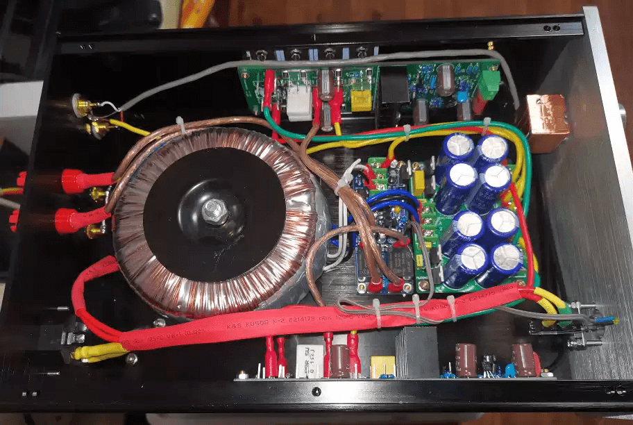

L20.5 installation is slightly more difficult. I often help customers assemble l20.5.
It has been used for more than 5 years. None of them is damaged. I use 8171047 or njw0302g 0281g.
Use 1659a 4370a. The test results are identical to 1930 5171 APSYS. There is no performance difference. But there were many fake goods in 1930 5171. I don't recommend it.
L20.5 outer hexagon nuts must be used. Use a wrench. Add screw cushion.
Please refer to the machine I installed yesterday.

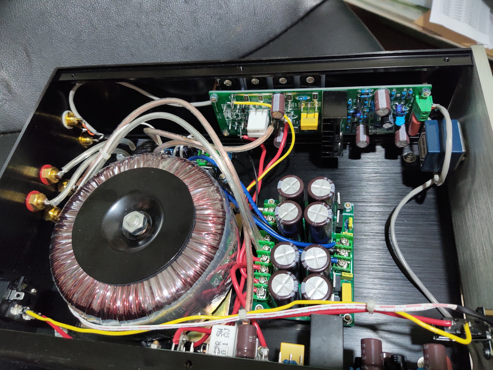

Ljm L20.5 with 300 VA and ¿36 Vac? Are not heatsinks necessary?
The transformer is too close to the rest, let alone the speaker cables, as the box is so small. Woul did not it be more logical to use two boxes, one for amplification and one for power? Or a big box.
You're right. If you can. A wider chassis is recommended.Hi,

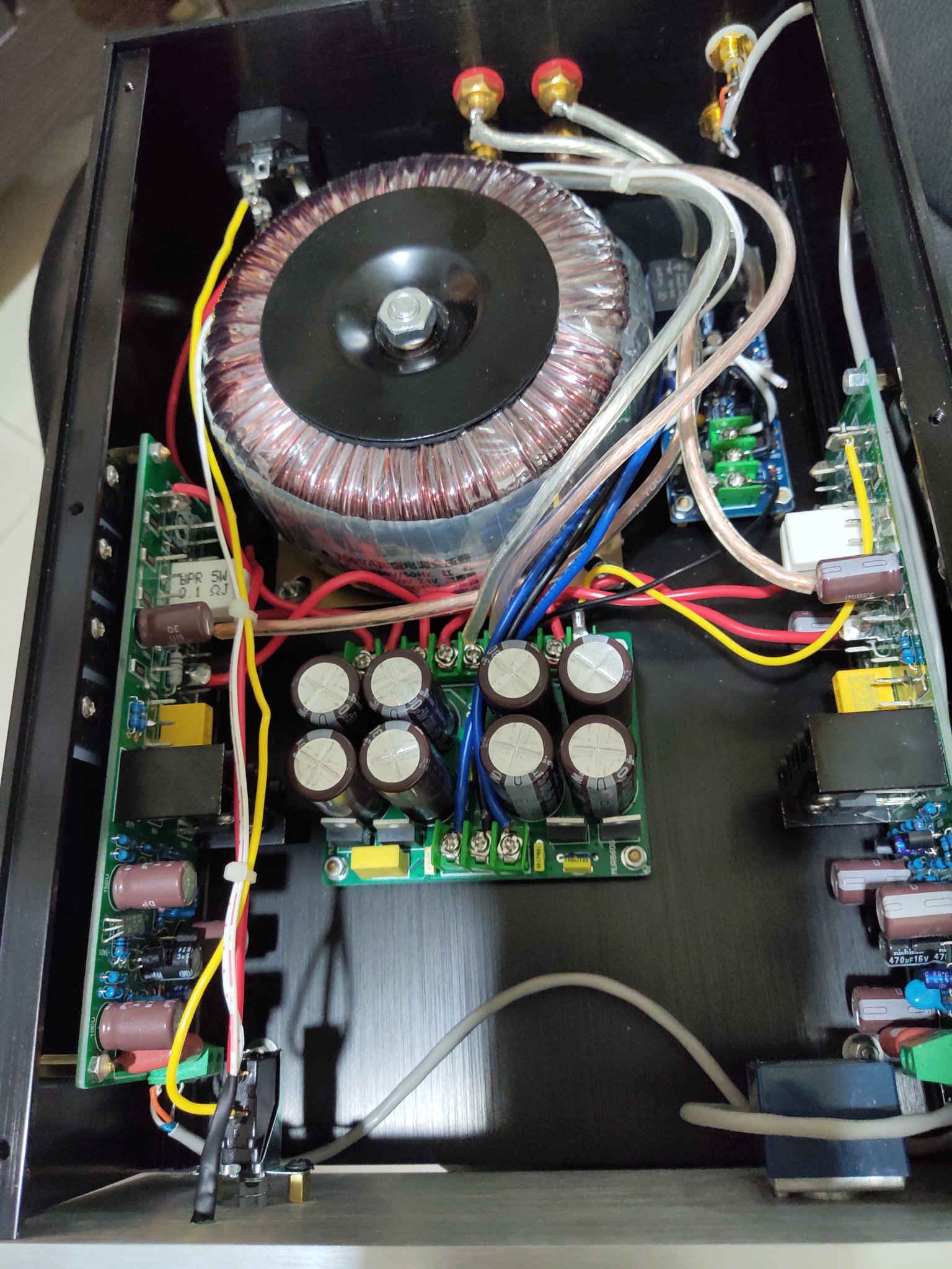

From LJM Audio shop (Taobao)
https://world.taobao.com/item/558915415270.htm
I use AC 24-0-24.Will be huge problems. You need heatsinks an a bigger box.
It's basically not hot. The temperature is about 40-45 ℃.
The indoor temperature is 32 ℃.
In fact, a lower voltage is used. The calorific value is still very small.
