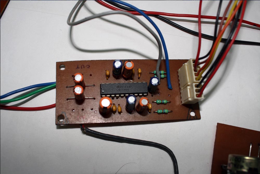

I liked the sound quality and BOOST CUT level of the chip very much but the noises.
The system I used:
1. On tone control PCB 0.1 mfd and 100 mfd caps for filtering.
2. Tone control Board PSU has 16V DC > 1000 mfd/25V > LM7812 > 220mfd/25V and .1 mfd
3. Tone control board input cap = 1 mfd/63V electrolytic, output cap 10mfd/40V electrolytic.
4. Power amp used = LM4766T with +-28V supply.
Also I am attaching the files I followed for this preamp.

Hi diptangshu,
I think I can be of some help with your preamp circuit. It definitely sounds like you have a relatively decent setup, we just need to get you past the "motorboating sound" issue.
This is actually somewhat simple to achieve. It's just a matter of changing 4 capacitors.
Now for the preamp input caps I used a 1MFD electrolytic capacitor. For the preamp output capacitors (this is where trial and error may come in) In my setup I went from a 10MFD to a 0.47MFD electrolytic capacitor (I had a choice of either 0.33MFD or 0.47MFD). I know it may seem like a small MFD value but trust me on this one. Someone may be able to explain the technical reasoning behind this better than I can but here is what i have observed:
When i use a higher MFD value, just enough to make the annoyance somewhat stop, I have noticed that when playing a music track with a good 'pop' type bass beat (not a rumbling low boom type bass), I have noticed the speaker cone wobbling in an unusual way, kind of like a bouncy car suspension. It has a ripple effect to heavy beats. It really was supposed to be an instantaneous beat. If i cranked up the volume to a relatively loud level during these beats it would once again start that annoying 'motorboating sound' once again as i turned it back down. I've also noticed that the 'motorboating sound' is sort of like a feedback. Me being a late 70's and early 80's home audio and ghetto blaster "boombox" fanatic I know this ultra low wobbling of the speaker cone during beats like that usually would require a subsonic filter. The cheap and easy way of creating a subsonic filter would be to just lower the preamp output capacitor values. SO instead of my initial choice of using a 10MFD capacitor, i lowered it to 0.47MFD.
In addition of killing that annoying issue I took the time to put a zener diode on the the VCC+ line and added a filter capacitor (1000 MDF) on the V+ power input for the preamp (all on the preamp PCB) to further isolate any possible voltage feedback to the power amp. I'm not sure if that is verbally correct but i'm sure you and most can somewhat understand what I am trying to say. All I can say is that it worked for me and has not bothered me ever since.
Try those values and let me know if that helped you out. Also try adding the zener diode on the VCC+ voltage line input to the preamp for the added isolation.http://www.diyaudio.com/forums/images/smilies/smile.gif

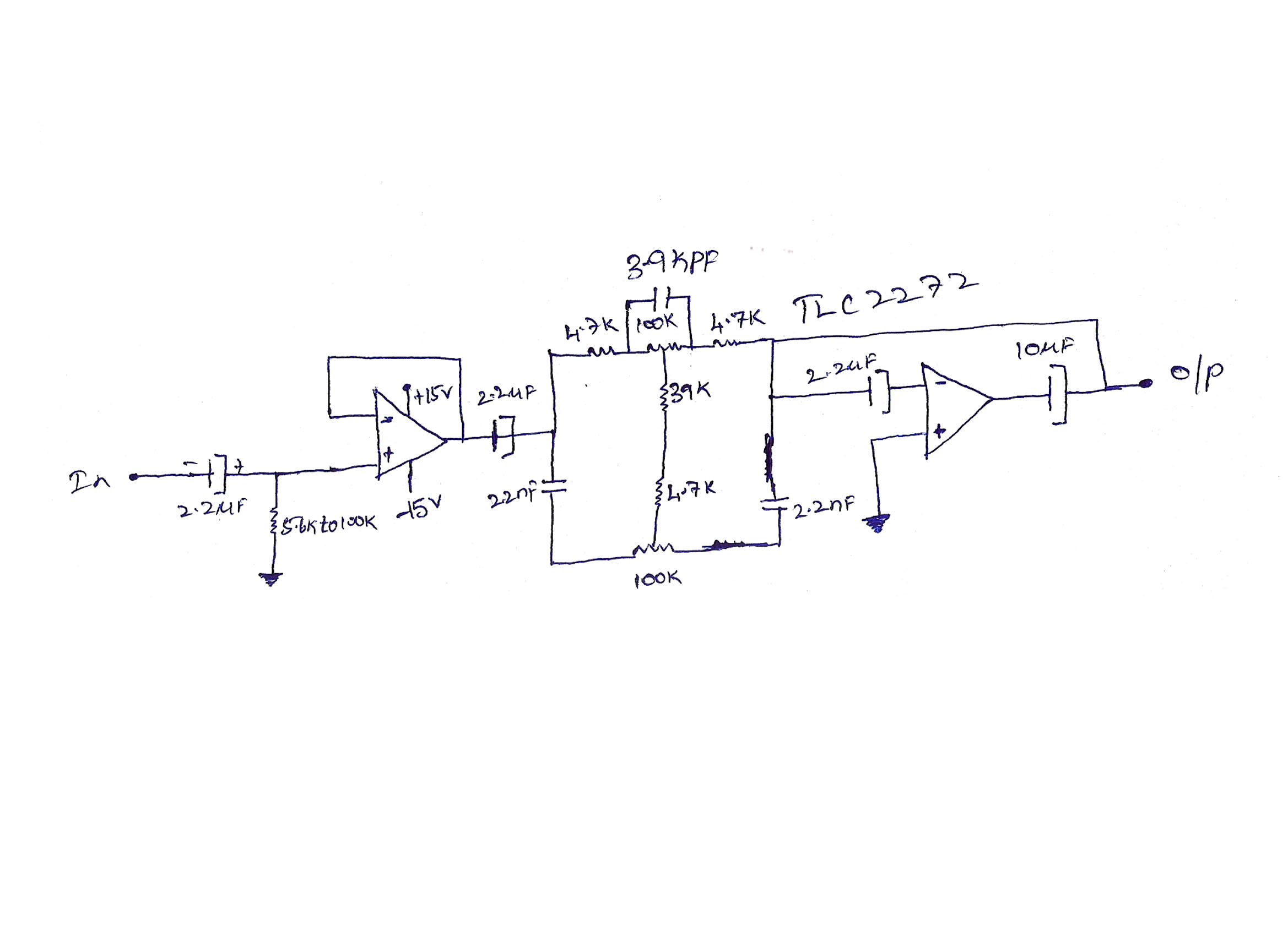

Hi Kamal,hi
this is kamal
try this circuit this is best choice for home use amplifiers
I have used this basic circuit in the past, which is known as a Bandaxall tone control circuit. After experimenting with the LM1036 I have given up totally on the Bandaxall tone control circuit for the following reasons:

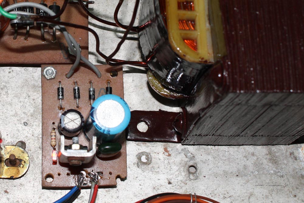

By the way here is my very simple power isolator circuit that I have used. This circuit prevents those annoying oscillations when connecting the power amp to the LM1036 based preamp. I have found that my problems was due to some type of feedback that required some form of power isolation without taking the dc-to-dc converter approach.
How I came to this conclusion was that all of my problems went away when i temporarily used a totally separate DC power supply for the preamp.
