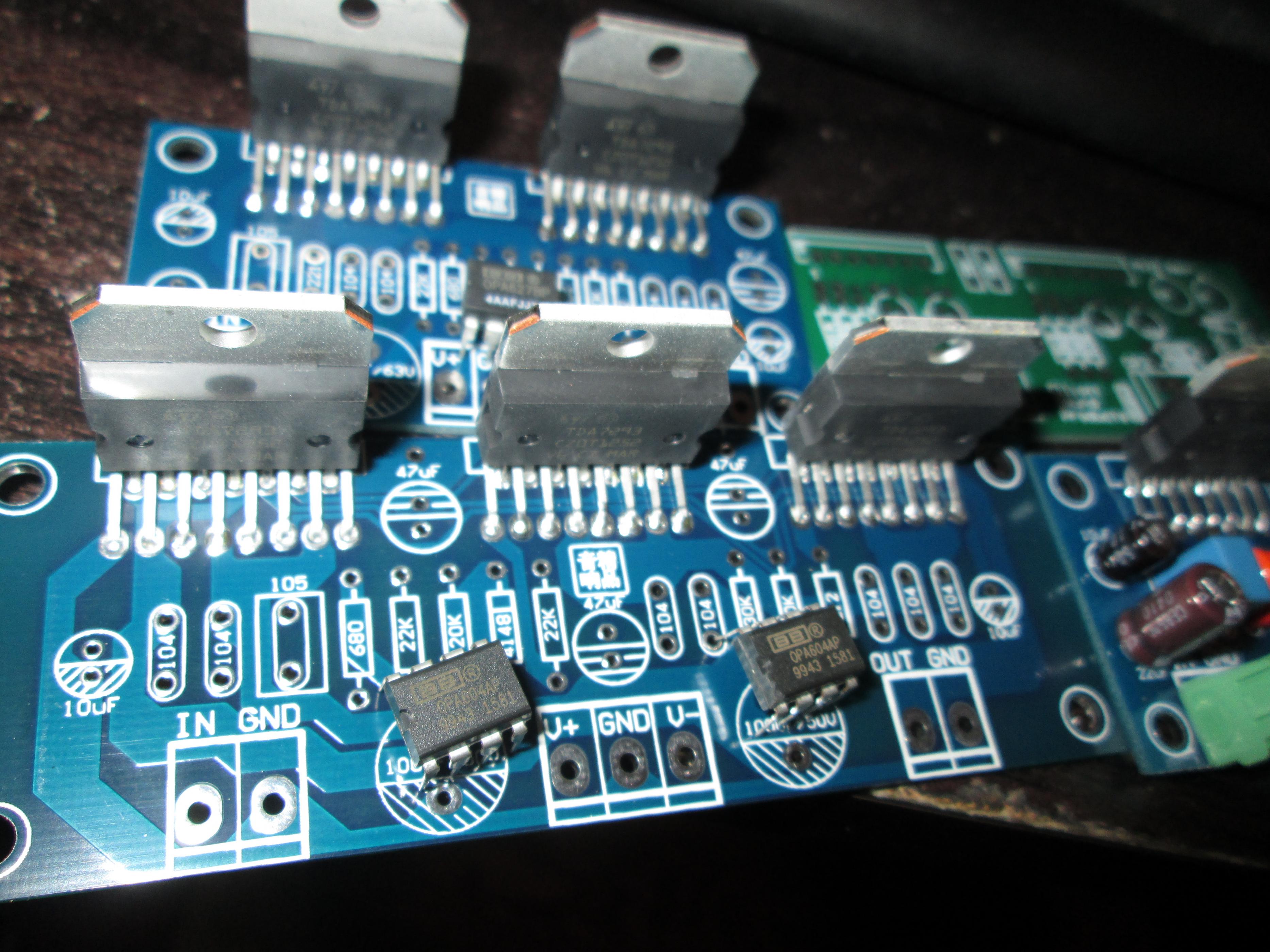

My apologies! NE5532 has not yet arrived.
The reputable JRC NJM4560 did arrive and I could employ them if you think they are compatible with this project.
There's probably no harm in trying out the 4560 instead of the the NE5532 here. Is it also a dual op-amp in a standard 8-pin package?
It's probably a bit faster than the NE5532, but the compensation scheme should take care of that - though the sonics may not be optimal. You may want to go with lower +/- Vs rails initally, and check for HF oscillations with an oscilloscope before going to 28 or 35 V rails.
NXP NE5532, 10mhz, Slew9V, unity stable
JRC NJM4560, 10mhz, Slew4V
*Pin compatible
**4560L isn't pin compatible, but rather 8 pins straight in a row, and its rated to 800mw PD although it can do 1 watt, in this larger version--I have these.

How about OPA604 & TDA7293?
![OPA604 TDA7293.jpg OPA604 TDA7293.jpg](https://www.diyaudio.com/community/data/attachments/397/397115-f1b0a979892fb6abd7190ef39c609fc4.jpg)

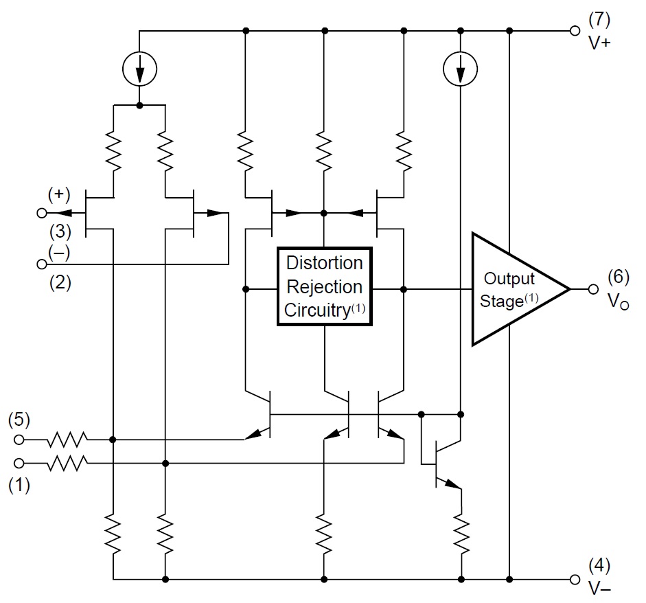

OPA604:
LOW DISTORTION: 0.0003% at 1kHz
LOW NOISE: 10nV/√Hz
HIGH SLEW RATE: 25V/μs
WIDE GAIN-BANDWIDTH: 20MHz
UNITY-GAIN STABLE
WIDE SUPPLY RANGE: VS = ±4.5 to ±24V
DRIVES 600Ω LOAD
DUAL VERSION AVAILABLE (OPA2604)
MAX +/- 25V
http://www.ti.com.cn/general/cn/docs/lit/getliterature.tsp?genericPartNumber=opa604&fileType=pdf
![OPA604 int schem.jpg OPA604 int schem.jpg](https://www.diyaudio.com/community/data/attachments/397/397155-04beb02a8c44b0db27bdab19d9d8a919.jpg)

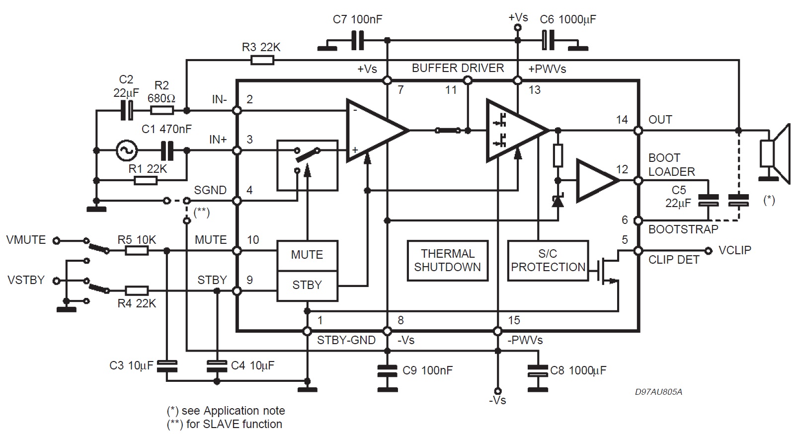

TDA7293
VERY HIGH OPERATING VOLTAGE RANGE (±50V)
DMOS POWER STAGE
HIGH OUTPUT POWER (100W @ THD = 10%, RL = 8W, VS = ±40V)
MUTING/STAND-BY FUNCTIONS
NO SWITCH ON/OFF NOISE
VERYLOW DISTORTION
VERYLOW NOISE
SHORT CIRCUIT PROTECTION
THERMAL SHUTDOWN
CLIP DETECTOR
MODULARITY (MORE DEVICES CAN BE EASILY CONNECTED IN PARALLEL TO DRIVE VERY LOW IMPEDANCES)
View attachment TDA7293-1.pdf
![TDA7293 int schem.jpg TDA7293 int schem.jpg](https://www.diyaudio.com/community/data/attachments/397/397124-a61e8a1b85100e4b5a61f61292d1502a.jpg)
Hmmm, 604 offset trim pins are ~ before / after "distortion rejection circuitry" ...
Hmmm mmmm, 7293 has separate input section and is easily 'stack-able' (better way: master and multiple slaves) for very high current to go along with its high voltage (±40V, test MAX ±50V, abs MAX ±60V) and has the buffer driver pin and boot loader / bootstrap pins

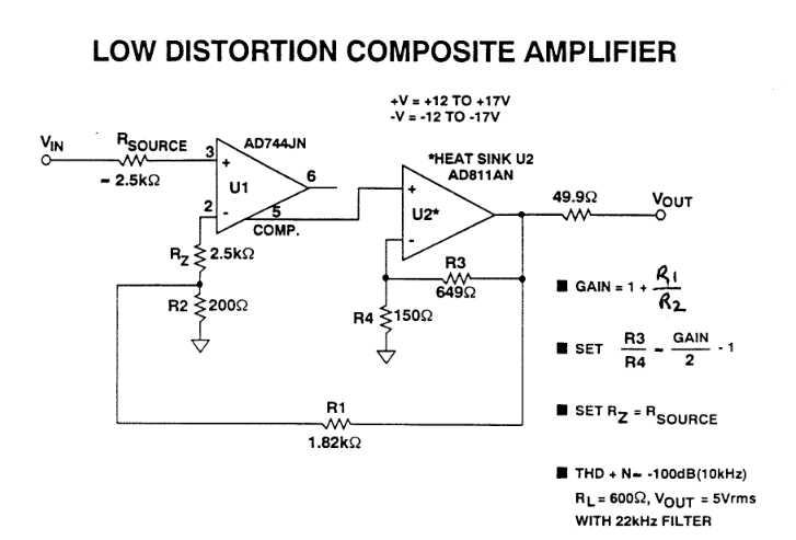

Follow Jung's rules for a composite opamp.
It should make for a very good signal and that may mean very good sound.
Interesting. How would you go about it? Same values as on the original combo?
What about DC offset? It probably needs some feedback decoupling on one or both chips.
It would be interesting to try it with an LM3886.
And it would be great if Walt was reading this and contributed some tip to go about it.
I eventually went with a Howland Current Pump as the power stage, nested within a traditional voltage-series GNFB loop, i.e. a composite amp with elements borrowed from Mauro's MyRef and Walt Jung's Composite Buffer. I did this on the hunch that it would be easier to stabilize with a transconductance amp as the power stage, and that turned out to be correct for the LM1875 (the key idea to stabilize it is a single small-valued cap or RC between the junction of Rz-R2, and the non-inverting input of the current-pump - which turns out to be an improved variant of the DeBoo integrator). The LM3886 in a nearly identical circuit turned out to be harder to stabilize, but I succeeded after borrowing ideas from the MyRef Rev C.
I looked at the TDA729x, but it had several issues:
1) It is reported to be finicky about power sequencing - it's been known to latch-up on occasion.
2) It requires a bootstrap cap, and I wasn't sure of the effect of the bootstrap (or lack of it) in a Howland Current Pump.
3) It doesn't have an official Spice model to help model stuff like 1) and 2) above.
So I stayed with the known LM1875 and LM3886, with no regrets.
Thanks for posting the heads-up about TDA729x, because I was just starting work on a TDA7293 version. Food for thought about perhaps stick with what I know will work.
The TDA729x family may well work fine, it's just that I had some dead knowledge zones with it. It's entirely possible that those who're familiar with it will find it easy to use in a nested topology.
The TDA7293 will probably behave very nicely if when using TDA7293 specific bootstrap hookup. At higher voltage, it turns out to be a pleasant tone rock the house classic mid-fi, with actually very good clarity and durability. They're also easily paralleled with only one voltage amp active, which is a great simplicity and intensely powerful.
The TDA7294 may behave if used at voltages typical for TDA7296/LM1875. Conveniently, in undervolted condition, TDA7294 supports slightly lower gain, at much benefit to imaging. Scaled even smaller than the LM1875, the TDA7294 can make a very high fidelity low wattage amplifier.
The majority of the trouble with TDA7293/4/5/6 ends if the power decoupling caps are 220u although parallel 220u (440u) may be used for more punchy bass. It is somewhat helpful if the bootstrap cap is 33u rather than 22u. It is rather extremely helpful if the nfb-shunt-cap (in- coupler) is sized up much larger, such as 220u with 2k7 for that RC. Also, the optimal gain factor and feedback current do both depend on the power voltage chosen. For TDA7294, the input cap (in+ coupler) should be 1uF or smaller. For TDA7293, the input cap (in+ coupler) can be whatever size you like (if when using TDA7293 specific bootstrap hookup).
Generally, the standby circuit is hooked up per the datasheet.
However, the mute circuit can be powered through only one part--a simple 10k resistor will do it reliably (no extra resistor, no extra diode, no extra cap needed).
I think that the easiest way to use TDA7293 as a nested amplifier is to use it in slave mode, driven by whatever you like for voltage amp, such as a natsemi driver chip.
