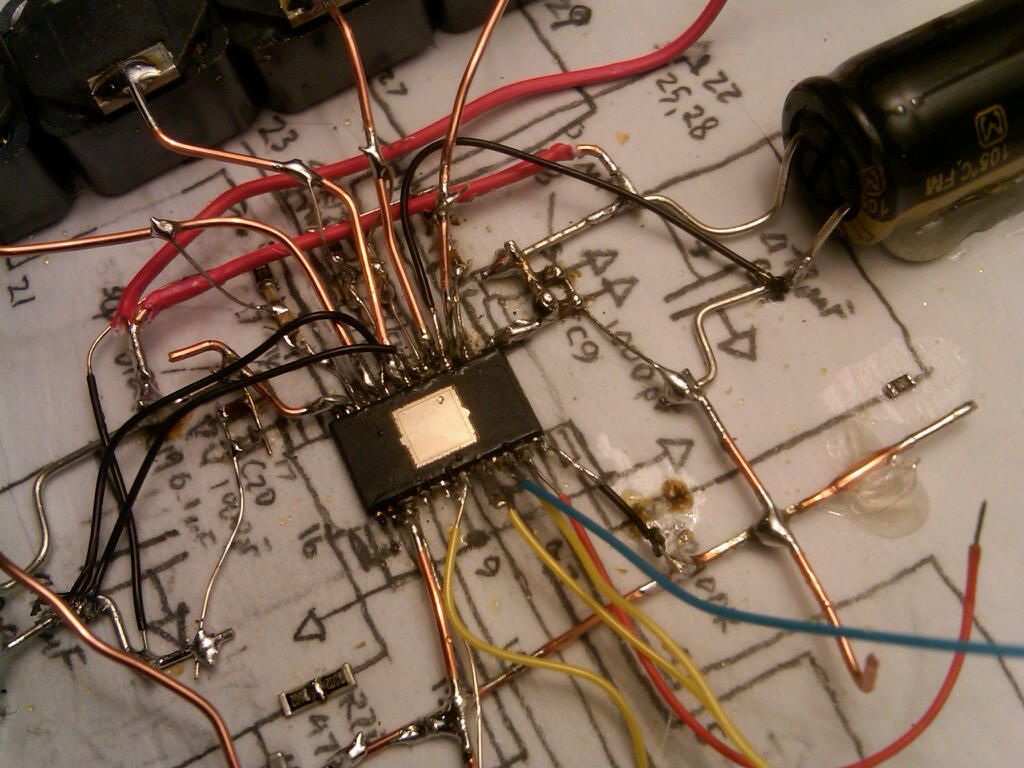

Here is a Macgyver style class D TPA3118D2 chip amp with p-t-p wiring using SMT components. This was before cheap Chinese TPA boards were available. I never measured THD but it sounds good - almost as good as a PCB board probably. There is a layer of grounded aluminum foil glued under the white paper for a ground plane.
That was fun, sort of...![]()
Words fail me. That is an epically awesome P2P build. You clearly have more patience than I do. It would be interesting to "sniff" around that amp with an inductive pickup probe on a spectrum analyzer.
No, just the opposite, the best engineer I know can't solder half that well.
Thanks. I've been at it for a while. I've been soldering longer than I've been able to write. Got my first own soldering iron when I was in first grade because my dad was tired of me always using his soldering iron. Not that he ever used it, but whatever...
OK, I guess I missed the sarcasm. Sometimes it's hard to sort out the snark from the insults. Apologies for misunderstanding the intent.
Mike
Thanks.
It was one of the personal "challenges" I imposed on myself. Good binocular magnifers and high quality tweezers are mandatory. However, at the time, I did it with an 0.035in tip iron. Probably would have been much easier with an 0.015in tip iron. Or I should have just bought one of these breakout boards:

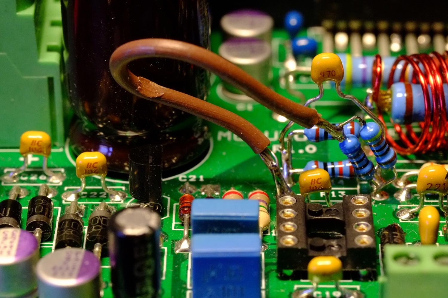

Sorry about waking a old thread...Here's the wire in question. I'll let the pros calculate the inductance of it to greater precision than my back-of-envelope estimate of 60 nH should they be so inclined.

About the measured differences with the wire loop:
Parasitic inductive coupling? From output section half-wave conduction and crossover current spikes travelling along power lines injected into this small loop. Small, but not for 0,000x% distortion....
If I not missed something...
A possibility to study.
Not inductive coupling, actually. Just the rise in impedance vs frequency caused by the added lead inductance.

In case you are wondering about the impact of lead inductance in the feedback network, attached are some measurements.
The bottom trace shows the THD+N vs Frequency of my Modulus-86 R2.0 amplifier.
The middle trace shows the impact of the lead inductance of a capacitor in series with the feedback resistor to ground. The capacitor was mounted to the PCB Macgyver style with rather long leads.
The top trace shows the impact of 60 mm (~2.25") of AWG20 wire in series with the feedback resistor to ground. 60 mm of wire has an inductance of approx. 60 nH.
The measurement was done at 35 W output power into 8 Ω using 60 kHz measurement bandwidth on my Audio Precision APx525.
It is very clear that in a precision circuit, the layout matters. Even 60 nH is enough to degrade the THD by 10 dB at 20 kHz.
