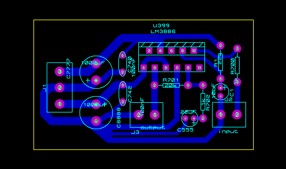

Hi guys,
Thanks for all inputs.
Regarding the optional components actually I want to makes a prototype based upon the schematic in the datasheet and then I will improve it and add the optional components just if needed.
I have made the circuit directly based upon the schematic in the datsheet before (all components were connected to gather without any pcb) and it worked fine for me.
Ok I tried to modify the PCB as you noted. Plz kindly take a look at the new pcb and let me know your ideas.
Thanks a bunch
Thanks a bunch
Andrew,
Thanks a bunch for your reply,
Sorry What do you mean by that plz? PIN9 is completely seperated from PIN10 so what do you mean by loop area here?
What is interference upsetting?
Yet I do not know what do you mean by loop area here so I do not know how to solve the problem.
The loop area for PIN9 to PIN10 is enormous.
Expect trouble due to interference upsetting the unstabilised amplifier.
The loop area for PINs 4 & 5 via the two decoupling caps is even more enormous.
Are you aware that an aerial that picks up interference is a loop?
Now start at PIN9 and follow the traces and components: to R701, to R702, through R702, to C555, through C555, to star ground, to Input PIN1, to PIN2, to R700, through R700, to PIN10.
Now shade in the area enclosed within that route.
That is your loop area. That is your aerial picking up interference.
You must make that group of components and traces and pins as small and as compact as possible and try to minimise the loop area.
Repeat for the output.
Repeat for the Zobel.
Repeat for the PSU rails.
