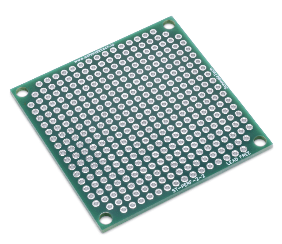

thanks tom my only issue with the 3886 is the cost and that i would need two of them and i sadly cant apply for the ti sample program becuse im not a member of any company or university but i think i might try to ask someone and stuff
PA150 boards (3 x LM3886 each) on offer in diyAudio Swap Meet may work for you. The Modulus-86 is more expensive, yes, but is absolutely worth it.
You could build an LM3886 point-to-point (or on prototype board) for $30. AC Test Circuit #2 in the LM3886 data sheet is a good starting point.

why though? i usually get way to lost with perf boards. is there anything wrong with these pcbs?

You wanted a cheap DIY project, no?why though? i usually get way to lost with perf boards.
