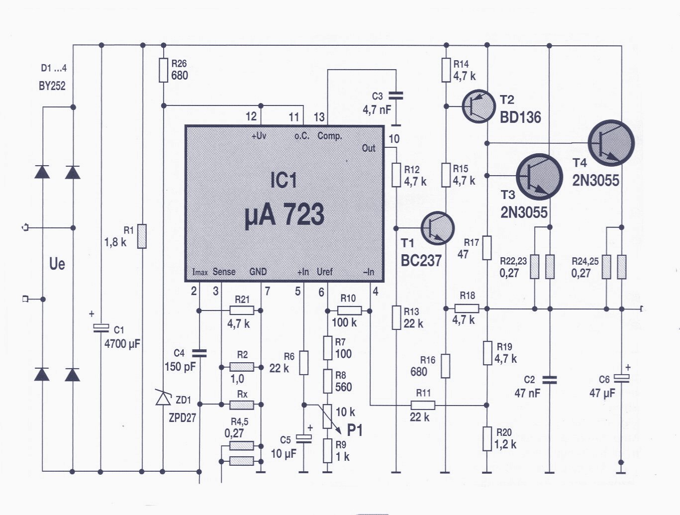

WSJ: I just ran through the 3 links You postet in #21. I am overwhelmed. It is right what we need to start this project properly. Is anybody of us tough, making drawing? I can only use Paint, and it takes hell of a time. My first propersition: I will use 6 type 2N3773 series pass transistors, to spread the heat on several heatzinks, and give each pass transistor an emitter resistor of 1 Ohm, to be sure to share the current equal between all pass transistors. Next I would use a PNP transistor as the driver for the pass transistors, because instead of pushing further high to the base of a darlington coupled transistors, I am pulling the base of the driver downwards, when I want the output voltage to go higher. Any objections? Soeren Poulsen
WSJ: I need You to think this through: Take the "old faithfull uA723" look at the ordinary applications, where they make feed-back to the - input, and a variable voltage to the + input. Change that to: + input at constant +5 Volt from the reference voltage. A feed-back resistor of 10 KOhm from output back to - input. A 2 KOhm resistor from -input to a pot wiper, bottom pot to 0 Volt, top pot to 6 Volt from the reference voltage. Comments please
this one gets closer to Soeren's plan but cant quite go to zero V

Hello Infinia. Your circuit looks great, but it has problems. The + and the - input pins of the uA723 does not like to come below around 2,5 Volt dc. That is why the most of the circuits using the uA723 can not go down to 0 Volt dc. My idea is to have both inputs at 5 Volt dc constantly, and by using the inputs, which is to be regarded as the inputs on an op-amp, in the inverting mode, that is acheeved.
WSJ: I have ExpressPCB on my old PC. It is great!
I just saw the reason why Infenia's circuit can go down to 0 Volt! It is because of R10 / 100 KOhm!

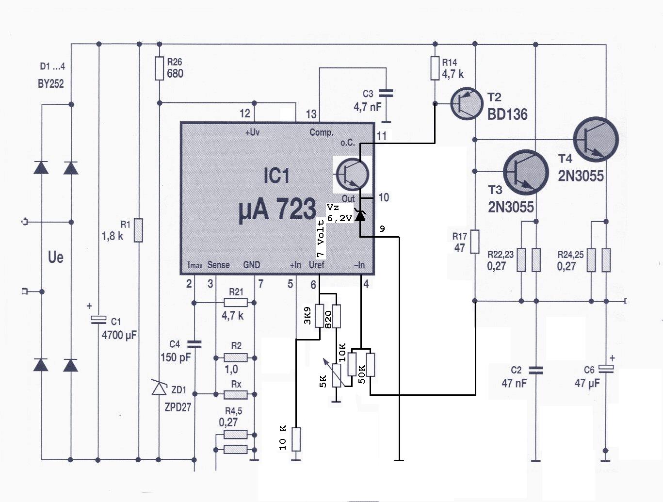

Hello jimmiegin. Well, You can not run away now! You caused the start of this thread! Did You get my private post? WST and Infenia: I have tried to make my idea of the circuit, modyfieng Infenias schematic. Comments appreciated. Soeren Poulsen

Do you see a problem with the voltage on pin 11?
What is the max raw DC voltage at high line and no load?
