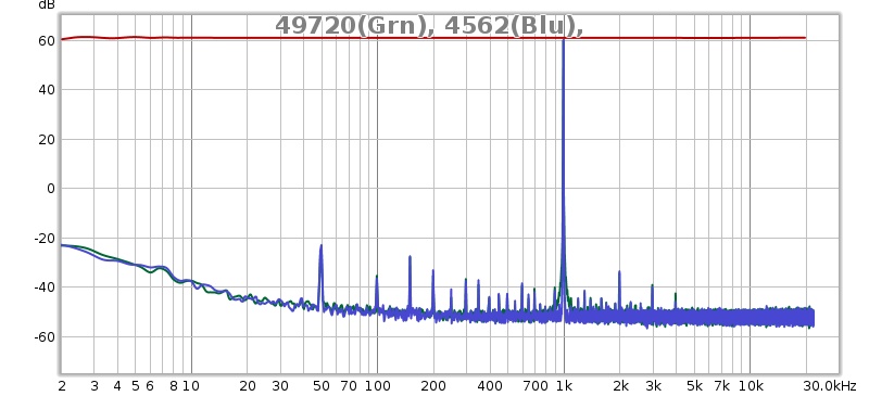

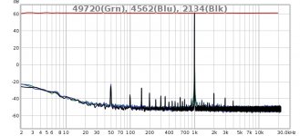

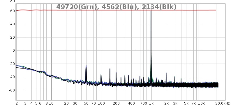

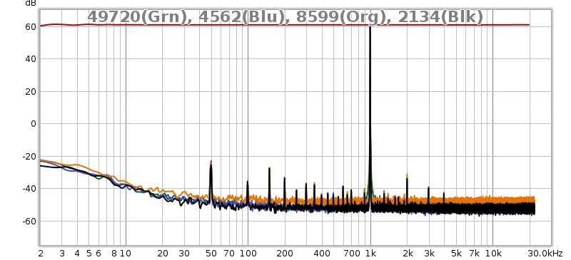

This thread has been very interesting, but what are the real differences between these opamps? Are there actually any differences in spite of the datasheet similarities?
So, I decided to find out.
I had a Rotel RA-930AX at hand which I had recently upgraded, reduced the opamp supplies to +/-16.4Vdc and then sequentially put in the dual audio opamps which I happened to have in my inventory into its preamp stage socket: Total amp DC offset and THD
LME49720 (TO-99, Green trace) -1.8/-5.8 mV 0.0026%
LM4562 (DIP, Blue trace) -1,2/+2.3 mV 0.0026%
OPA2134 (DIP, Black trace) +2.4/+0.8 mV 0.0025%
AD8599 (SOIC, Orange trace) +12.9/+8.7 mV 0.0032%
All were left to fully warm up and then I measured the total amp output DC offset, the 1kHz THD by doing a RTA and the opamps' running temperatures.
I also measured the SPL (gain) linearity, and as expected that was straight as a whistle from 2Hz and up for each and all these opamps (Red trace). I didn't measure the upper frequency limits.
Note that all measurements are taken at the output of the entire amp, so this is an actual measure of what to expect if you should decide to change an internal opamp in your amp to something "better". And no, I didn't perform any subjective listening tests to judge the perceived sound quality, so sorry, I can't provide any qualified audiophile journalistic waffle.
Ok, I know the dc offset is a result of each opamp chip's final laser trim and can/will vary. But I guess that it is the overall level that is of interest. Note that the preamp has been direct (DC) coupled to the power stage, ie. no capacitors in the audio path.
The first thing that can be noticed is that there is absolutely no detectable difference between the LME49720 and the LM4562 traces, so the claim that they are identical chips are most probably true.
The OPA2134 is only very marginally better, whereas the AD8599 has a higher noise floor, offset and THD, although not by much. All would probably do absolutely fine in this application - at least from a strict measurement standpoint.
The opamp running temperatures were in the region of 50-55 oC - except the TO-99 metal can which was significantly higher, probably over 70 oC. I burnt my fingertips when removing the can after power down. That could be a closer representation of what the actual inside chip temperature was?
