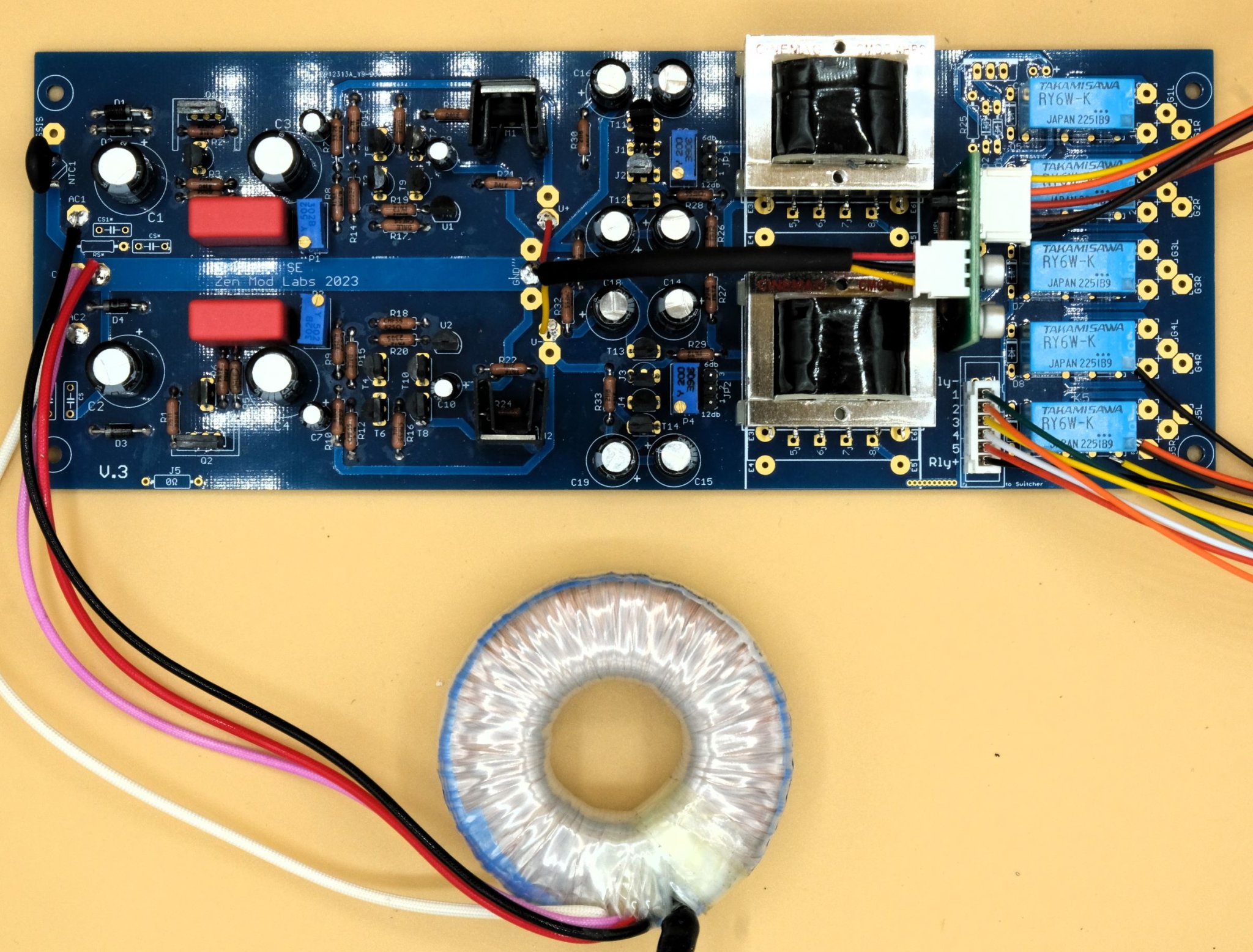

When going for Franks iron pre volume and control with the nice Mean Well 5v supply, it seems that one should have just enough power for relays cpu and display? Looking at placing an order to mouser for the IP bom and adding RY5 W-K relays in this case.

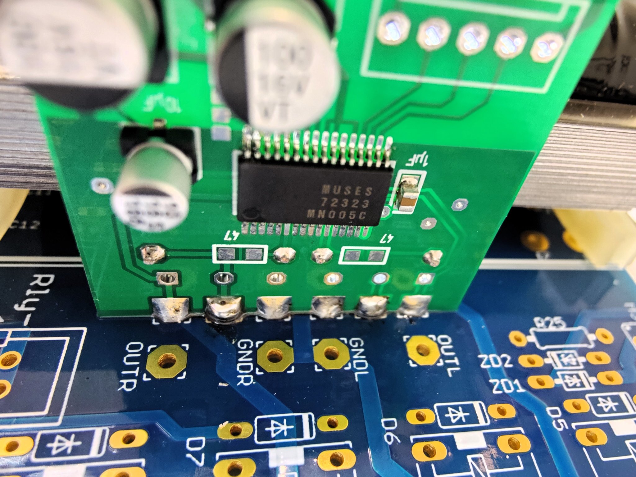

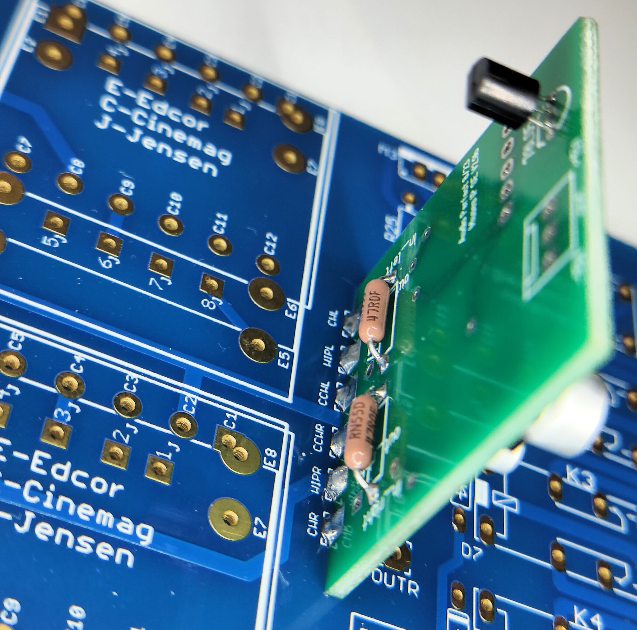

One first prototyp:
The solution with the castellated boards is really strongly. The board holds as if it was screwed down.Attachments
The Balanced solution is also under construction and almost ready.
Unfortunately, I was missing a chip for the port extension. That's why I couldn't finish the MC-board yet. This will be delivered next week. Then it will go into real operation. I am very curious about the sound myself.

Looking at the Muses datasheet, I see opamps on the outputs of the Muses chip. Are opamps not necessary when using a Muses solution with the IP? Put differently; Can the various available Muses boards (F Wilker, Meldano, HiFiOcean, etc.) be connected directly to the IP inputs without needing opamps? Iow, are the Muses output signals strong enough to be used by the IP?
And finally, are there any happy users of Muses coupled to IronPre out there, or is Muses attenuation + IP still experimental?
