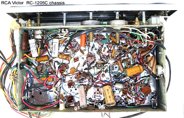

All those old handmade chassis look like someone barfed a stomach full of components into the chassis at random, though I'm sure there were detailed assembly drawings...
Actually, those hand-wired chassis from the tube era 50's/60's were carefully thought-out, and the components were arranged specifically for excellent operation and reliability.All those old handmade chassis look like someone barfed a stomach full of components into the chassis at random, though I'm sure there were detailed assembly drawings...
It might look like a mess, but trust me, those buggers lasted, and still perform quite well once the old wax caps and out-of-tolerence resistors are changed.
My 1963 RCA Victor console stereo sounds tremendous today, even though it was a pain to service.
The preamp/tuner chassis is pictured here....
Tough - it still looks like an absolute mess, scripted or not. I'm out of here - you can say what you like, but I won't be hearing it.
And that, ^ people, is a classic example of a narrow-minded biased mind.
Someone who judges something they obviously don't have a clue about, yet concludes their opinion based on appearance.
