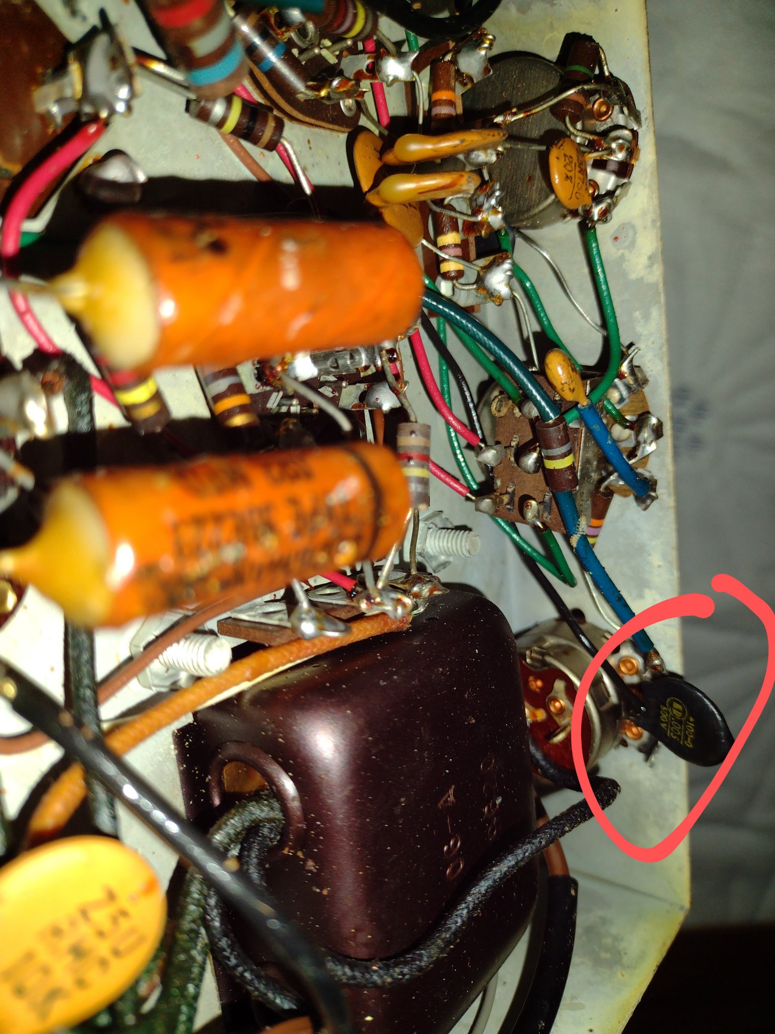

You're right, a capacitor connected straight across the mains should be replaced with an X capacitor.I would agree that safety capacitors (x and y) applications should be replaced.
And while talking safety, replace the power cord with one that has a polarized molded plug. An inexpensive extension cord with the female end cut off is a great option. Another item for safety is adding a fuse to the hot side of the line supply.
And any times, the NEUTRAL side of the line cord is wired to the power switch on older equipment.And while talking safety, replace the power cord with one that has a polarized molded plug. An inexpensive extension cord with the female end cut off is a great option. Another item for safety is adding a fuse to the hot side of the line supply.
That leaves the chassis HOT, even when turned off.
Re-wiring to break the HOT side is needed for proper safety and code reasons.

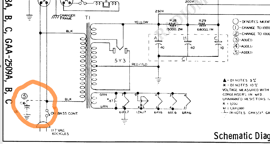

Thank you guys for chipping in here. I think PotentiallyIncorrect may have it, the amplifier looks to be later or differing 6 tube 6BE6 SE output closely matching the GAA-2509C. Still haven't quite got the exact model number, but I think the GAA-2509C schematic is going to be my starting point for research.
The Tube Location Guide, was still glued to the inside of the cabinet, and matches the amplifier inside. Can Cap is going, Filter Cap is going and old wax paper caps have orange drop replacements on order, and should be here within the week. I've been researching and the polarized two-prong , or even the grounded plug end are possibilities, as I plan on adding a bluetooth receiver to the existing AUX or TAPE input path, adding a nice touch of modern functionality that can easily be removed to return this to "original" state if need be. I've seen other builds similar to mine. GUITAROLOGIST on YouTube has a VERY close model, that he refurbished, record player included.

Thanks to PotentiallyIncorrect, I was able to locate the danger cap, looks to be a 0.05 uF 600V Black Ceramic Disc Cap. with no safety rating. Looks like I'll be replacing with a 0.047 uF Y2 rated safety cap along with a 2A inline fuse to the HOT line of my new polarized cord, or 3-prong with ground wire capped, should complete my safety requirements while keeping RF/EM noise reduction, correct?
