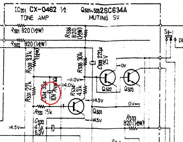

This amplifier has a Normal / Separate switch on the back for disconnecting pre-amp and power amp. I just now tried turning the amp on with the switch in Separate position and no noise. Back in Normal position, the noise occurs. To me that suggests the noise is caused not within the power amplifier section but before.

Since my last post, my attention was directed to some transistors involved in the mute circuit - Q501/502/503. According to the service manual, those arre 2SC634A's.
That was the transistor I found in position Q501 but it had black legs. A past encounter with simarly afflicted 2SC458's prompted me to replace it. I used a 2SC1815. That did nothing to correct the problem so I looked at Q502 & 503. Neither of those had the 2SC634A's which were supposed to be there and one of those I removed tested bad.
I have since replaced all three, Q501/502/503 with 2SC1845's. That has now caused the turn on noise to manifest on the left channel only but has somehow created minus 0.72V DC on the right channel pre-amp outputs.
My next task will be examining orientation of the three transistors I just replaced. I copied what was on the board but it was suggested that whoever preformed previous transistor replacement got it wrong.
It turned out that whoever worked on this amp in the past did put Q503 in backwards and I put in new transistors the same way.
The icons on the board were distorted so I can understand why someone could make that mistake. But I spotted the letter "E" next to one hole and realized it was in wrong.
Even though I only installed it yesterday, I pulled that transistor and put another new one in its place - correctly.
The problems I was experiencing with this amp seem to be gone now.
