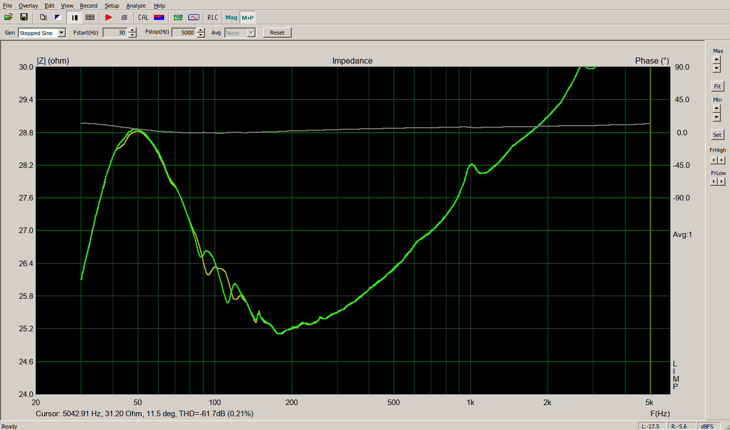

Maybe this suggests an explanation? I measured the impedance of the speaker, once in the corner of the room, and then placed it towards the middle of the room.Now why could that be? I've also encountered a phenomenon where, after adding 10 ohm series resistance to an 8 ohm woofer, a 40Hz notch filter for a prominent 'room' (?) mode had to be dialed down to use less attenuation and lower Q. (The exact opposite of what conventional 'wisdom' would suggest ought to happen, especially as it often fails to test to see if reality matches the theory.)
No explanation that I can come up with makes complete sense without considering a possibility the usual T/S based models are borderline broken if the room isn't taken into account.
It seems like the 'overshoot' that (nearly) everyone is always so worried about when Q goes above 0.707 is easily swamped by ringing echoes, but if the speaker Q is raised it could act as an active bass trap. But for that to make sense, there should be some significant loading effects that pressurise the speaker from the outside.
