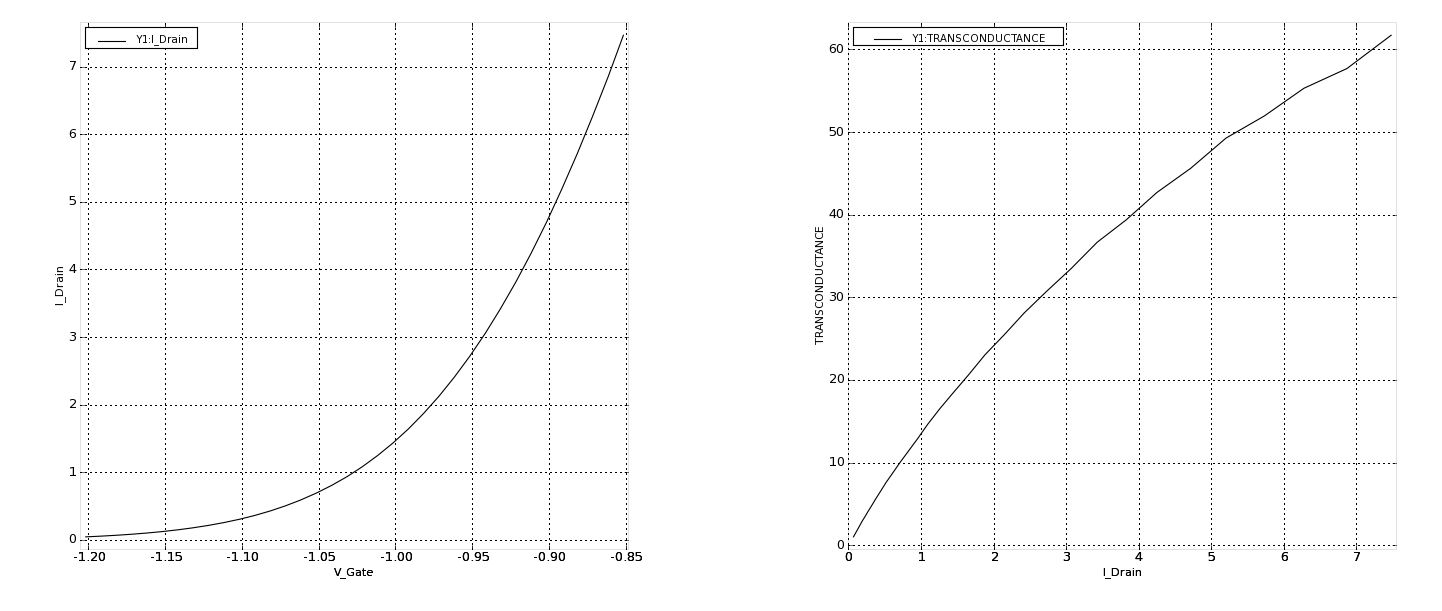

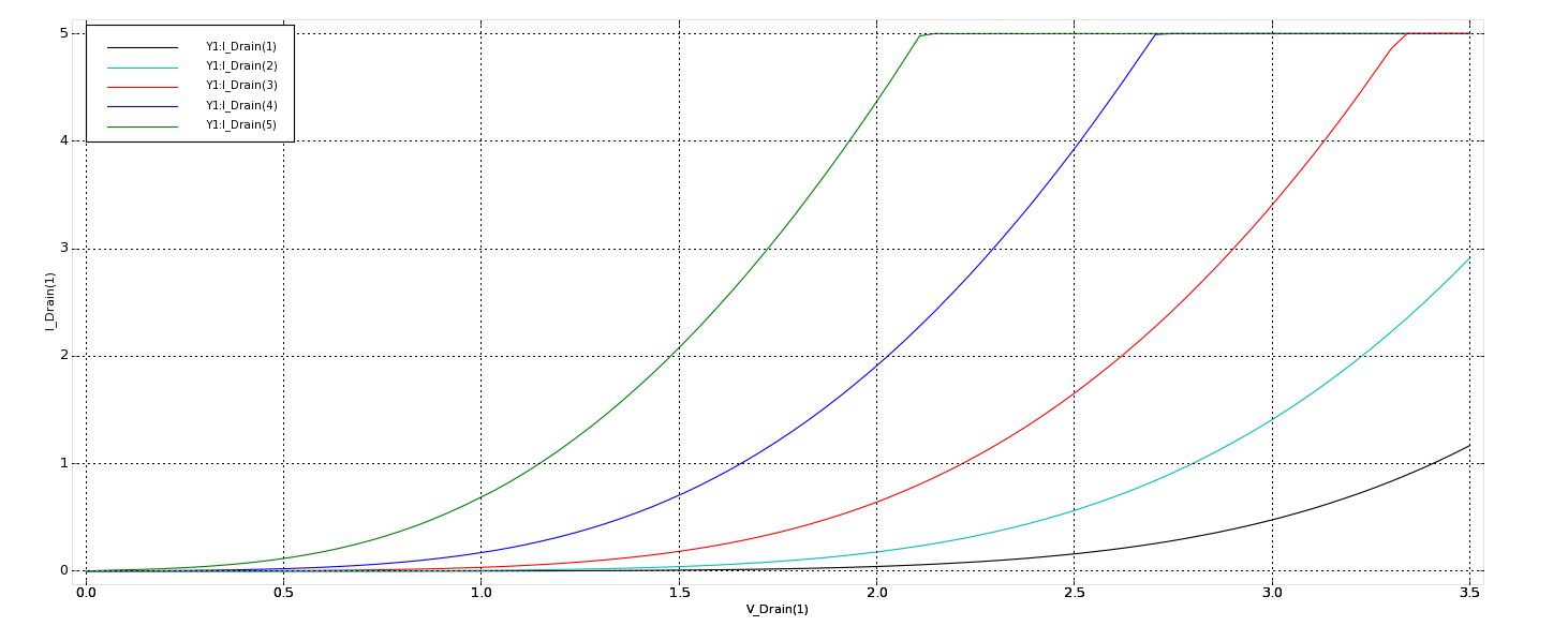

Decided on final curve tracer configuration. 6V, 3A capability. sub milli-volt resolution.
The LU1014D datasheet has Vth (Vpinch) defined as the voltage where Ids is 250 uA at Vds = 0.1v. I will be using Vds = 2.4v which is the Vds in the First Watt F3.
Vgs is the voltage where Ids is 1.5A which is the bias current of the First Watt F3 amplifier.
I have written a script that automatically characterizes Vpinch followed by Vgs. Repeatability is ~ 2mV.
My sample device from my stash has Vpinch = -1.460v and Vgs = -0.904v.
Transconductance is not as repeatable as Vpinch and Vgs as transconductance is the slope of the line tangent to the bias point on the Vgs-Id curve.
How closely pairs will match will depend on the distribution of the parameters in the population of devices.

Started characterizing my stash of LU1014D. There are a decent percentage that will make matched pairs.
The spread of Vgs so far is -0.6 to -1.2. The value of source resistor to use for an F3 is approximately Vgs / 1.5. This is a room temperature calculation. At operating temp, an adjustment will likely have to be made.
