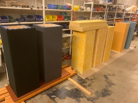

here is some of my traps in building stage
may i ask what size your asc tube traps are? when looking att absorption coefficient charts for tube traps they do look much like what could be expected by plain porous absorbers of similar size, but asc traps has those reflectors and absorption curves goes down again at higher frequencies, so their traps looks to have a huge boost of effiency at bass frequencies. art noxon writes here that their tubes are much more efficent then a ball of fuzz https://www.acousticsciences.com/artblog/basstrap-sound-off-fuzzballs-vs-tubetraps/

just to be clear, tube traps are not sonotubes. sonotubes are tubes made out of hard pressed paper that is often used as concrete forms.
tube traps are made of glass wool pipe insulation, i find it to be quite smart to use these. these premade pipe form structure is quite robust and they have an decorative apperience too.

my diy tower traps works exactly like your original tube traps, or that was my intention anyway, https://www.acousticsciences.com/product/towertrap/Celef, what kind of traps are those that you built? I found these traps while searching bass resonator traps ...

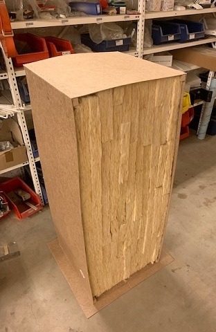

i tried at first to get the correct tube insulation wraps but it was just not possible, it is easy to get small dimension pipe insulation but the huge ones used for bass traps where for me impossible, so i built my tube traps square, and asc calls their square tube traps for tower traps so i call mine for tower traps too, but with a diy prefix 🙂
Fence forced into cylindrical shape could work as frame, then with 1,2m length for standard tile you could do up to 35cm radius i think.

those sheets of glass wool used in traps like these are very difficult to bend, they are quite hard or stiff so if you try to make a curve out of them they will collapse and the sheet foldsFence forced into cylindrical shape could work as frame, then with 1,2m length for standard tile you could do up to 35cm radius i think.

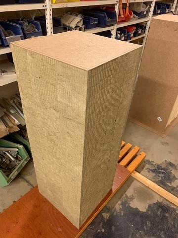

yes i think i need to aim for the stage 3 config, but i also need to build bigger traps, i guess that if i go for 60x60cm square size, that would give a whopping 80cm diagonally, i could cure some of the 50 hz peaks, i wish and i hope 🙂I think they do, but what they don't tell is that Config 3 is the minimum ( in my view and from my experience with porous absorbers).

when dealing with porous absorbers there seems to be some rules to follow, one can either choose to use a thin wall absorber with a large airspace behind it, in this way you must use a high density mineral wool with a high air flow resistance. the opposite to thin wall absorber is the super chunk and these use a low density mineral wool with a low air flow resistance, and this absorbers are very thick with no airspace.Ha ok you used some compressed sheets!

what i am trying to say is that the thinner fibrous sheet you use (with an airspace behind it or not) the higher air flow resistivity it needs to be, on the other side, the thicker sheet you use the lower air flow resistivity it needs to be. the 1/4 wavelength rule is a safe recommendation, but mineral wools seems to be effective already at 1/8 wavelengthsI agree there is rules.
