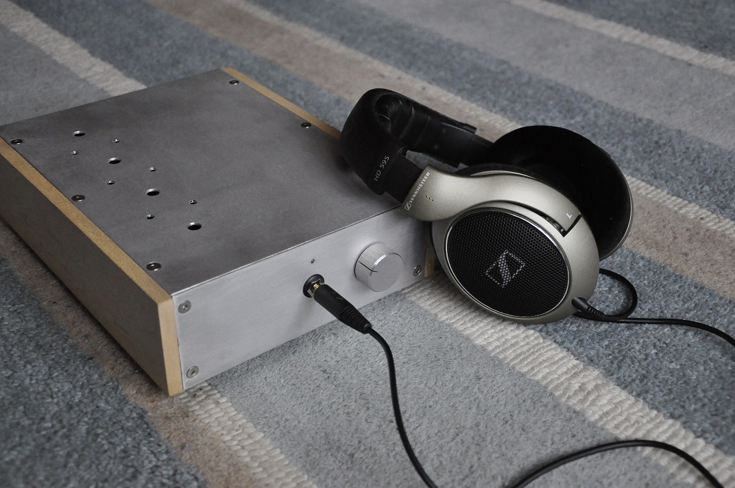

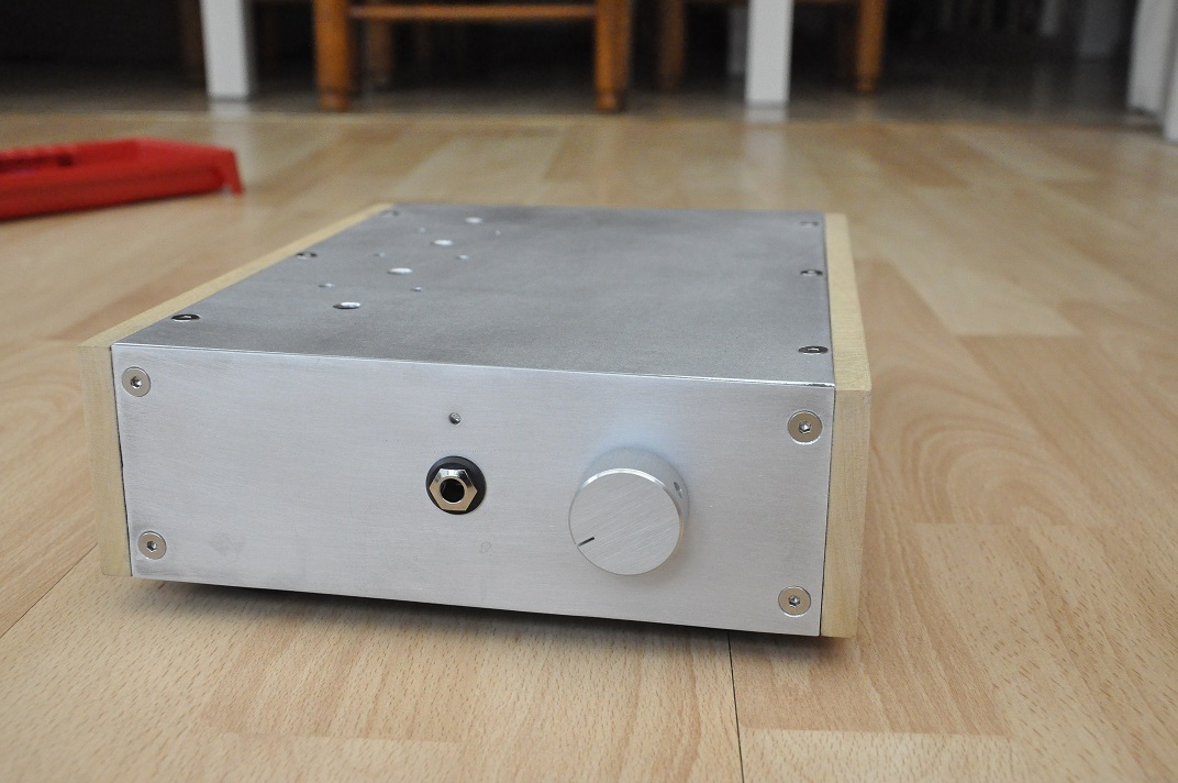

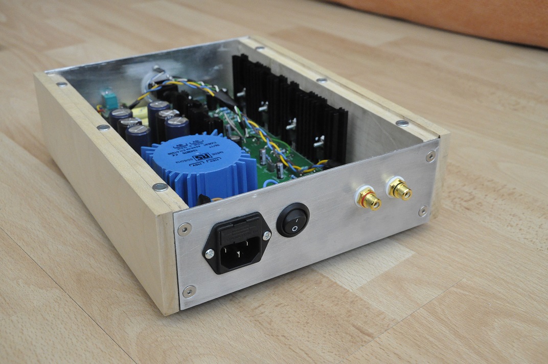

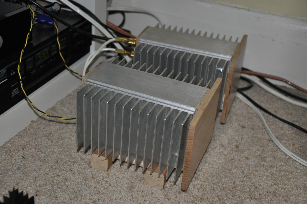

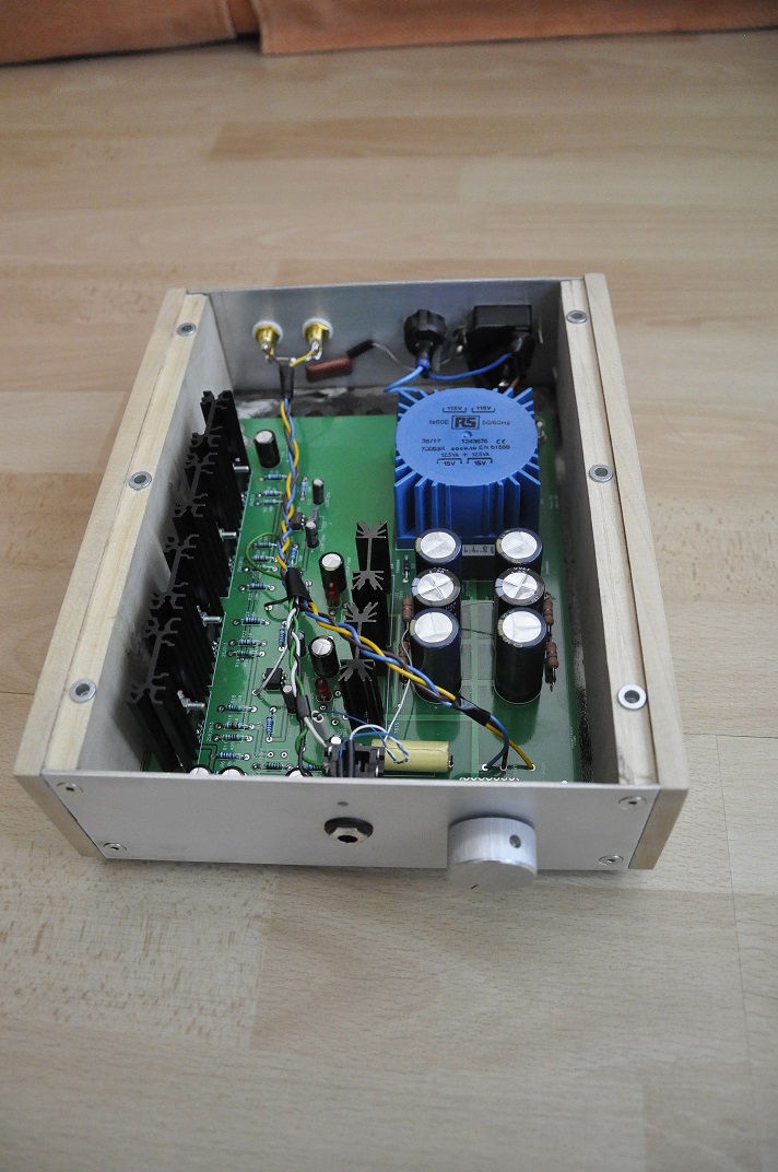

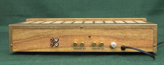

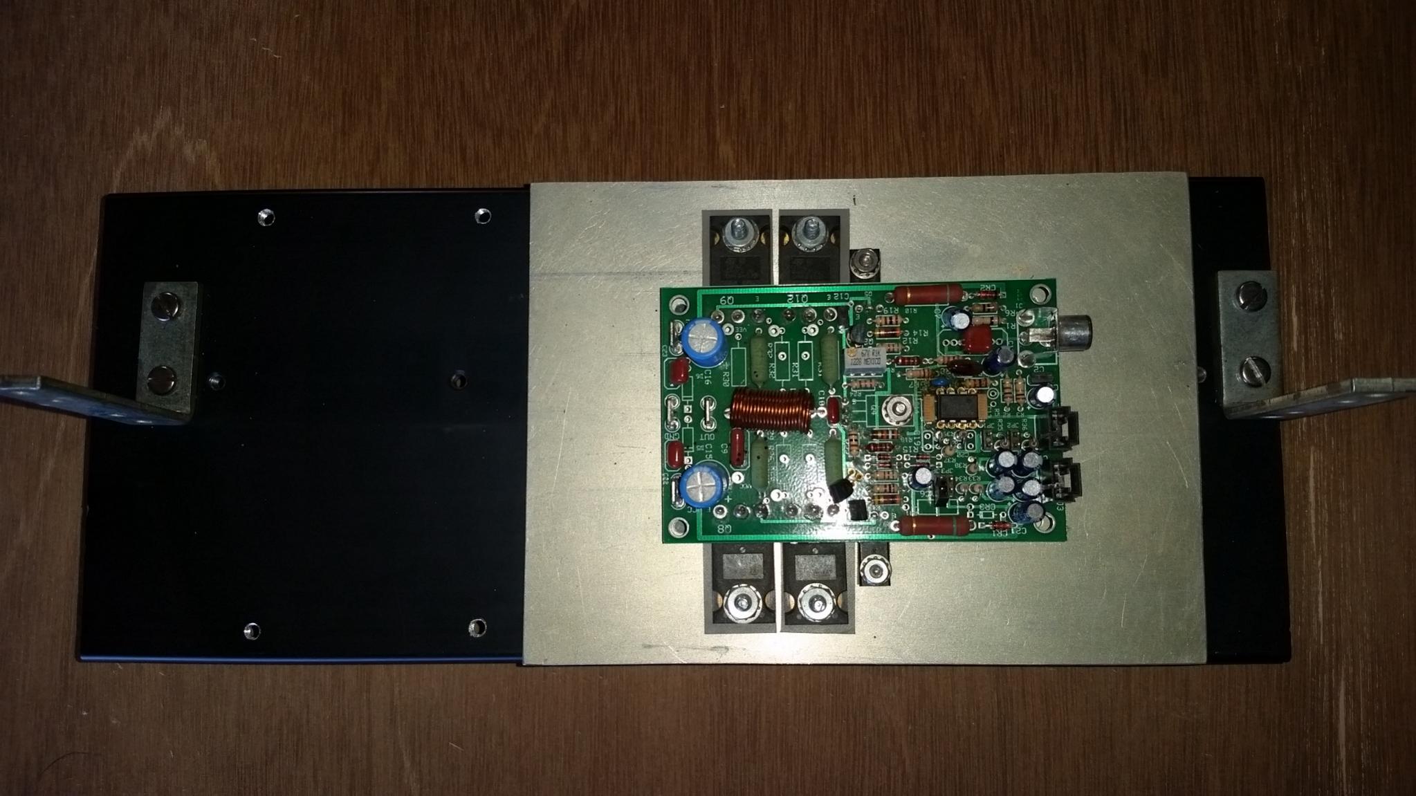

These are my Whammy HPA, Pass ACA monoblocks and Pass Mini Aleph (all shown in other threads). Pretty low cost.

Nice ideas - wood with aluminum plates added?These are my Whammy HPA, Pass ACA monoblocks and Pass Mini Aleph (all shown in other threads). Pretty low cost.

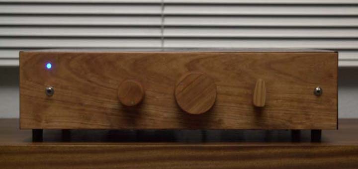

You used threaded inserts into the wood?
Are those glued in or 'screw-in'?

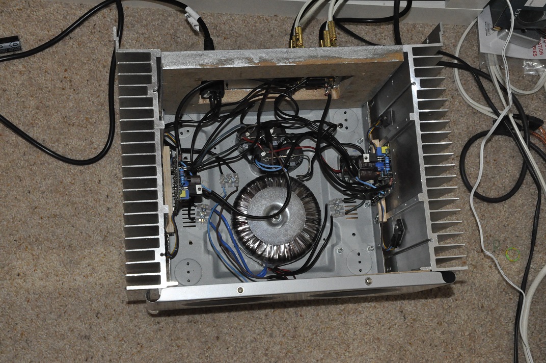

You are lucky if you can still find 'junk' equipment. In my area, things go straight to the 'electronics recycling' where scavenging is unfortunately not allowed.

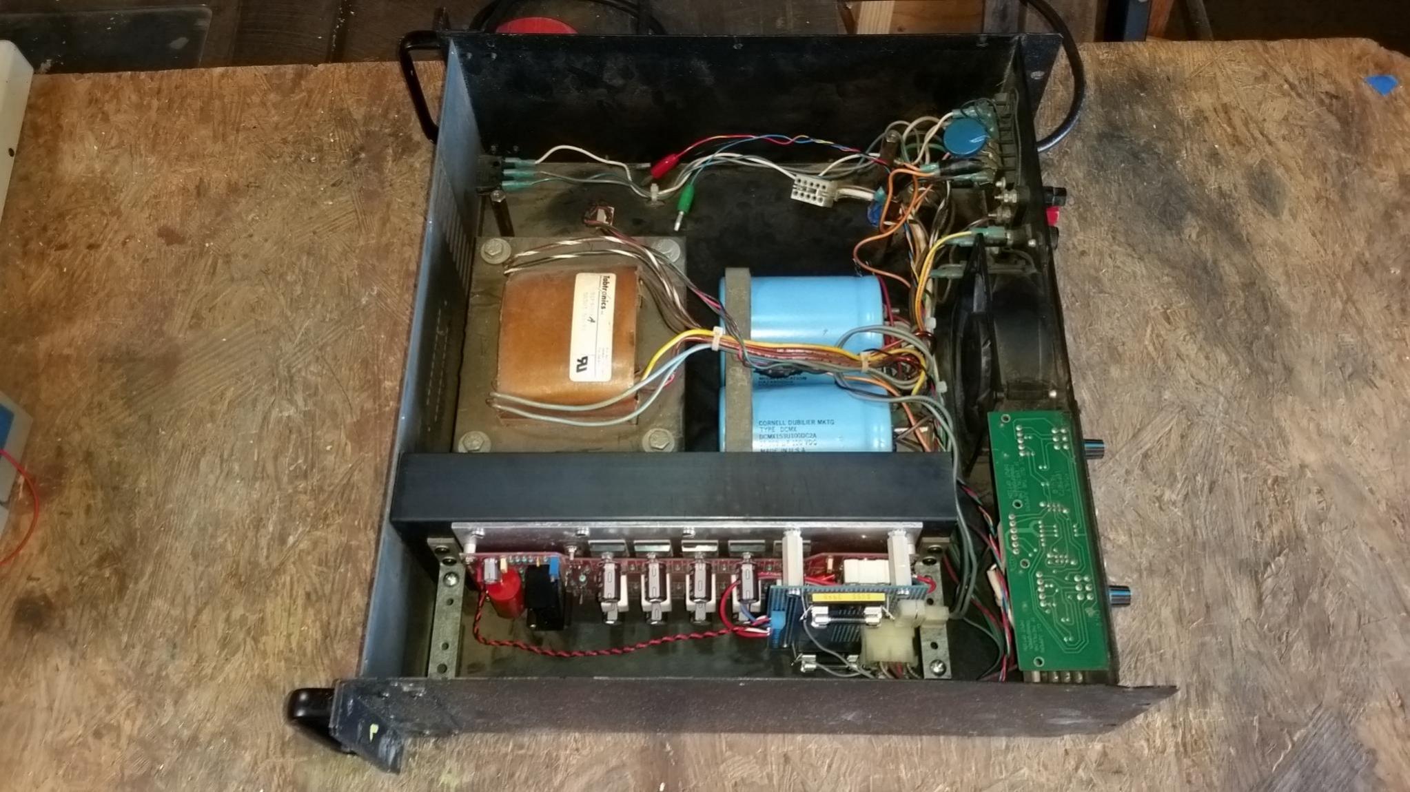

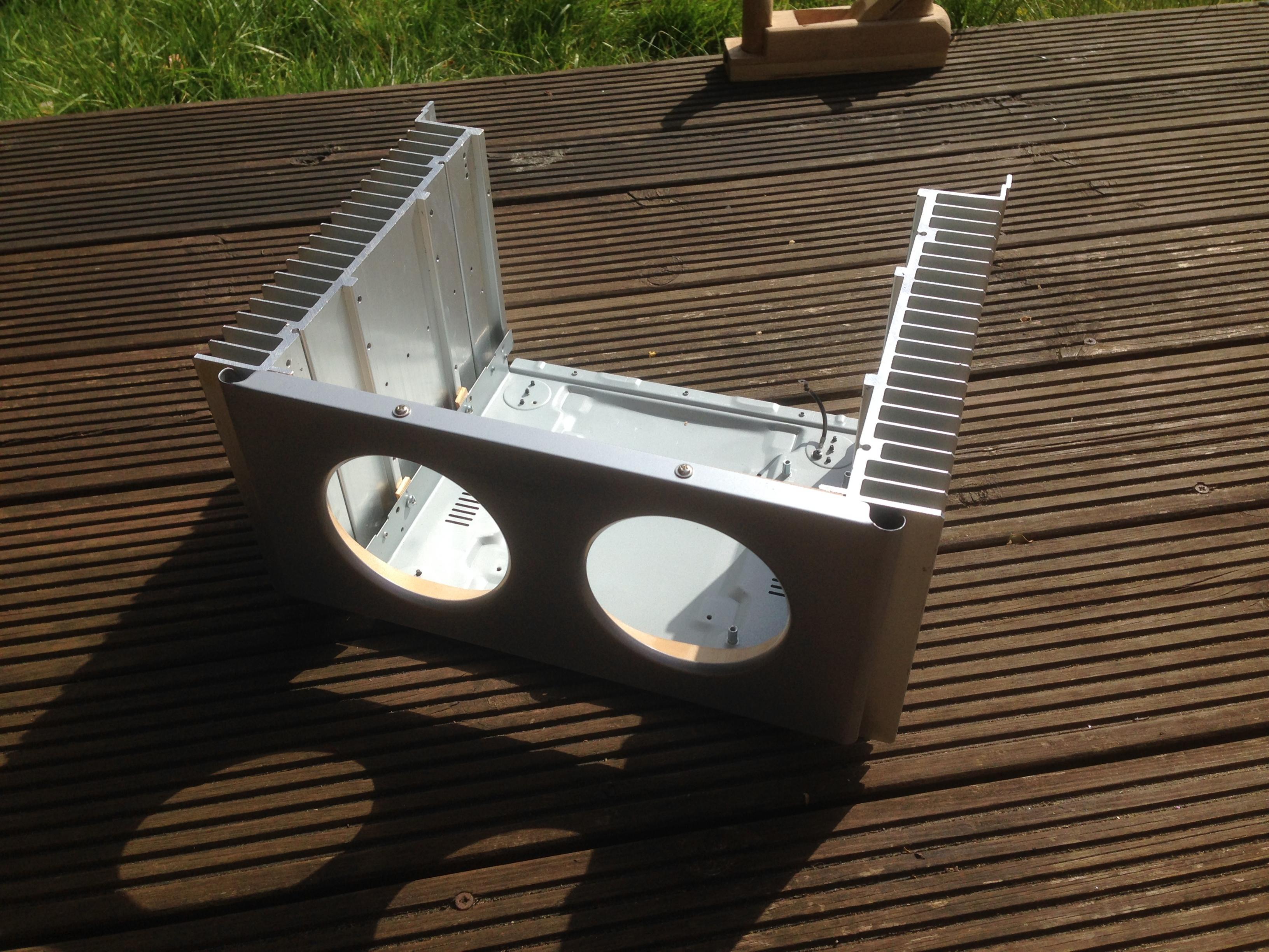

I got the Ashly amp chassis on eBay, it was sold for parts due to the extensive damage to the amp board. I think is was $50, a great deal for a full working chassis without the amp.

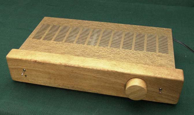

Is it ok if the Chassis is made out of wood?
All wood?
One problem is heat and ventilation, so you need to be aware of that. Wood is a good thermal insulator (and is flammable! ).
If using solid wood, thin panels aren't very strong.

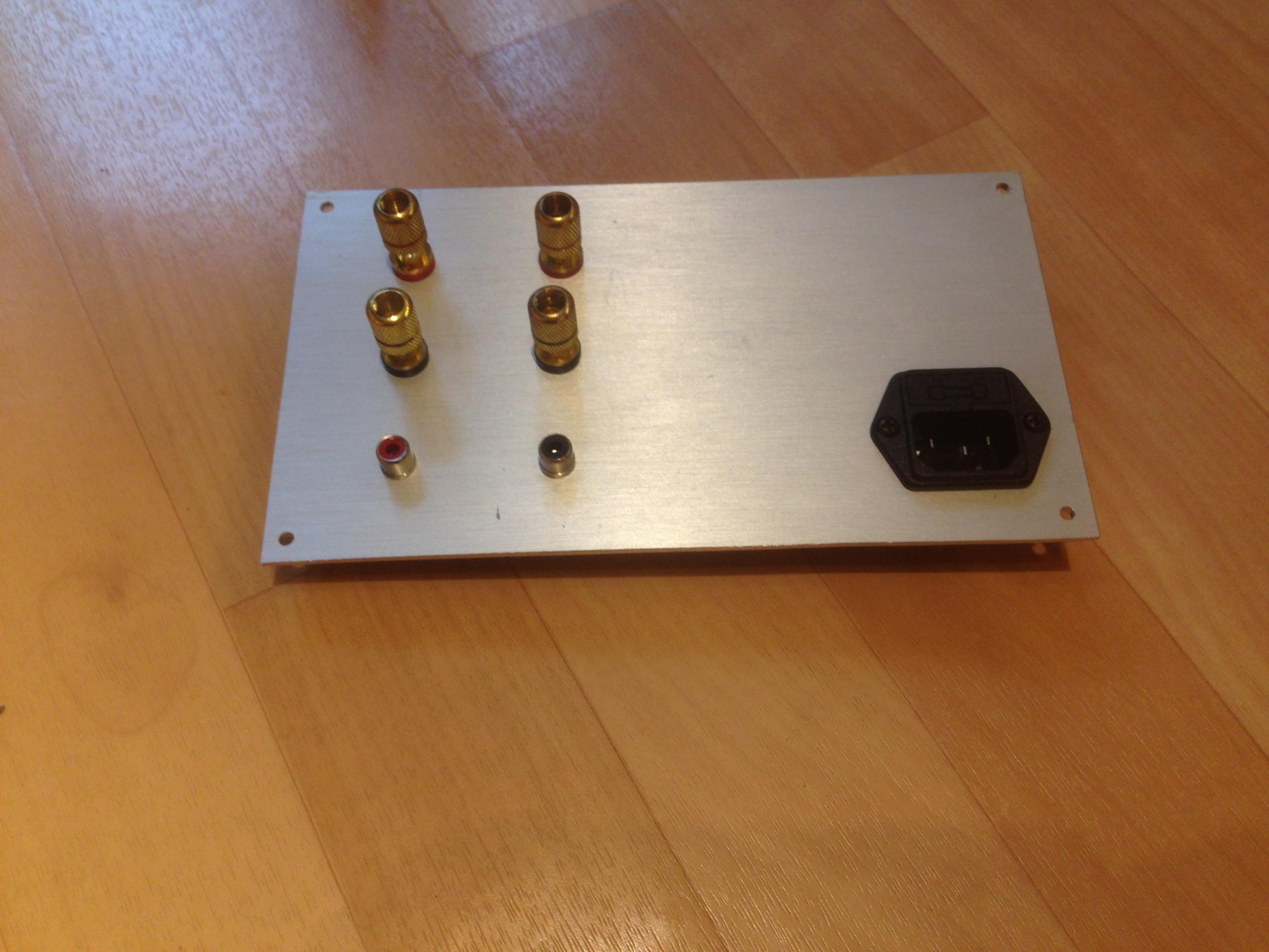

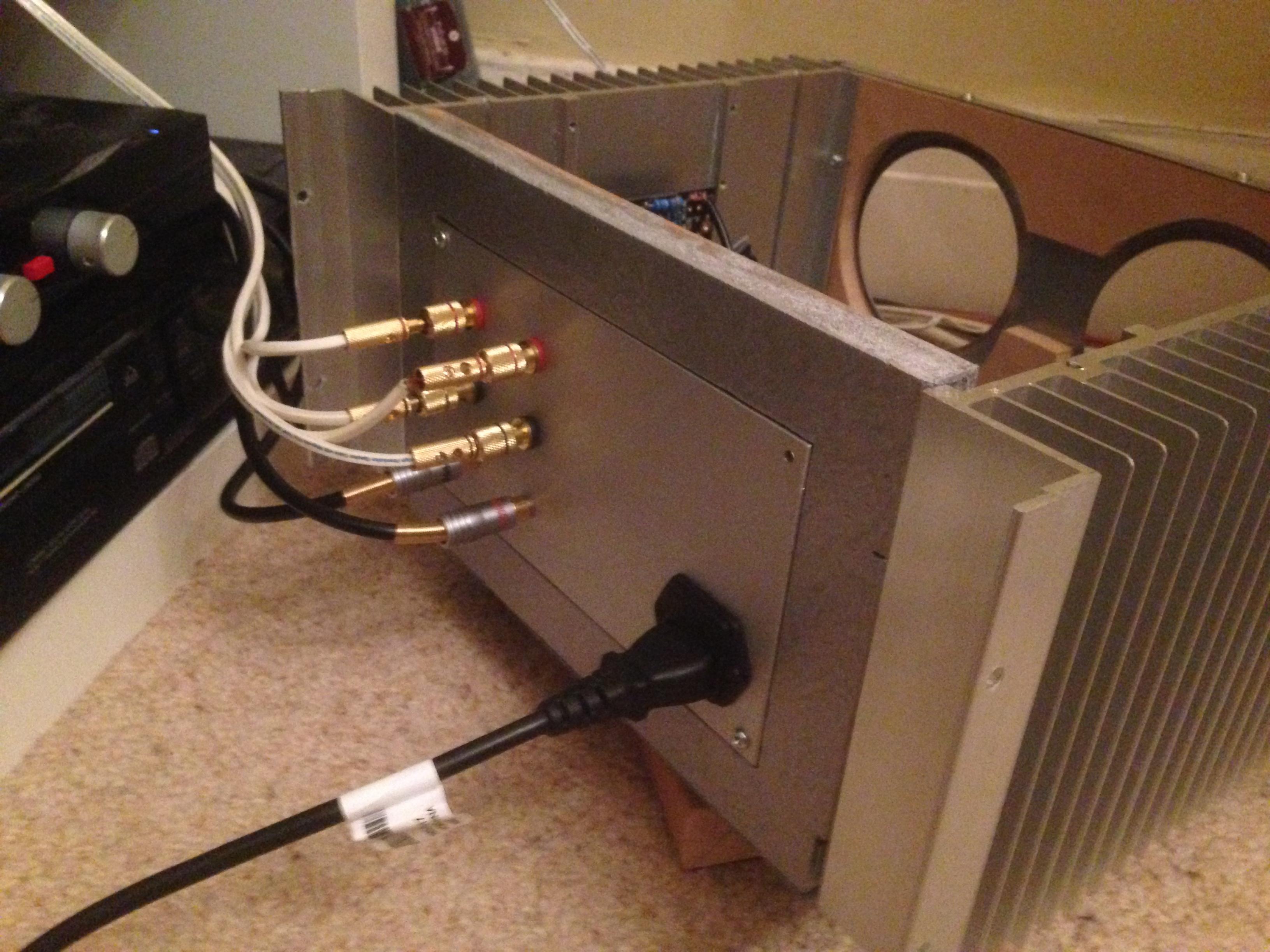

The problem I've found with using wood for faceplates and back plates is that most of the controls (pots, switches) and jacks don't attach well to thicker panels. So I've had to 'hollow out' the wood to allow the nut to thread on to the component. If the component is 'buried' into the back of the wood panel, it can be difficult to solder to it, if modifications have to be made.

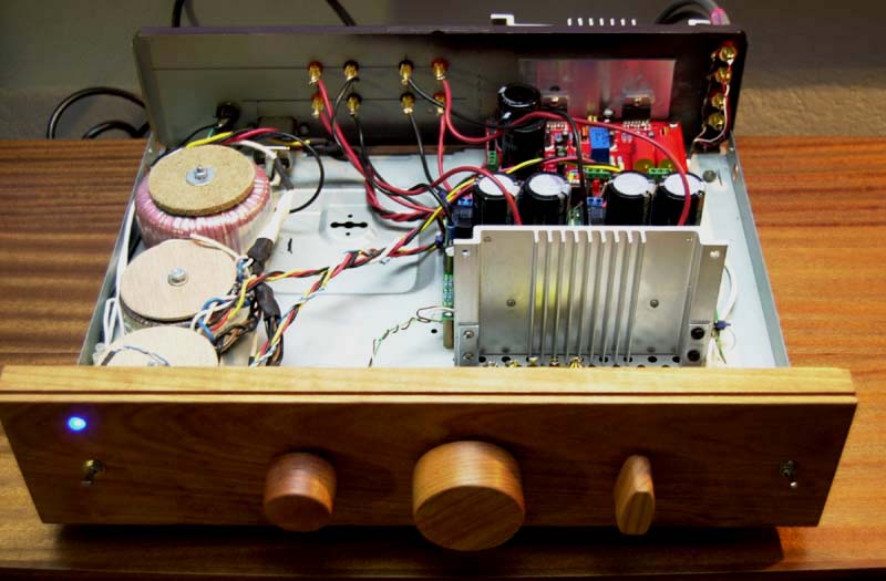

I have used a thick wood front panel on the chassis from an old commercial receiver and it looked OK.

Threaded inserts glued with epoxy.
The first time I fabricated a case like this. Next time will be better.

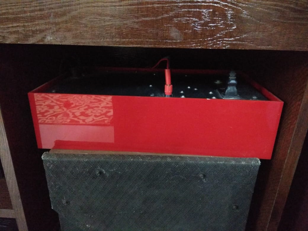

very very cheap.
I subsequently covered the sides with 3mm red acrylic panel, just slid over it with sufficient clearances.

Prasi-very very cheap.
Is that real carbon fiber on the top and base, or 'imitation' ?
It looks excellent.
The plastic surround is a good idea for safety to keep fingers out of the 'sparky' bits!

Its from aliexpress, so must be imitation, some thing like this
127cm 3D Carbon Fiber Film Vinyl Sheet Film sticker Car sticker phone motorcycle accessories Cover Waterproof on Aliexpress.com | Alibaba Group
Yes , I have a 10 month old in house, so have to keep everything protected and covered.
