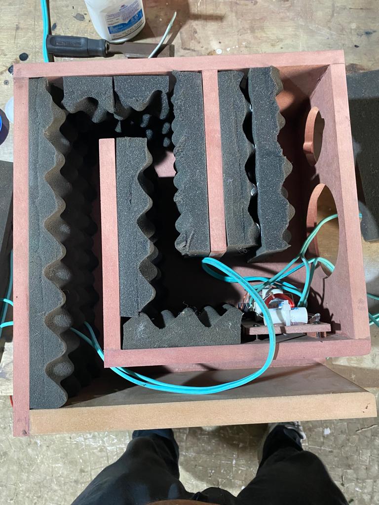

The sound I get from the speaker (CHP-90 driver installed) doesn't like me. Not "balanced". Too bright and no body at low frequencies. I believe is the driver. Cabinet is made from 2cm thick "daw" hard foam I have available (internal width ~7" or 18cm to be exact). The "blind side" of acoustic path staffed - not totally - with some thin sheets of very soft "afrolex foam"(I have seen that in some "vintage" British enclosures). The cabinet doesn't seems to leak (not too close the flame of the lighter). Maybe with another building material the results could be better. I don't know. For this reason I like to try the drivers I mention in my post #238 & #239 . Maybe vintage but VERY NICE SOUNDING (from 1993 or so, but new, as I was buy them as "spares" for another speaker I made)Do you have a TL cabinet built and you tested the woofers in them? How do you mean you are not getting encouraging results?
PS. I haven't install any BSC .I installed the CHP-90 ON the baffle externally. I compare the sound with the sound of the clip you upload

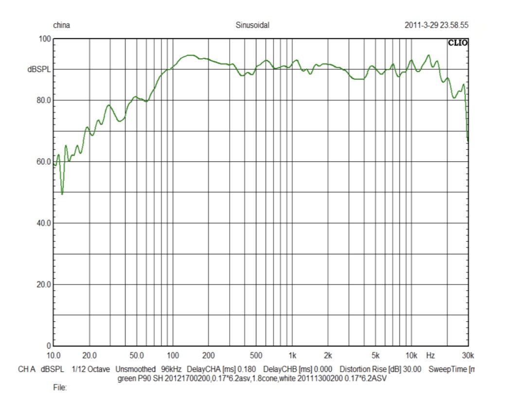

Looking at the specs for the MA CHP-90, it seems pretty good. I suspect the lack of a baffle step correction may be the source of the brightness you notice. My speakers with BSC are in the circa 83dB sensitivity range at 100Hz. The CHP-90 is nominally an 89dB sensitive driver and will need about 5-6dB of BSC to the upper mid and top end. Try adding about 0.8mH to 1mH and 6.8ohm to 10ohm resistor in parallel as BSC. See if that doesn’t improve the balance. Also, use something closer to polyfill (pillow stuffing) in the closed end to where the first 180deg turn is. Reduce stuffing if you don’t hear enough bass.

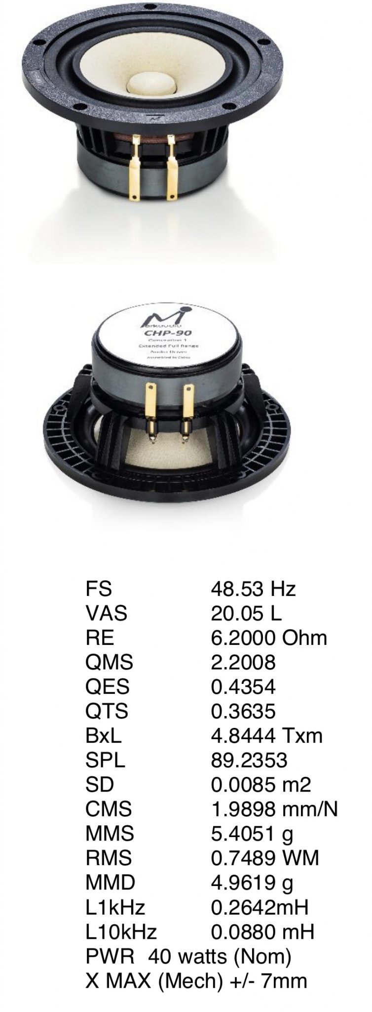

This factory response is quite nice and BSC should keep this shape but reduced to about 84dB sensitivity. Image from datasheet:
TS parameters indicates Vas is a bit larger meaning suspension is softer, hence cabinet volume may need to be bigger to allow deeper bass:

But how much bigger xrk ? It is - internally - already 18 cm width (externally the "fridge" is about 224mm roughly. I kept all the other internal dimensions as in your sketch. Of course the sound path is a little longer due to the thickens of the daw board.TS parameters indicates Vas is a bit larger meaning suspension is softer, hence cabinet volume may need to be bigger to allow ......

Let me find some time to run a simulation with the CHP-90 for you. In rough numbers scale volume of cabinet by ratio of Vas. Or 20/14 x 6.8in wide = 9.7in wide. It’s too wide to look pleasant in my opinion so I would extend the volume by increasing the length of the line or cross section area along the depth and height. But even if it was not wide enough, it should provide bass that sounds decent. The issue of brightness is due to lack of BSC.
Thanks xrk.Let me find some time to run a simulation with the CHP-90 for you. In rough numbers scale volume of cabinet by ratio of Vas. Or 20/14 x 6.8in wide = 9.7in wide. It’s too wide to look pleasant in my opinion so I would extend the volume by increasing the length of the line or cross section area along the depth and height. But even if it was not wide enough, it should provide bass that sounds decent. The issue of brightness is due to lack of BSC.

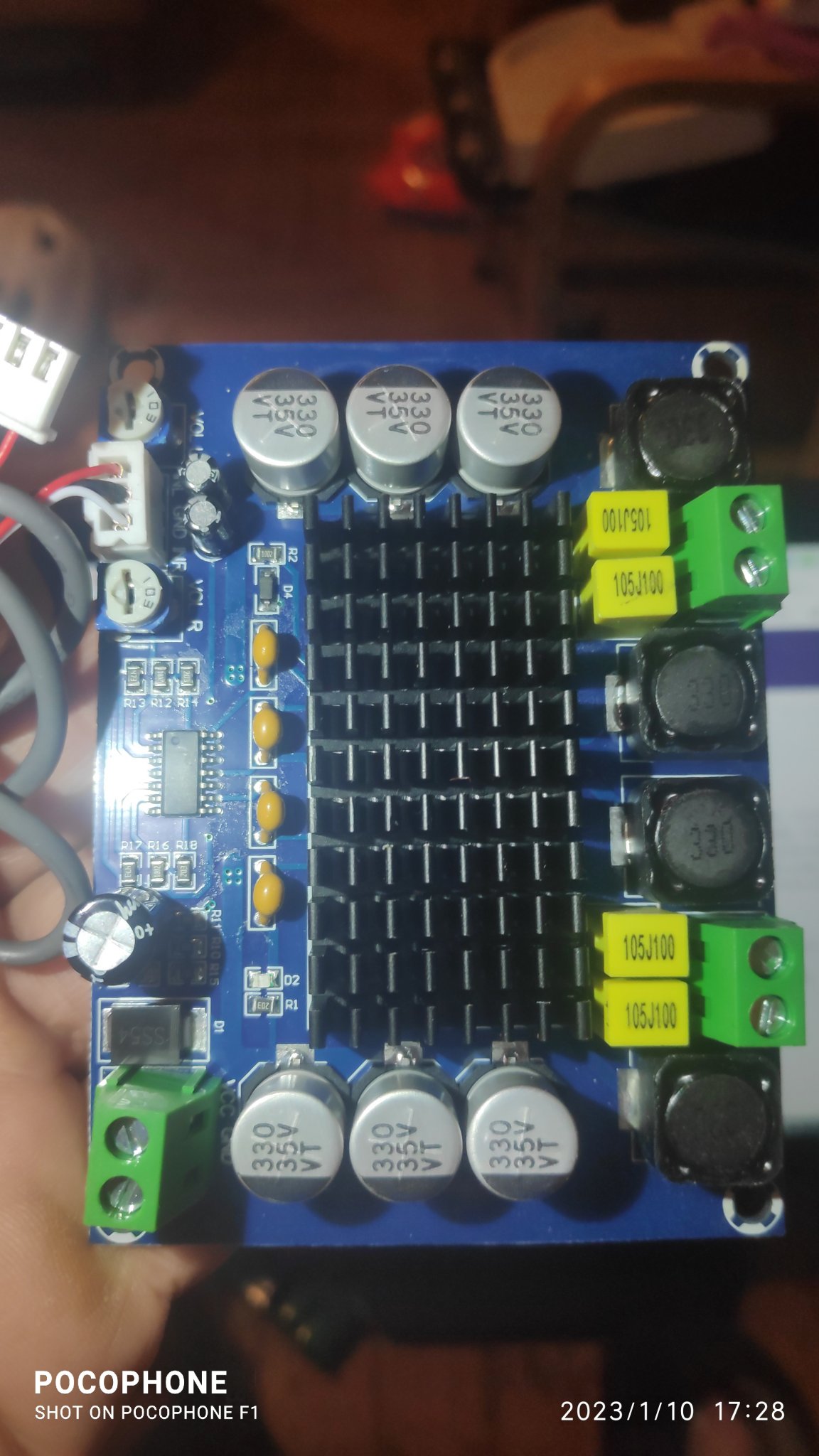

I quite recently receive this board and ... so-and-so about background hissing. Tested on Dayton Audio PC83-8 (free air).
Maybe TL074 causing the hissing + I don't like at all those 4 yellow ceramic multi..... 2,2μF (225) capacitors .

Search for bootstrap mod on the TPA3116 wiki. I wouldn’t worry about the ceramic caps. I use X7R and NP0 on my TPA3255 in the correct places. I also use them in the bootstrap mod. You want low ESR cap - I think it was X7R ceramic.
TPA3116 can be very good amp. The things to chase are upgrade the quality of the output inductor and use quality film cap on output filter cap. Use clean linear DC PSU will improve sound quality (or lots of good filtering).
That TPA3116 thread is a juggernaut. Huge. Have fun! You might just upgrade to TPA325x amps. They are becoming quite cheap now. Of course, great implementation still costs a bit more but sound is worth it.

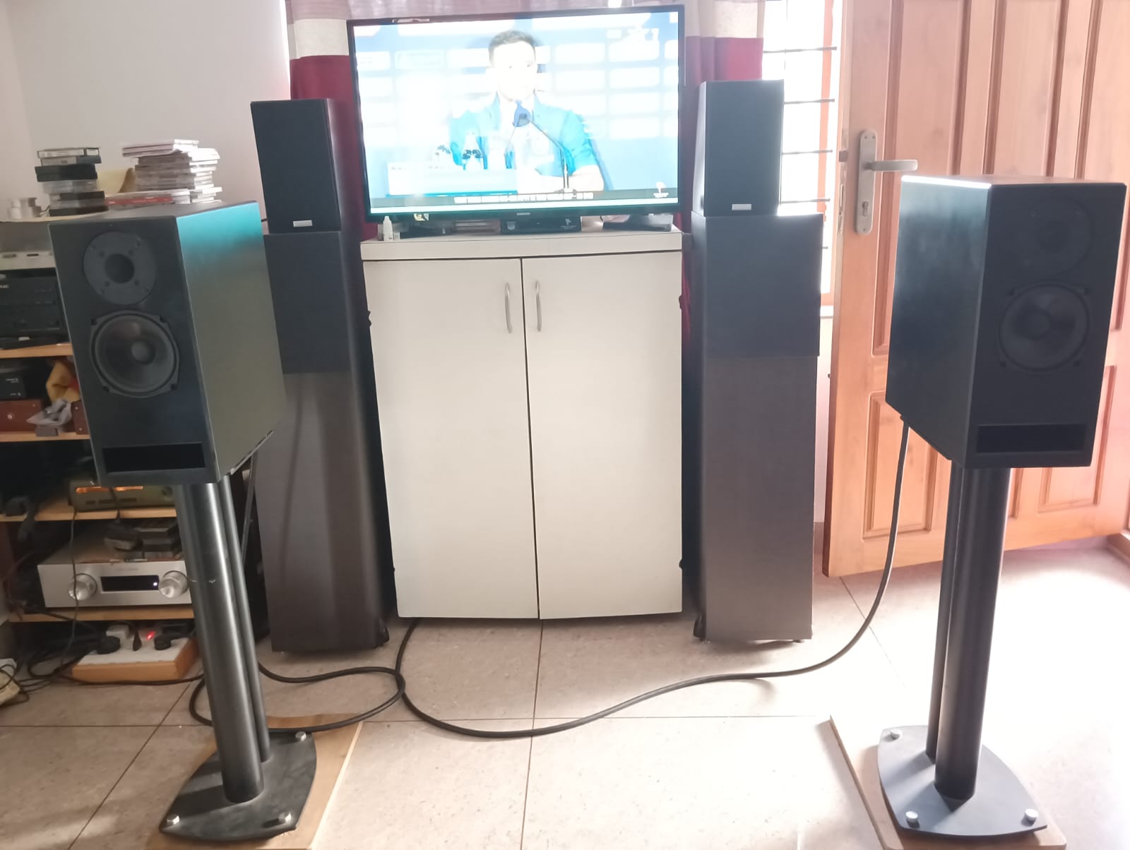

Well seems the break in process over and now it has become more clear and clean with pin point imaging and soundstage, depth layering whatever one can wish for in a compact enclosure. Pretty happy that I build one and a great thanks to @xrk971 .@xrk971 look what I have got here.. Oh damn this is more low ends than what I made with RS180-8 need to reevaluate that one. Thanks for making such a wonderful design.
My chain is pi2aes to denafrips pontus ii over i2s and from pontus to kinki studio ex-m1+, cables are all radioshack onces.
Jmascreen - Glad the speakers are working out great for you. You are using RST28F-4 tweeter and DC130A-8 woofer with passive crossover, right?
YesJmascreen - Glad the speakers are working out great for you. You are using RST28F-4 tweeter and DC130A-8 woofer with passive crossover, right?

I would like to build a pair of these. With no way to measure the finished result what would you suggest the best material to dampen the line and its quantity?
Your foam core used a polyfill like material, PMC uses egg crate foam and you also mentioned Mr Clean sponges.
