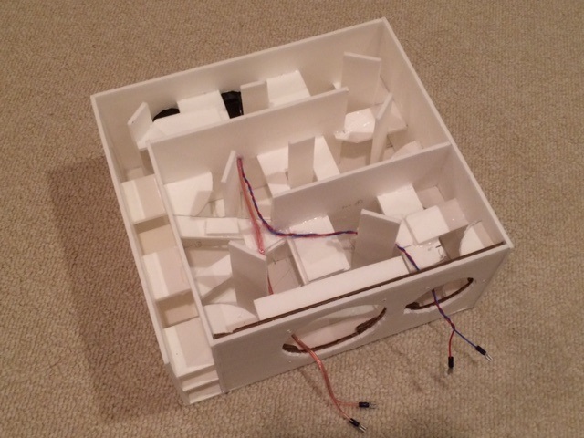

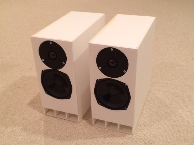

The second TL speaker is now awaiting for glue to dry on final side panel capping operation. I changed the bracing scheme a bit and built it from the outside in so that channel depths are defined by small spacers. Much more precise this way and went quickly. Not shown (for clarity) are foam damping pads behind driver and stuffing which resemble first unit.
Thanks, more impressive is the fact that the speaker without drivers weighs maybe 200 grams (foam and cardboard with glue). The copious bracing is critical to keep it from resonating like a musical instrument body.
I will fire it up later tonight for first sound.

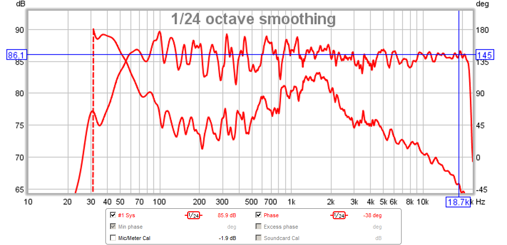

Stereo Unit 2 Measurement

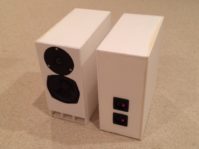

Here is the completed stereo pair. I installed a second layer of foam core on the baffle to rebate the drivers flush.

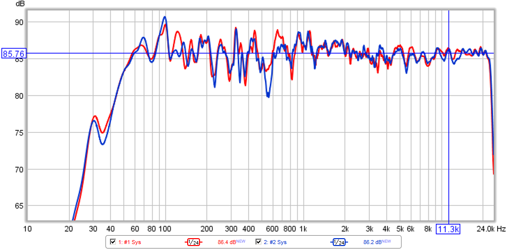

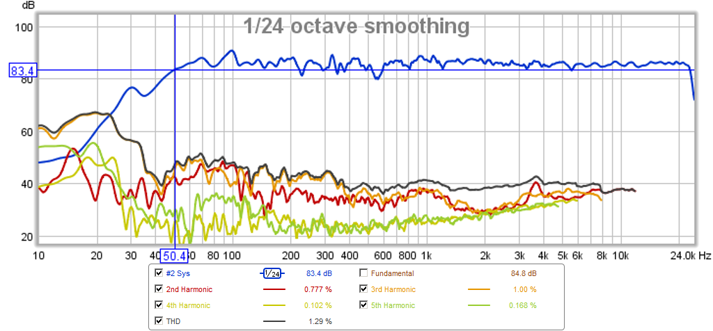

The frequency response between the two are pretty well matched left and right (-3dB is at 47Hz with a 3dB low shelf boost at 80Hz, f3 is 55Hz w/o boost):

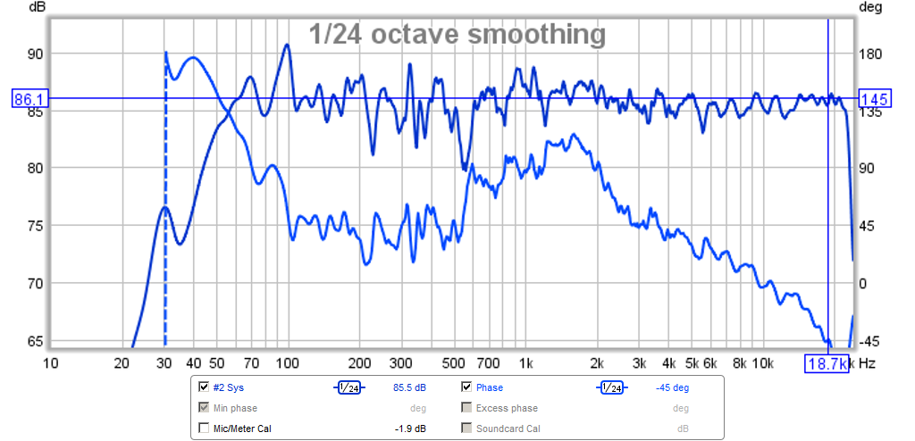

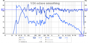

Here is the measured phase of unit 2:
Phase of unit 1:
Distortion of unit 2 at typical listening levels:

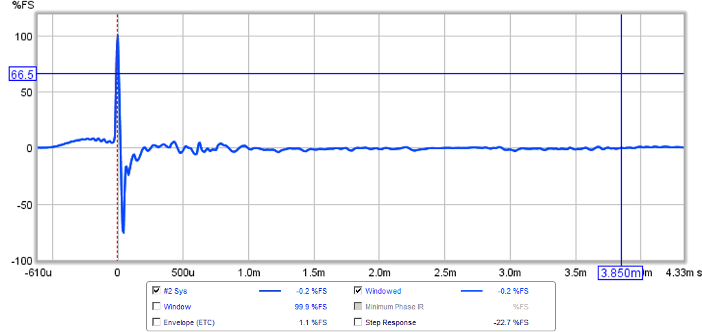

Impulse Response of unit 2:
How do they sound in stereo? Fantastic! The imaging is very good, the bass is tight and articulate, highs are exceptional clean and brilliant without being fatiguing. Impulse shows no major ringing issues.
Phase of unit 1:

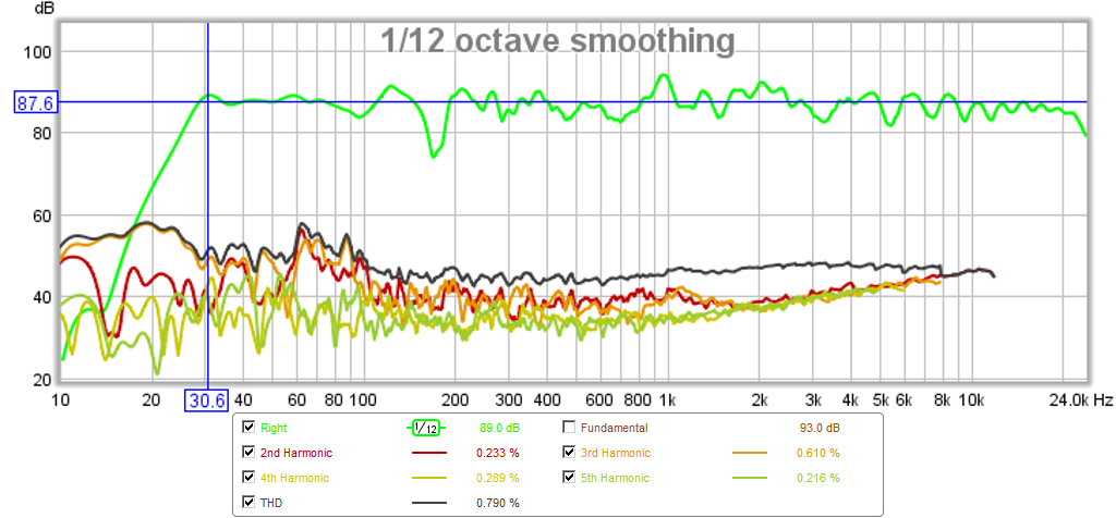

I set up these speakers as my desk monitors. They sound amazingly good - great bass extension, clear articulate mid bass and nice highs. Capable of 91dB SPL with distortion below 2%. Even plays dance tracks with a heavy bass beat with no problems. Flat from 30Hz to 20kHz.
Change .asc extension to .mp3 to listen.
Here is frequency response and distortion from one channel at 88dB, and 91dB in stereo. Dip at 170Hz is desk bounce.

Laminate the outside of the cabinets with Formica and you have a compact, TL equivalent of the old Wharfedale 708 foam-panel speakers from the 80s.
Not sure how the Wharfedale 708, besides the foam core, resembles this TL. I would imagine the sound and performance to be totally different. First thing that surprises me is how loud this can get, and get there cleanly. The damped TL does a nice job of controlling cone motion and providing the bass in the lower octave. I don't think a sealed or BR can do the same as efficiently.
I may try laminating the outside with thin 3/16in Sureply panels like I did on the 10F/RS225 monitor baffle. But quite happy with the sound and how lightweight the speaker is.
