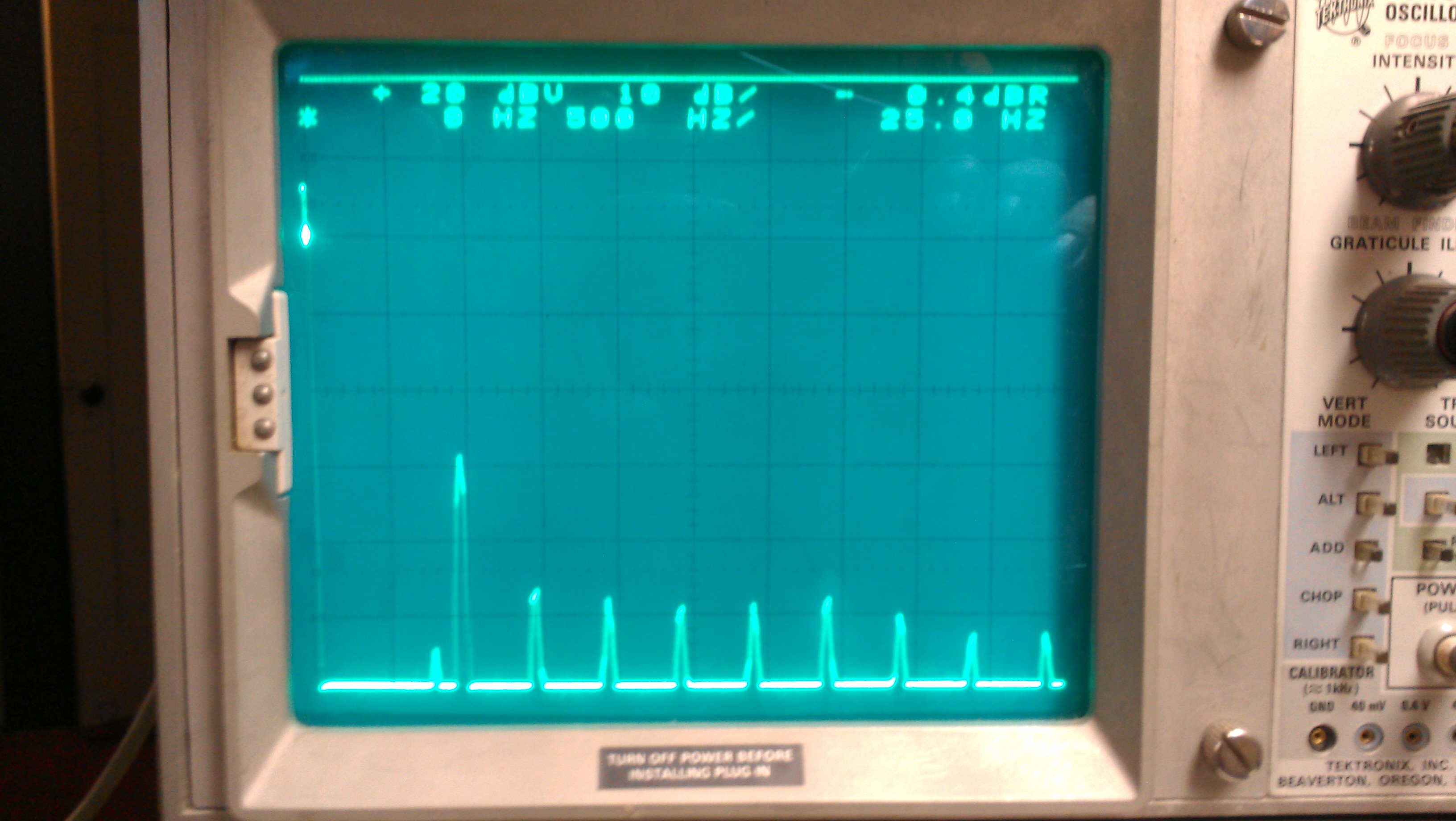

A quick test on the bench with a bench supply got me -130 dB second and -145 dB for the rest at 997 Hz (pretty much the limits of the Shibasoku). The power consumption is very low. I need to clean up the test setup before I can explore further. These are similar to what Victor measured.
The picture below is the distortion spectrum. The first peak is the second harmonic and the rest of the harmonics follow. The top line of the display is -80 dB and the vertical is 10 dB/div.

I'll try to get more data on the oscillator. The output is approx 2.7V full up. It has been stable for voltage (+/- .01dB) and frequency (995 Hz) for a day. I have been running it essentially unloaded. The pot and connector aren't even soldered in yet. The bulk of the measured distortion is second at -130dB++. This is good enough to test the limits of any ADC chip made today.

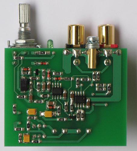

After studying the ebay pcb pix, I thought it appeared similar to a JanasCard inverting Wien bridge but with a jfet AGC. The seller said it was similar but used his own AGC jfet design with 1/2 D-S fed to G for second harmonic reduction.
The seller also indicated he was comtemplating posting the schematic here or on his ebay ad.
A couple of these with a good summer and output circuit could make a nice IM generator.
Looks like I snagged the last one on eBay U.S. So, this is the one to get then? I'm impressed. The SMD's look like they were done by hand. I hope he continues to produce them.
