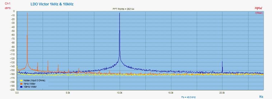

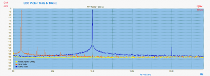

Well, to go into the real low dynamic range (> 120 dB), a tracked notch is still required. Otherwise AP could not go into this deep levels. The limitation is still given from the today's "Audio" ADC performance. But gets better and better. To have a ADC with >140dB DR, a larger sample rate >192kHz and without noise shaping rising at Fs/4. May ESS will show soon a new "Audio" ADC performance
Attached is a measurement with 1kHz & 10 kHz LDO oscillator, who shows "lower" THD performance at it really is. Typical for 1kHz about -150dB and for 10kHz about -140dB.
