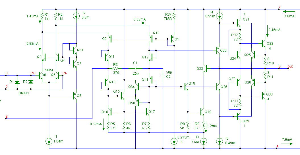

Hi David,
Have a look at this post for more info about the input stage and noise.
Below you see a simplified model at the device level. Probably not 100% correct, but better than a macro model.
Cheers, E.
  • AD797.txt
    AD797.txt
Macro models are what they are, not too much IMHO. I wouldn't count on much and certainly not fine scale distortion.
No - at this point I don't expect to model distortion with any accuracy, just understand the overall behavior.

Thanks Edmond, it is to your usual standard of professionalism.
More than I need now but it inspires me to try for the next level of accuracy.
Best wishes
David

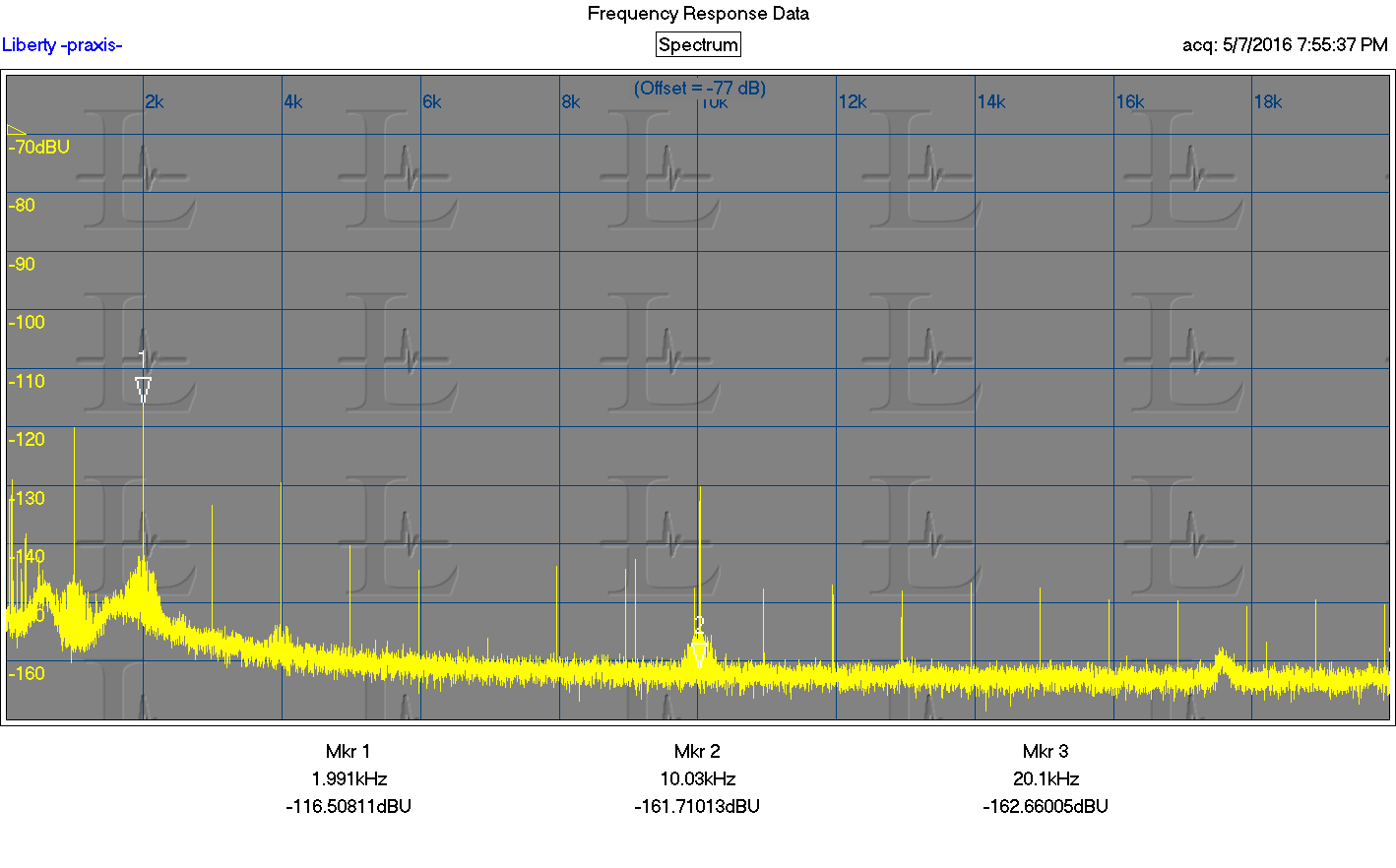

I got the latest Rexotech ULD 4 sample and made a quick measurement of the distortion. Because I can't figure out how to do an offset in ARTA the plot will need to be scaled- 0dB is actually -70 dB. So the -60 line is -130 dB. The distortion shown is really at the limits of the 725. At this level the potential of phase shifts causing cancellations between the source and the internal distortions is significant.
In any case it does deliver very good performance for a very reasonable price. I'll do more measurements as soon as I get some time.

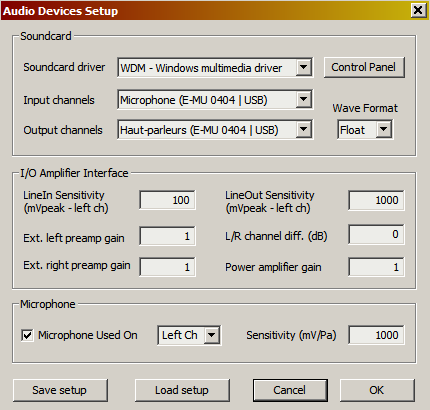

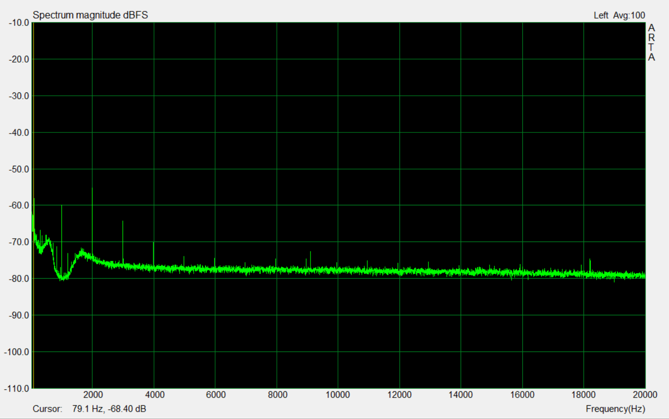

My problem is that 0dB would be 3,000V. The spectrum is the output of the Shibasoku 725. I'm not sure ARTA can handle that much offset. I have another way that works to get the info. I'll make some more measurements soon a better way. I'll make sure they are properly calibrated.
Demian I'm not clear about the reference.
The output from the 725 monitor is 1Vrms FS.
Do you mean you want to change the scale of ARTA by +10dB?
Where is the 3V coming from?
You can calibrate ARTA at any level below the sound card FS.
For example, input -20dBV and in ARTA cal type in 100mV. After accepting the level (the accept button), ARTA will display -20dBV.
If you want to trick ARTA input -20dB and type in 1000mV. Then ARTA will display -40dB with a -20dBV input.
I know my description is confusiong. What I want to do is scale the output of the 725 to match the input. If the 725 is boosting the input by 70 dB I want to scale the display so the indicated levels are scaled correctly and a -130 dB harmonic is displayed at -130 dB.
I'll try your method and see if I can make it work. Essentially enter 1V and set the cal to .1 mV. In Praxis there is a simple offset field independent of calibration.
No don't bother ARTA won't do it.
We'll have find another piece of software.
ARTA functions well but no control over the graphics.

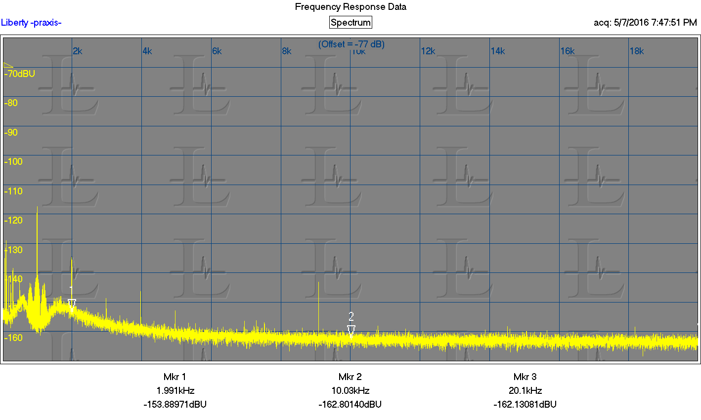

Here is the ULD4 and Victors 1 KHz compared. Victors is better BUT the ULD4 comes ready to use.
These are scaled correctly. First is ULD4 , second is Victor's. Also shows how clean things are with battery power. I just wish 9V batteries were not so expensive, especially when I forget to turn it off.
