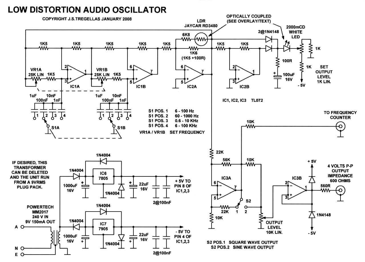

Low-distortion Audio-range Oscillator
Looks like a Wien bridge to me, just configured a bit differently.
I'd agree with Richiem, Victor's design looks better.
I can never understand how a LDR + PI controller can work properly, seeing as the LDR is a PI control element in itself, or at least a leaky integrator. Everytime I've simulated one it's very difficult to get them to stabilise. By the time I got that AN43 design to work the distortion looked poor.
Does anybody have a spice model for the VTL5C10 ?
I only have Thomas Gootee's VTL5C2 model, the 5C10 is a low slope type.
I've given up on simulating an oscillator in spice. I'm just going to build them from now on. The parts for the LT oscillator should be arriving today. I had bought the VTL5C10 a few months ago so I might as well use them. I can't build something I don't have at least a basic understanding of so Victor's circuit is out for me right now.
Series : C11 || C12 + R20 || R21 + R26 || R27
Parallel : (R28 + R29) || C16
The series part has R/2 and C*2 compared to the parallel in this design
Thanks.
I didn't know you could have a Wein bridge oscillator with unequal arms and have it function. I guess it's just the ratios that matter. There's a whole pile of other stuff in this design that I also don't understand if the actual bridge oscillator is around IC2a. I'm sorry I'm not smart enough to understand this circuit.
At any rate, I think it would be hard to make Victor's circuit a variable one unless the values in the bridge arms were changed.
Is there a way to use some of the ideas in Victor's circuit to modify the LT one?

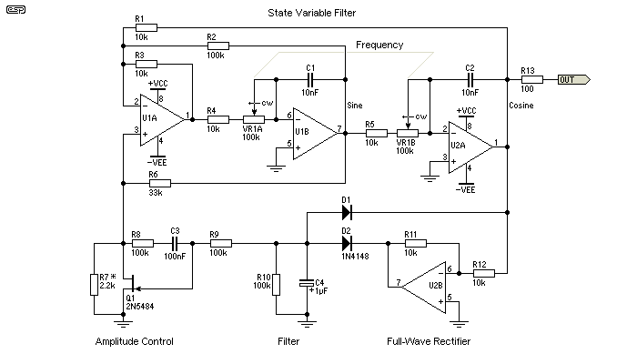

What if I replaced the jfet amplitude control in this circuit with a VTL5C10? Would that improve the performance significantly? I get lost when circuits start to get really complex, like in the link I posted above.
It's so complex that I get lost.
Well, designing a high-performance variable-frequency oscillator is so difficult that it's just not possible to end up with a trivial schematic. GK's design is still pretty easy--check out the AP System One! Not wanting to offend, but if you have no chance to follow even Victor's simple (yet smart!) design, then designing one yourself is likely just out of reach for the moment being...

I was hoping to improve on my Kenwood 204D, and have two unbalanced and two balanced outputs.
