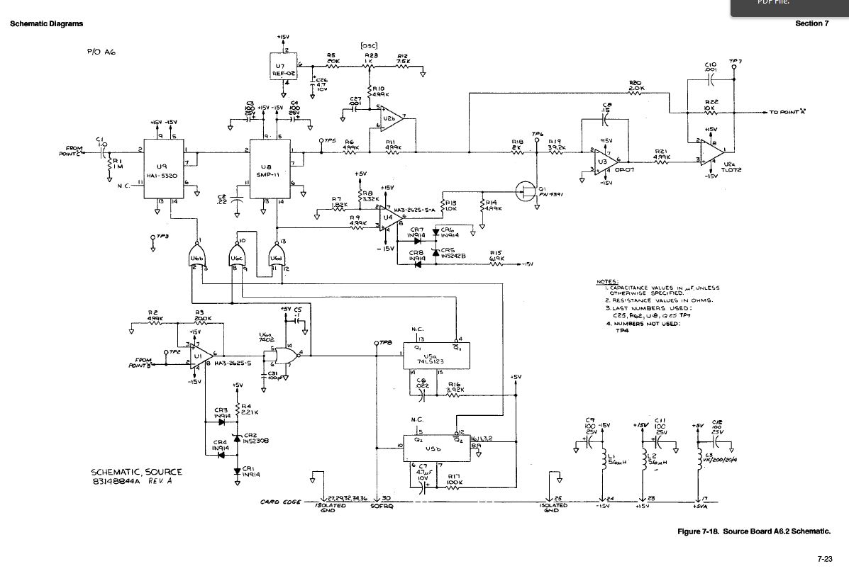

Boonton 1121 AGC circuit
I have attached the Boonton 1121 AGC circuit. This circuit has fast settling and works without any time constant changes from 10 Hz to 140 KHz controlling a SVF oscillator.
Point c is the sine output, point b is the cosine output and point a is the dc voltage back to the AGC element (an analog multiplier in this case). The absolute flatness is in the .01 dB range across its full range. I don't know the settling time but its fast enough to use for swept measurements. An informal test from 500 Hz to 20 Hz showed no obvious change in level.
It may seem complex but all the other solutions are similarly complex and I would guess the cost of an extra wafer on a switch for range caps would not be much less expensive.
The HA2625 opamp is uncompensated and they used the compensation connection to limit the output swing to work with TTL. You would need a separate 5v supply for this circuit.

I ws thinking Gilbert Cell multipliers might be better suited to audio - but not certain of practical limits - obviously Spice perfectly matched Q models will give over optimistic results
and what are we practically aiming for -120, -140 dB for < 20? kHz harmonics + IMD, Spurs?? from 24/192 aduio DACs generating input sines in 50-100 kHz range

Hi Demian,
Thanks for this.
There isn't much on the schematic that isn't obsolyte. They don't make sample and hold amplifier IC's like they used to. I'm not sure one could find suitable replacement.
Nice circuit though.
Everything but the smp-11 is still current. AD has a number of possible replacements and the Intersil part may work in both slots. and its function is less demanding than the first SHA. The ssi is all still around in various form.
The point is that its quite possible to make a suitable agc circuit that doesn't need tuning.
I have a similar solution that is mostly discrete if you prefer. It would be cheaper as well.
This leveling loop does have a proportional integrator time constant, or it would not be fast settling. It's again a (though rather basic) variant of the sample-and-hold detector, with gated integrator.

There are tons of FET switches available, and caps and opamps too. That's all you need for a suitable sample-and-hold. The true problem is not about parts; it's about knowledge. I'm ready to give detailed support, but I'm not ready to just hand-in a working design.

I meant for the Booton circuit. Of course there are plenty of parts available for a THSH and numerous ways of going about it. I just haven't found one that I happy with the performance of noise wise.
