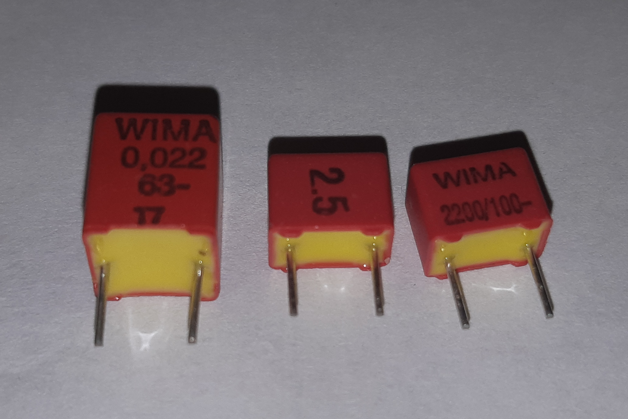

LKA, I was looking for parts for this, but I can't find the FKP with 1% tol. Best I see is 2.5%.
Where did you get yours?

5x Capacitor 22nF, 63V, 1%, FKP2 WIMA | eBay
for 10k notch I bought 2.2nF 2.5%
Are they really 1%? Seems very cheap ...
Jan

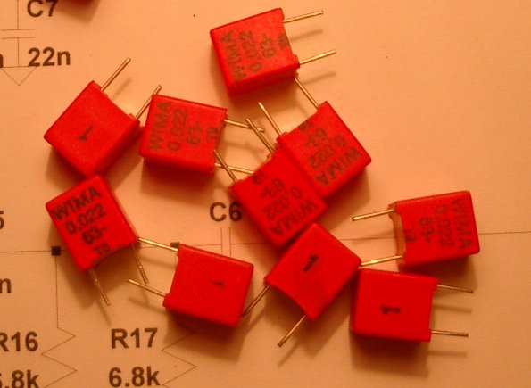

I think yes. I had five 22nF 1%, one left. Number on the backside signifies the tolerance.
Jan when I bought caps for my SVO, Dick Moore sent me and impedance bridge to match them. I had only a small sample to works with. To my surprise they all matched to 0.01% from part to part. I didn't check for closeness to nominal but if your part to part tolerance is what matters then from a batch they may be very close already.
Yes that could well be. I can measure capacitance to 0.1% absolute, 0.01% matching, which will do.
Jan
Sold out! 1% WIMA costs 2-3 € from a prof. distributor. Here 30 cents. Very strange. Probably the trader has acquired a large position and added little profit.
