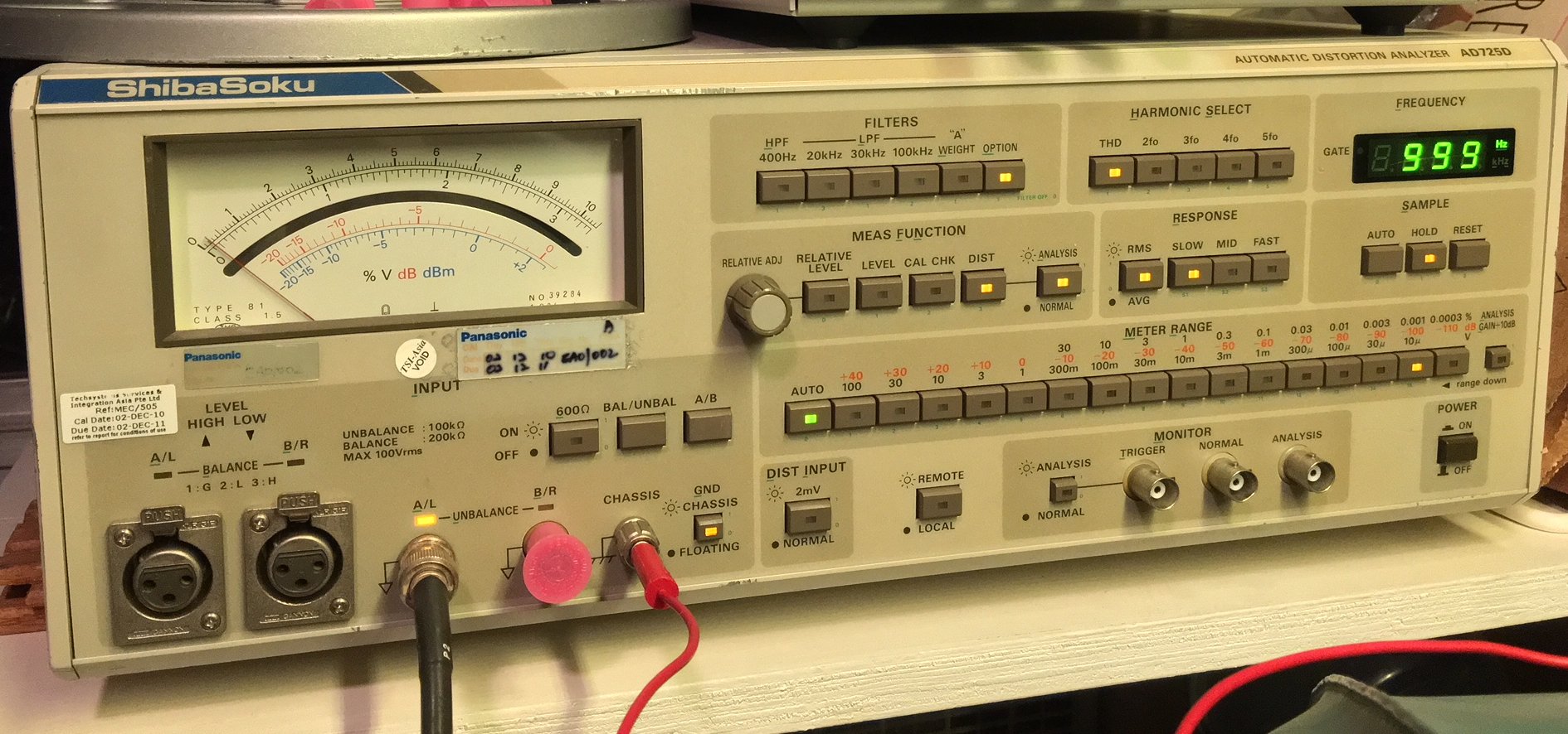

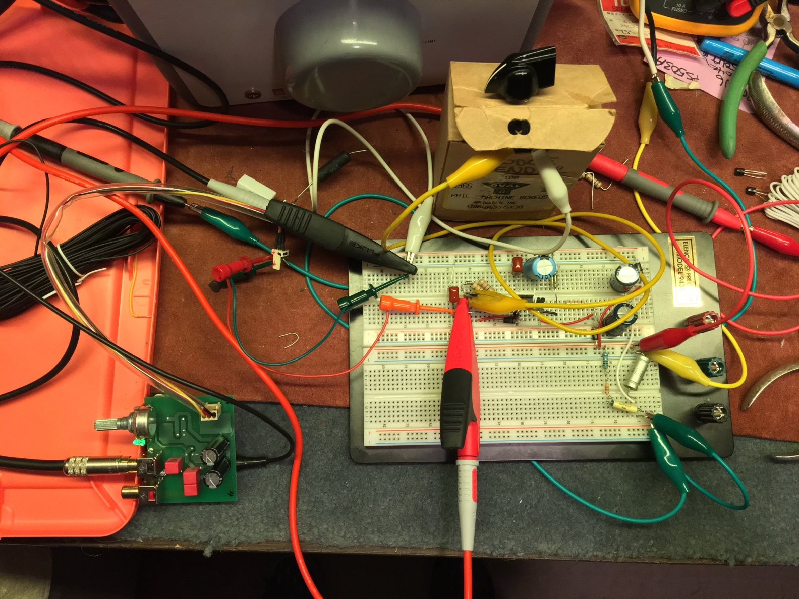

Hi all,

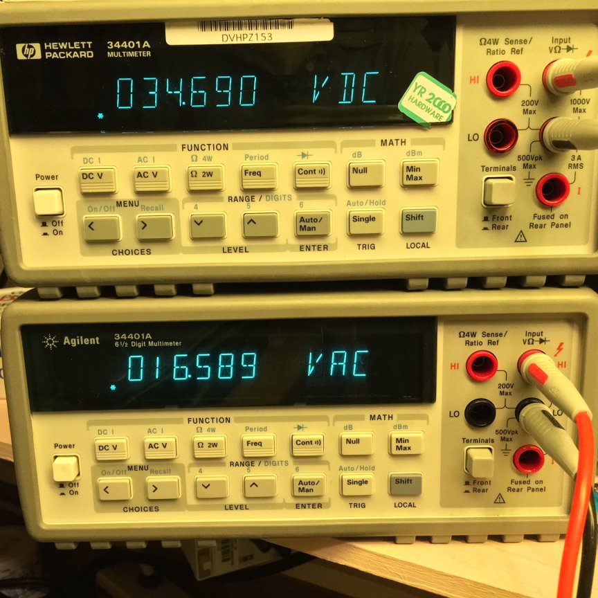

I just fired up Victors oscillator and using mikebeth's power supply schematic that
he's going to make power supply boards for Victor's oscillator. Mikey's post is #8700.
It's designed for a 16VAC walwort transformer into his board, then connected to
Victor's Osc at 35VDC.

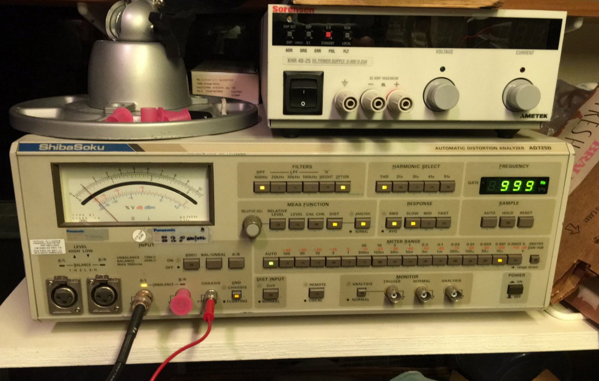

My first pass firing up the oscillator plugged in to my Shibasoku 725D came in at
a whopping -60dB, using the red RCA through Mic cable connected to the kluged
shielded Banana Jack adapter to BNC, then BNC to BNC to the 725D.
After a brief cogitation period which involved looking for some better cabling
options, making dinner for my little six year old girl, going through bins and bins
of cables and connectors...at least I found one that would work. It's the Female Banana
Jack to Male BNC connector. So I plugged RCA into black side, using the mic cable, and
plugged the male Bananas into the female bananas, and with standard good BNC cable
ran it to the trusty Shibasoku 725D. And, this time I included a ground connection from the
distortion analyzer Victor's ground screw. Low and behold I now have distortion down to
between -120dB and -124dB w/o a notch filter in the open air.

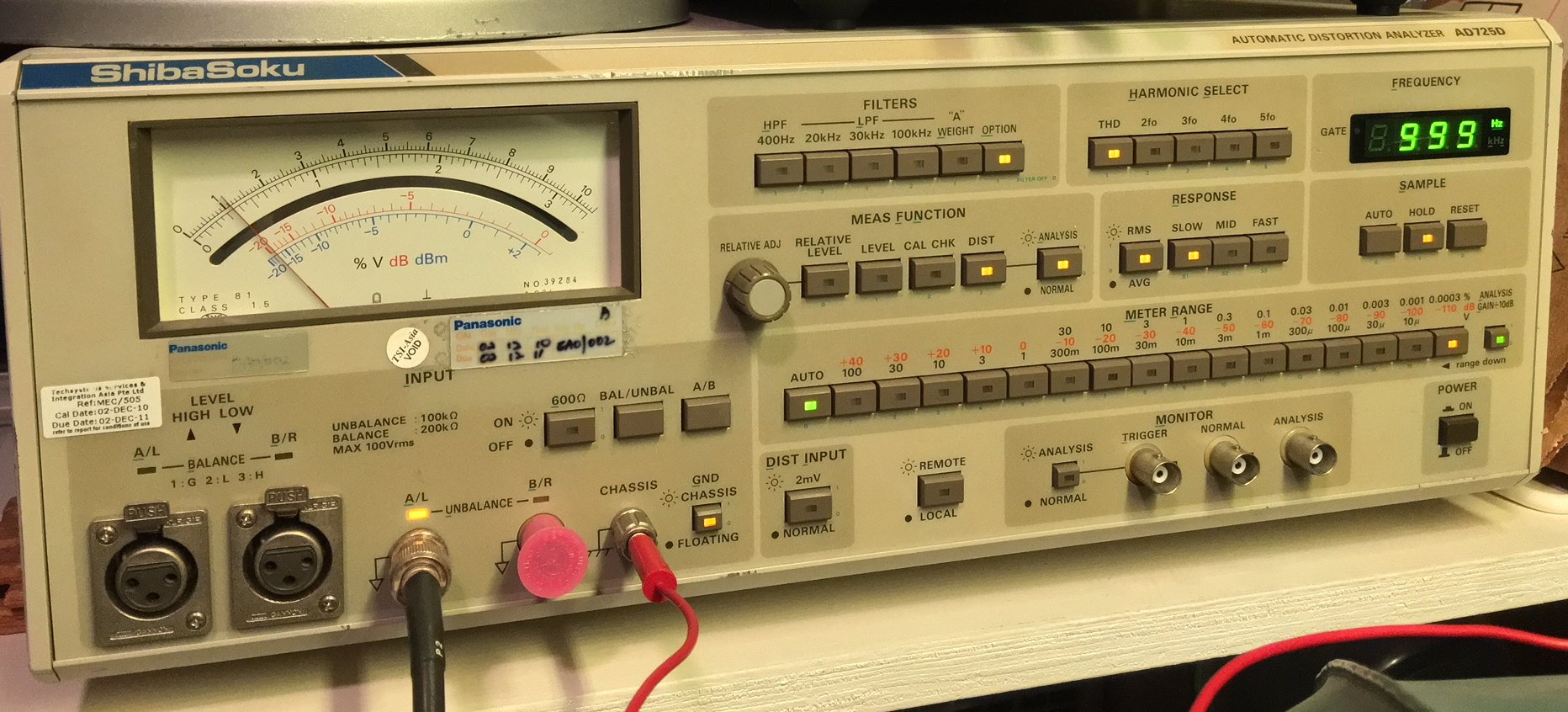

The lowest measurement, was with the "option" filter. Don't ask, I have no idea which
or what that filter does, there is no documentation for it.
This brings up a couple of questions I have and maybe 1Audio (Demian) or
someone familiar with the Shibasoku 725D or other meters can help with
the final calculations of THD in dB or percent. My focus is on the last two images.
06.OptionOnly: THD Measured, MeterRange 0.001%(-100dB), MeterDisplay = .02% (>-20dB)
06.OptionOnly: THD Measured, MeterRange0.0003%(-110dB), MeterDisplay = 11% (-19dB) Note: Gain-10dB Selected.
for the 06.OptionOnly Reading, it should be -100dB from Range + -20dB from Meter, + -9dB of range from the -10dB Button.
or -129dB at 999Hz in open air, no shielding for Victor's Oscillator.
or from percent calculation, 0.001% x .11% = 0.00011%.
I'm thinking this is pretty good all things considered, what think y'all?
Will I gain another -20dB to -30 dB using shield in box,
and using a notch filter?
Here are the pics.
Post Script - When I was measuring the harmonics of automotive coils, and was looking in the area of 300kHz,
the Shibasoku 725D gave me readings of it. I was amazed, that it looked at harmonic data up to about 1MHz,
before it petered out. This machine is a lot better then it's data sheet by a large margin.

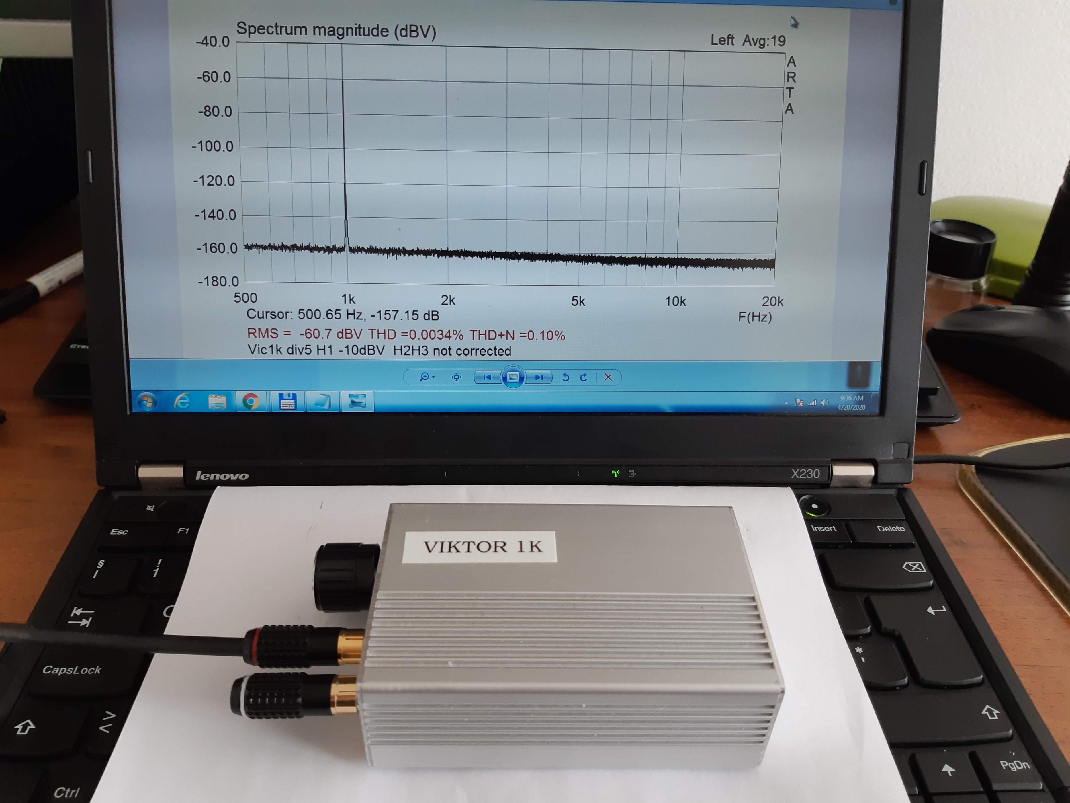

Who owns Viktor's oscillator certainly knows its output voltage range.
Vic1k voltage range (unloaded, 600R output imp)
min 0.288 Vrms
max 2.782 Vrms
0.29Vrms is too much when somebody wants to measure poweramp at low powers, let's say 1W/4R. For lowering the oscillator output voltage I use voltage divider in unusual way, RCA plug with 150R resitor inside. Then the modified range is:
Vic1k 1:5, output imp 120R
min 0.056 Vrms
max 0.556 Vrms
The performance is still excellent:
H1: -10dBV (0.31 Vrms)
H2: -157dBV/noise (passive notch, no correction on graph)
H3: -159dBV/noise (passive notch, no correction on graph)
min 0.288 Vrms
max 2.782 Vrms
min 0.056 Vrms
max 0.556 Vrms
