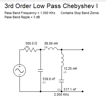

How much attenuation can be tolerated? The CLT-1 uses passive L/C filters to get to -170 dB. For 10 KHz the inductors are quite large. Still an LC filter with a sharp cutoff at 1500 Hz may be a realistic option.
Below is a "buildable" filter with a zero at 2 KHz and 35 dB attenuation above. I would be the first to say it will not be easy to build. Maybe JNeutron's toroid winder would be helpful here.

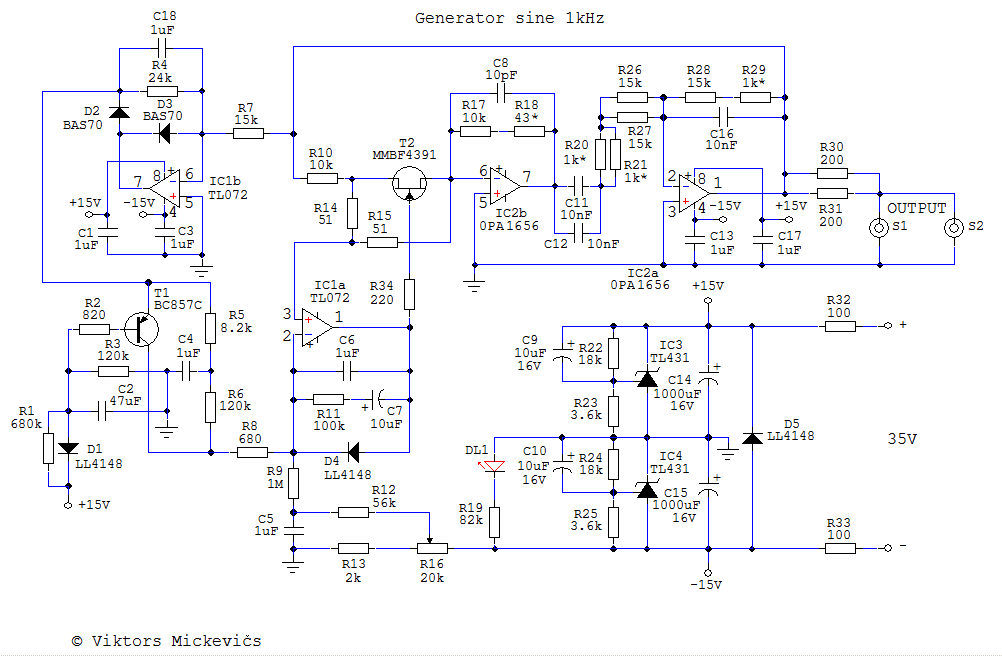

The general rule is that the distortion becomes lower with a larger supply voltage. Do you have measurements?BTW - drop the PS total for Victor's osc/gen to 30vdc. It lowers the 3H by 6dB.
Every little bit counts.
When you lower the PSU to 30VDC:BTW - drop the PS total for Victor's osc/gen to 30vdc. It lowers the 3H by 6dB.
The shunt regulators are out of current and not working,
Onboard supply voltage for the opamps and for the AGC reference becomes lower and may drift without the stabilization.
As result the output voltage also becomes lower and may drift.
Vic.
Are these TL431 shunt regulators important or are standard 7815/7915 voltage regulators sufficient?
The shunt regulators are used for to eliminate ground loops via the external PSU. Otherwise no matter.Are these TL431 shunt regulators important or are standard 7815/7915 voltage regulators sufficient?

Victor, How would I or anytone adjust the shunt regulators if using yourThe shunt regulators are used for to eliminate ground loops via the external PSU. Otherwise no matter.
Vic.
oscillator with lower voltages? Is there a simple place to tack a pot somewhere?
Or to tack a variable cap somewhere?
Also, Vic, which other devices would be a drop in replacement for what you
are currently using? There's that NEW Ti opamp from BB.
Are any of the LMExxxxHA's possible for tacking on?
Would there be a large change if using an LME49813 for instance,
CFB yes?.
Or the little LME49999 soic device?
or the one diyralf mentioned above?
I am only asking because I don't know and now sure how to go about it.
You can see the actual schematic:Victor, How would I or anytone adjust the shunt regulators if using your oscillator with lower voltages? Is there a simple place to tack a pot somewhere?
CFB yes?.
https://content22-foto.inbox.lv/albums/e/elterra/OscillatorNew/Gen1kHzN7.png
If you wish to use lower voltage, you need to keep the 25mA current from the external supply. So, the resistors R32, R33 must be changed. If you wish to run onboard shunt stabilizers at lower voltage, you need to change the R22, R24 for less value, but it is your own risk to get lower performance.
There is no simple solution for to place a pot or variable cap in the schematic, if you meant to change the frequency.
Vic.
R14,R15 is near the MMBF4391 (SOT23). The value may be lower than in in the schematic - latest update 33 ohm....TL072 opamp..... can that be changed to lower LF noise part and will that help lower the LF noise output level? Also, where is R14, 15 on PCB?
Probably you won't see the difference, if the TL072 will be changed.
Vic.

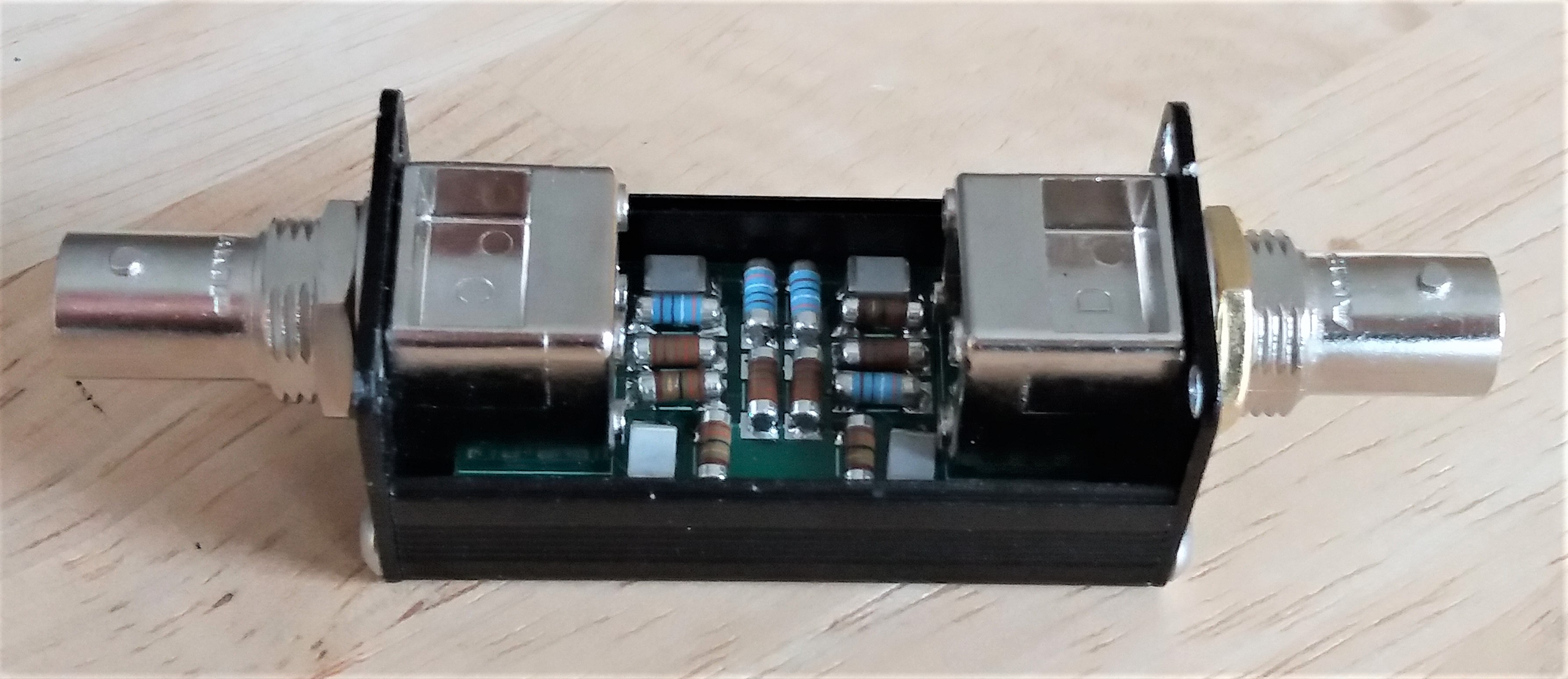

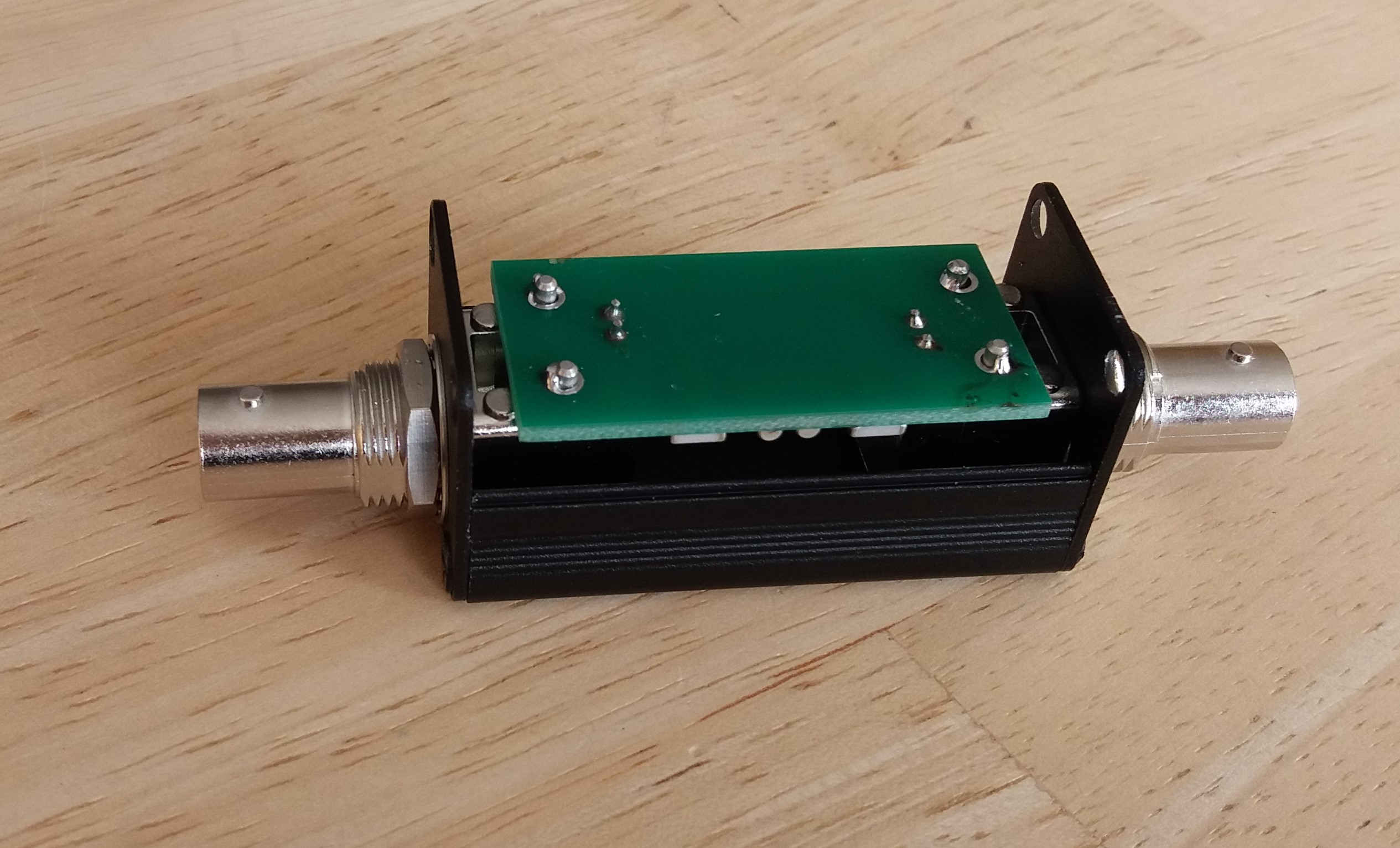

Slightly OT: After building several single-ended twin-tees, I have a dozen PCBs left. I wrote up the whole thing including small case etc, see attached.
Anybody wants any, let me know, € 10 including shipping anywhere in Europe for the time being (shipping oversees from Belgium carries a € 50 premium fee ...).
Jan
