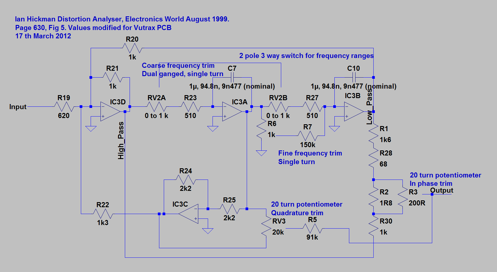

Thanks for your input. Yes is was a design by Ian Hickman published in the August 1999 edition of Electronics World. I modified the design but my memory is a little vague and my documentation is incomplete. The changes were:-Was it a design by Ian Hickman? If you are going to replace the OPA2134s with LME49710s then you will probably need to lower quite a bit resistor values both in the inverter stage and in the integrators - 2134's current noise density is about 3 orders of magnitude lower than the 49710's.
L.
I didn't include the Low Pass Filter. I was going to exceed the pin limit of the Vutrax PCB design software version I was using. Also the roll off is set for 20 kHz. I guess OK for measuring distortion at 1 kHz but not that much above.
I didn't use the residual amplifier design as I thought that it was lacking in bandwidth so I used 4 stages each using an OPA134 with switchable gain x1 or x10.
I used an Analog Devices AD536A rms to DC converter instead of the full wave rectifier and averaging circuit. I had the Analog Devices part on a board and I don't like just measuring the average of noise or distortion residual. Also full wave rectifier circuits can have bandwidth limitations.
I changed all the Notch Filter component values. I believe that there are some errors in the original schematic. R19 needs to be reduced for the notch filter to have unity gain for the residual. I believe that the values of R28 and R30 are transposed.
I reduced all the impedances by about 100 so the current noise density should be less of a problem but the OPA134 output drive capability is.
I also added a notch bypass switch, buffer and level set control.

But the lowered Zs cause other, possibly serious, problems. Davada has observed the significant loss of open-loop gain due to even moderate output loading. A spec sheet statement about driving low-Z loads never points out this type of loss, which has big impacts on THD. Also, although the LME79XXX parts have many virtues, high input Z is not one of them, so that has to be taken into account, too, especially for integrators.
I think some form of compound circuit, or perhaps better, paralleling amps to increase drive and preserve open-loop gain, will turn out to be important for performance improvements.

Hi Davada,
I've just done a few quick tests on the SVF generator I did mention in one of my last messages to investigate the effects of heavy loading. The generator is based on a ring of 5534s equipped with a 4-phase peak detector and a pair of paralleled AD633 as level controlling element; feedback from LP out to HP virtual ground is through a 3k3 resistor, and the inverting stage operates at unity gain, so 2 out of 3 5534s works over 3k3 (or a little less) load. Generator output is at LP output, and THD @ 1kHz, 20Vpp over 10k or so is a bit lower than -126dBc, or 0.00005%, and this is the reason why - honestly speaking - lowering it anymore wasn't really a big issue
Lowering the generator load down to 1.5 kohm * doubles * the output THD, but it seems to affect * only * the 2nd harmonic rising it to -120dBc, while the 3rd remains almost untouched at -130dBc - I can't see anything else down to -140dBc in the 4-20kHz range. Looking at the output of the multipliers confirms the 2nd harmonic rise, while both their output level and the oscillation frequnency * aren't affected at all * by the heavier load (and 1k5 @ 20Vpp is quite an heavy load for a poor old 5534...), which in turn means that the operating Q of the generator doesn't change (or changes by too a small amount to be detected).
Else I'm facing with some hard-to-find cancellation effects in my SVF notch (had no time to check THD rise with another notch based on a completely different topology), or test results are a little bit unclear, although they seem to indicate that the 5534 (which is indeed specified for 100V/mV OLG @ 20Vpp, RL>600 ohm) is a good performer on medium loads (or maybe a not-so-bad on heavy ones). Was the 5534 in the bunch of opamps you tested?
Here in the Bel Paese is late at night, so I'm not going to speculate at all on what I've found - I hope I'll have some more spare time during the weekend to recheck results and do some more testing, although I know that looking for something in the 1ppm range or below can be - and very often is - definitely frustrating...

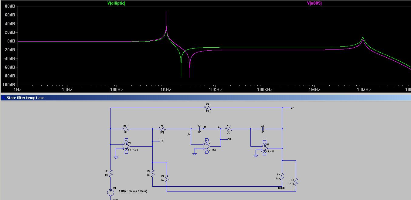

I was playing around in spice with an elliptic response by combining the HP and LP outputs. A 1:4 ratio lands the notch on the second H. You can choose any harmonic with other ratios. I haven't tried this. As you can see the LP response is lost and the higher order harmonics won't be suppressed. I suspect the noise will be higher as well.
One could follow this with an additional LP function but that means another section to tune.

Hello,
After changing the OPA134s for LME49710s the total harmonic distortion (plus noise) at 25 kHz has dropped from 0.04 % to 0.02 % so a good result for me. No change at the lower frequencies. Interestingly the Texas Instruments Audio Guide (1Q 2012) doesn't include the OPA134 but I did buy them back in 1999.
I had some trouble with the physical layout of the components so I am not keen to make any more modifications to the Distortion Analyzer in it's current physical implementation (The air turned blue when wires fell off and dealing with a DIY 'manufactured' double sided PCB without plated through holes tested my patience).
Thanks to davada for attaching the pictures and I admire the thd results achieved by coluke.
I think that I need to modify the design and produce a new board for the Distortion Analyzer with PCB mounted switches so it's possible to make changes relatively easily.
I have attached a picture of what I have ended up with for the Distortion Analyzer. Some of the component choices were dictated what what bits I had so it's in no way optimised.
I believe that I have drifted some way from the original post:-
My specification and preliminary measurement results are:
12 Frequency ranges:-
10 - 20, 20 - 50, 50 - 100, 100 - 200, 200 - 500, 500 - 1k, 1k - 2k, 2k - 5k, 5k - 10k, 10k - 20k, 20k - 50k, 50k - 100k.
Level nominal 5 V rms
Amplitude flatness with frequency within +/- 0.5 dB
Distortion and noise, measurement bandwidth limited by the rms to DC converter (AD536A). Also limited by the notch filter.
100 to 250 Hz 0.002%
1 kHz to 2.5 kHz 0.003 %
10 kHz 0.01 %
25 kHz 0.02 %
So not great but at least all the components are on one PCB. I really need to produce a Rev 0.2 PCB to tidy up the changes and remove some of the excess features to make the PCB smaller.
I haven't mounted the stepped output attenuator, the amplitude control potentiometers or the output buffers and coupling capacitors.
10 kHz 0.01 %
25 kHz 0.02 %
