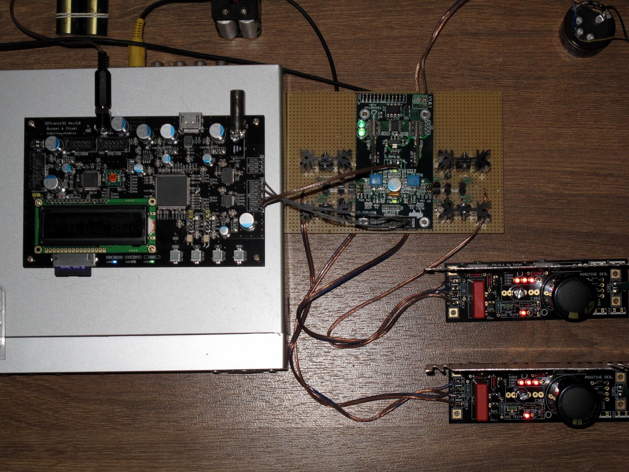

I'm done with the transport. I have found Nirvana :) which is SDtrans384 plus Sabre Reference DAC in sync mode with the transport. SDtrans now generates the MCLK for the DAC but in the future it ewill be a dual clock board tided closely to the DAC and it will send back to the transport the required clock for the played source file, standard or high resolution PCM.

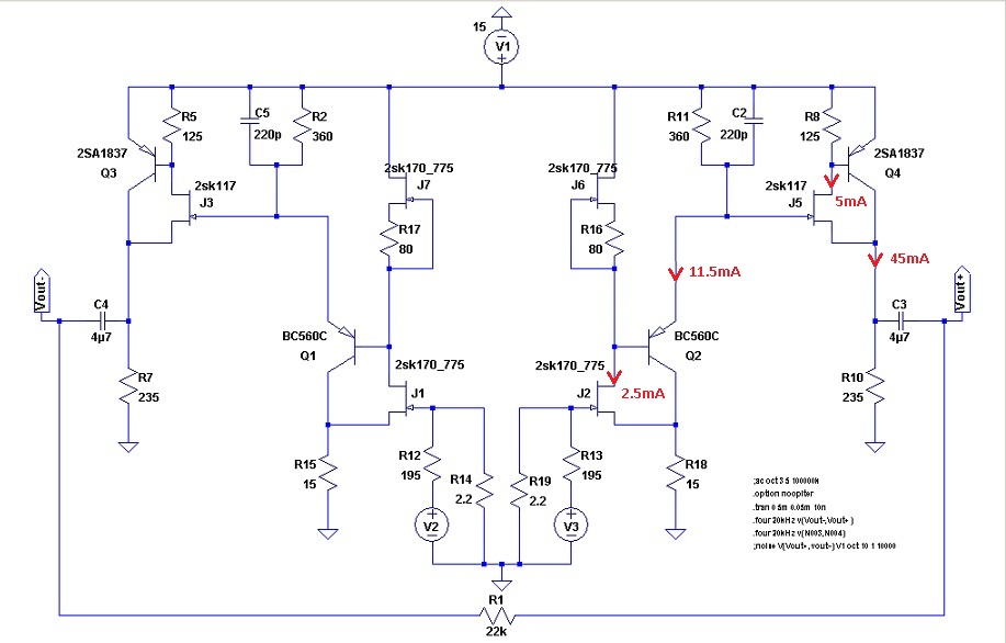

btw interesting circuit, does AVCC/2 play a part for gate bias? I cannot tell if R14/R19 are connected across actual ground, or across AVCC. IV resistors are increased to 2r2? I ask because I have some very nice TX220 texas components sfoil in 0.5% 0r66 that I could combine to make for 0r99 easily enough.

The offset voltage generated by the DAC do not mater. R14/19 are connected from the output of the DAC to ground.
This I/V stage can be seen as a microphone amplifier. The input resistor was increased to 2r2 in order to improve SNR to more than 125dB over 10-20kHz bandwidth. The Sabre Reference DAC is working now in "voltage mode" ... but is a voltage DAC anyway no mater what ESS is telling :p
No, it isn't. It was just for simulation. The only load seen by the I/V stage is the 22k volume attenuator located into the power amplifier.
Guys, as far as I listened, this is the best sounding I/V stage I have tested. And i had listened many.
It is very simple to construct, just be sure that jfets are sorted to the same Idss in every similar symmetrically position

I don't understood how you connect the Buffalo to I/V converter.
I think you connect Iout+ of BIII to J1 gate, the Iout- to J2 gate and the 2.2 resistors between the gates and out ground of BIII. I'm right?
Why some resistors have strange values (235 ,360 and 80 Ohm)? Are these values mandatory? Please let me know. Thanks in advance.

Hi Orazio,
I had listened to many I/V stages but I do not wanna give names and subjectively review them.
You are correct regarding how to connect analog outputs of the DAC to the I/V converter.
Now, regarding resistors, 80 ohms is just in simulation in order to get the same current value as the one in real life. Instead of resistors value I will post a schematic with currents for every stage.
Stay tuned.
I'm not experienced like you, but I think the resistor values depending from the Idss of Jfets and hfe of BJTs to give the current that you want. For example the 2.5mA that polarize J1 and J2 are feed by CCS formed by J6 and J7 and R16 and R17. Right?
And 2.5mA depending by Idss and resistor value.

How about raising the ground reference to AVCC/2 to be compliant?
