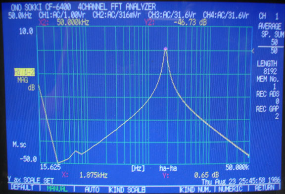

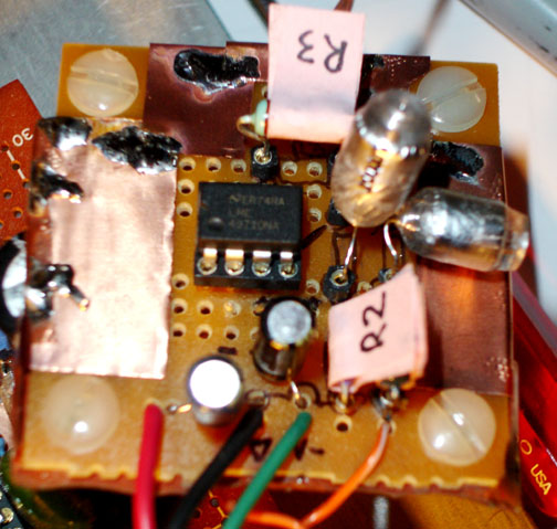

I should have more results for an easy bandpass filter to lower distortion of a .01 % source in a couple days. This technique was already reported by another post above.
It easily takes a .01% source to .002%, maybe more. To build it you need one op-amp, 2 caps, and 3 resistors to make the circuit. Surprisingly, or not, I could not get an AD797 to work in it without oscillating. The oscillation made huge harmonics, which gave it poor performance compared to other op-amps. The basic circuit is here
http://sound.westhost.com/project63.htm
I tried two versions, Q=9, and Q=6. The Q=6 worked better. I used common values for all parts, carefully matching the two polystyrene .01uF caps. For about 2kHz, I used R1=47K, R2 = 680, R3= 100K.
It ended up being 1.91kHz. I determined this by feeding the sine source in to the filter then adjusting the frequency while watching the output on a scope. My source was an HP8904A.
I use my ono sokki CF6400 to test a few op-amps. There was about 3dB difference from the best to the worst. The best were the LME49710, and AD847. After that, the OPA134, OPA604, and TI NE5534 were all also decent. Any of these would work fine, at least they did for me, without oscillation problems, in a fairly crude proto board. I used panasonic FM 33uf 35V +.1uF ceramic mono for bypass on +/- rails. Also used a copper foil ground plane. see pic below.
Below is a the log-log response of the first filter, Q=9, built with R1=68K, R2= 470, R3= 150K. Both used cap values for C of .01uF
The Q=9 version had slightly better measured attenuation, but had higher residual distortion on the initial readings made by the Ono Sokki 16 bit analyzer. I plan to use my M-Audio Audiophile 192 next and see how that fairs with internal and external sources.
Here's the attenuation measured at offset from fundamental where these harmonics would be
Q=9
2nd -21.3dB
3rd -26.2dB
4th -29.1dB
5th -31.3dB
Q=6
2nd -18.4dB
3rd -23.4dB
4th -26.3dB
5th -28.4dB
the Q=9 plot is below
Q=9
2nd -21.3dB
3rd -26.2dB
4th -29.1dB
5th -31.3dB
Q=6
2nd -18.4dB
3rd -23.4dB
4th -26.3dB
5th -28.4dB
