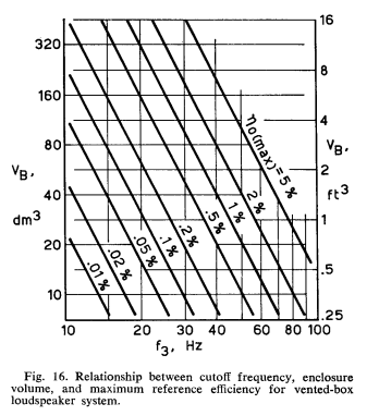

Cab wise, we're always trading (LF) efficiency (peak SPL) for BW per the attached vented limits, so figure out how much power needed to meet the needs of the app with the assumption of at least +20 dB of dynamic headroom required and need to add +6 dB for every doubling of distance, i.e. if listening at a 70 dB avg./your ears 2 m away = 70+20+6 = 96 dB = ~0.25% = ~10 L min. box size.

Very interesting graph, thank you!Cab wise, we're always trading (LF) efficiency (peak SPL) for BW per the attached vented limits, so figure out how much power needed to meet the needs of the app with the assumption of at least +20 dB of dynamic headroom required and need to add +6 dB for every doubling of distance, i.e. if listening at a 70 dB avg./your ears 2 m away = 70+20+6 = 96 dB = ~0.25% = ~10 L min. box size.
Maybe I expressed myself wrong... I am NOT into the ~10 L boxes... Probably I could say that even ~40 L is ok in size, but not much more.
I want to invest a little more into the speaker driver, which plays well low frequencies in reasonably sized boxes

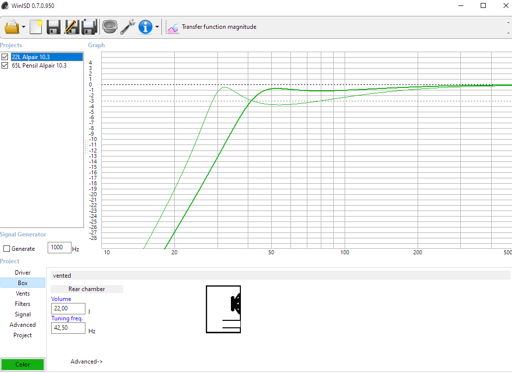

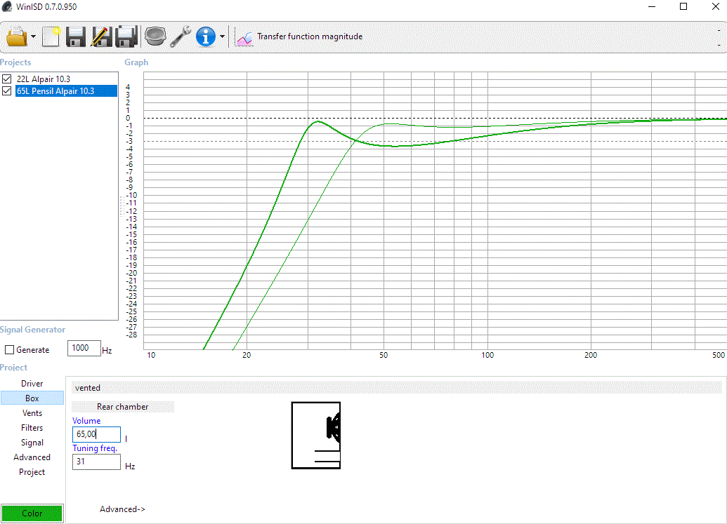

What is F3 of those boxes? If I model quick and dirty with winisd 65L tuned to lets say 31L it... does not look good, does it?
The 10.3 can reach an F3 of 40Hz in a 22L reflex tuned to 42hz. Should that do it?
Ty waxx, It looks good!
Comparison of 65L Pensils and 22L.
You can't model a Pensil in WinISD (accurately) because it's a mass loaded TL. That's why you get an ugly curve when you push the box volume way up.What is F3 of those boxes? If I model quick and dirty with winisd 65L tuned to lets say 31L it... does not look good, does it?
Try 15-16 litres, tuned around 45-47Hz QB3.
jeff
I did my own at 17.9L tuned to 45Hz actually, and that's my daily office speaker. But you can tune it lower (i did it before) with this driver and i thought that is what he wants, 45Hz is maybo not low enough for him. For me it's not, except in my office (where it's mostly background music or video). My speakers in my living room/music room are tuned to +/- 30Hz.You can't model a Pensil in WinISD (accurately) because it's a mass loaded TL. That's why you get an ugly curve when you push the box volume way up.
