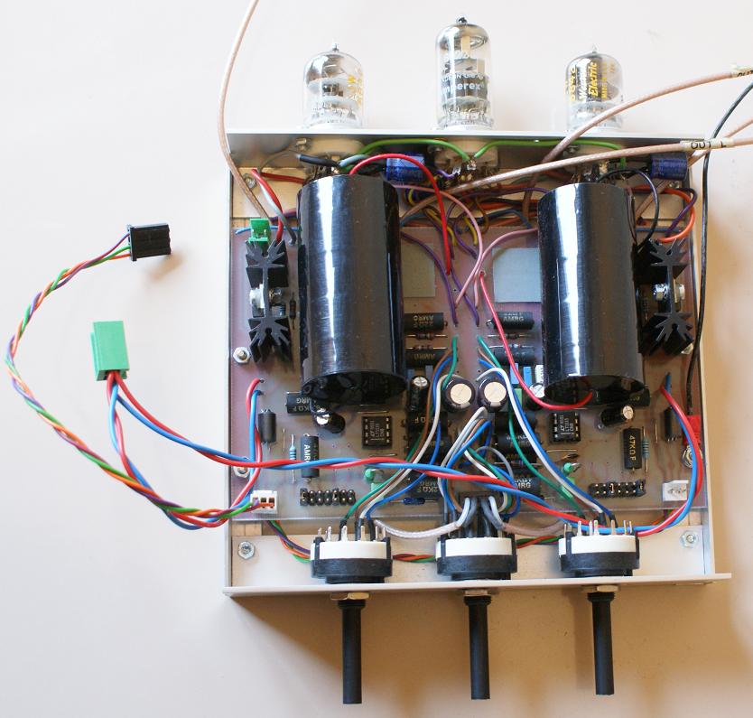

In the meanwhile, I have attached a picture of a module that I have built some years ago, and I will use it again, for my "noise-measurements-set-up".
This module have 3 selectors for the gain: the central one have 5 position: 40, 45, 50, 55 60 dB and acts simultaneously for the two channels. The other two selectors, acts one for the left channel and the other for the right one. In this case, they have 4 positions with increments of 1 dB. (0, 1, 2 and 3 dB). This technique is very useful for to use it as "balance" control, for to compensate differences between channels in some cartridges.
Anyway, I will use this module as "noise amplifier". (using only the op amp stage)
cheers!
cheers!

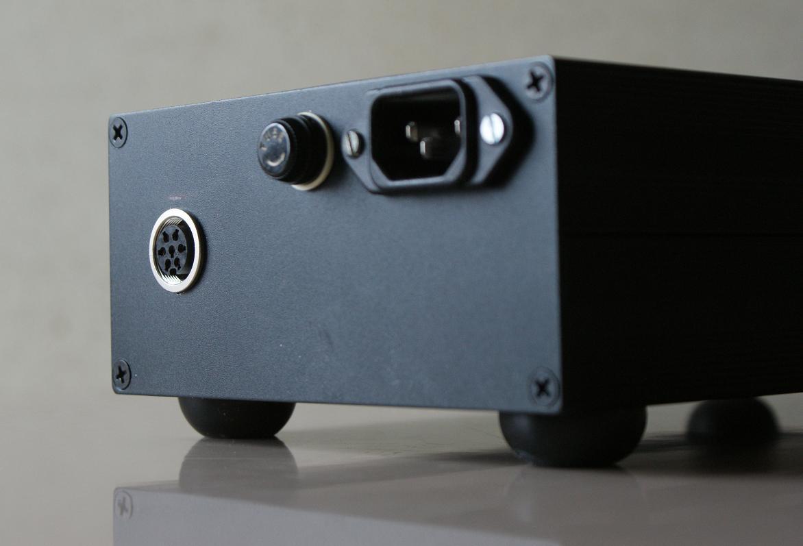

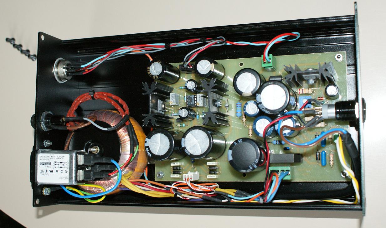

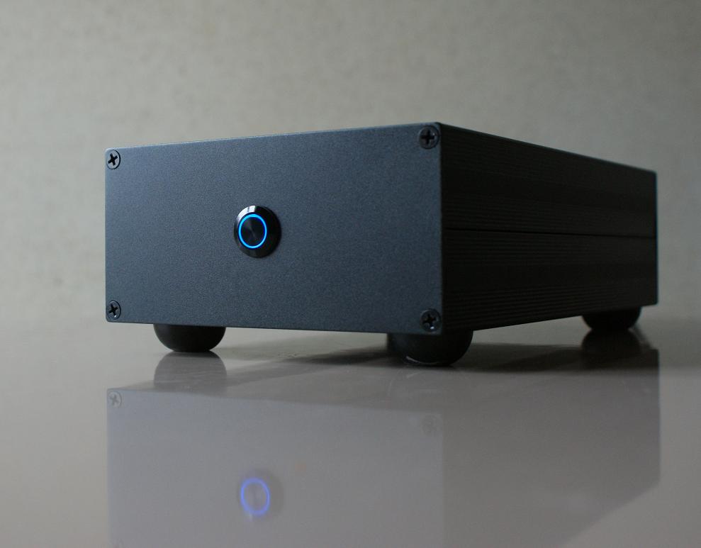

Now, I just have finished to put the power supply into a decent box. Now, I will build some sort of shielded container for the circuits and the "Device Under Test" (DUT). I have not idea how to do it until now, but I will found some cheap solution.
