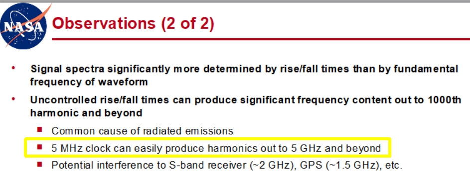

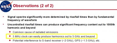

I am definitely not an expert in this area, but it appears to me the Collins paper disagrees (my comments in []).
The examples in Section I as well as certain precise tracking applications [3] demand a 10 ns RMS jitter [which is 6 orders of manitude compared to what is discussed here]. Unfortunately, a slope gain of 10^6 is required to bring the 1 V/S signal up to digital logic speeds, and, if all of this gain were incorporated into a single stage [which is what the sine/square under discussion is] with the above parameters, it would produce a jitter orders of magnitude too large. Very careful custom design of the stage amplifier could lower the noise spectral density by 6-9 dB; however, the required jitter could never be achieved in a single stage of slope amplification without a major breakthrough in semiconductor devices. The amplification must, therefore, be performed in stages as described in the next section [which is not the case here]

Yes, can, in a setup with the craziest edge rates and no standard mitigations. Plus, the quote disregards magnitude. I'd love to know how many products have you seen through EMC testing and how many showed significant ~5 GHz emissions from an LVCMOS clock? I know what I've seen.
Overall, just another bogeyman to point to. I'm not sure why you're worried about behavior at the extremes when you're still working with eval boards with fundamentally flawed layouts that can't be fixed... which then end up further butchered with "mods" and connected to a bunch of off-the-shelf PCBs (including clocks) cobbled together.

Yes, can, in a setup with the craziest edge rates and no standard mitigations...
