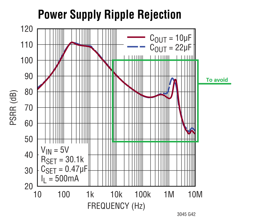

I presume you have to avoid the green region you can see in the picture below. If you use a linear power supply to feed LT3045 there is no cause for concern about higher value for Cout.

The region in the green box shows improvement with higher C!?
I don't understand what is special about the 'green region' ? The chart clearly identifies only two, low Cout values, not the larger values in question.

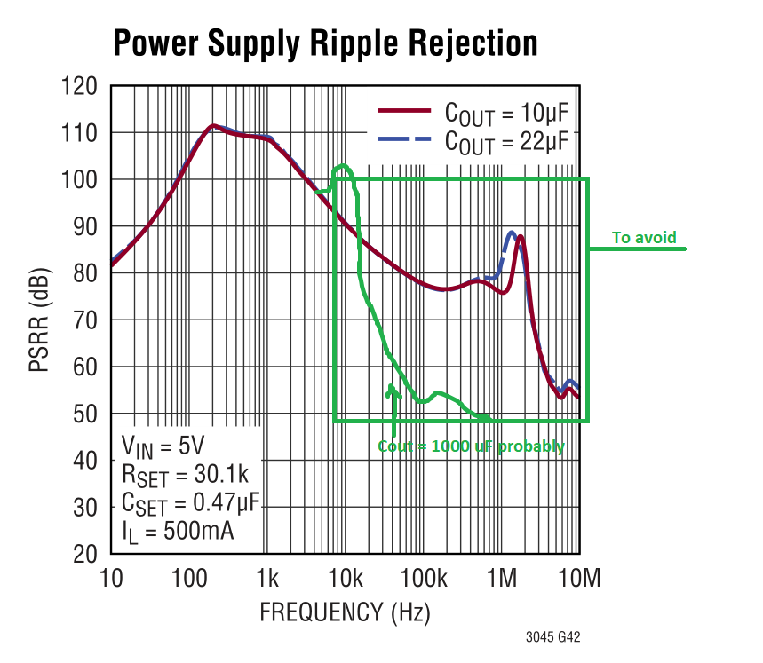

Yes, we only have 2 low Cout values, but we can see how PSRR of LT3045 decreases depending of Cout value. An exaggerated picture should explain better than words what I mean, see it bellow.I don't understand what is special about the 'green region' ? The chart clearly identifies only two, low Cout values, not the larger values in question.

Did you just draw that green curve ? Wow ! Fast and nice. But maybe not so believableAn exaggerated picture should explain better than words what I mean, see it bellow.

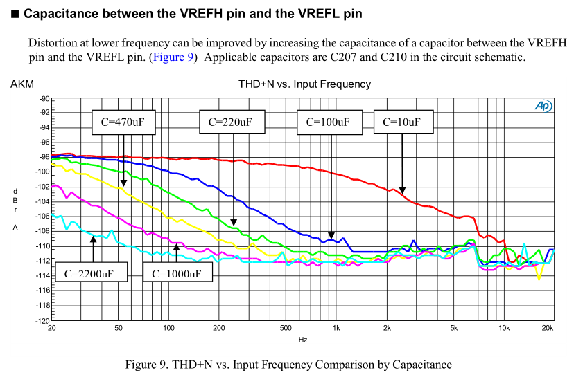

For increasing THD+N at lower frequencies according to the AKM datasheet.Uh, Ok, maybe you don't loose anything audible there. But I still don't understand why you feel the need to increase Cout ??

So , back to your initial concern about Cout.
According to LT3045 datasheet:
- if recommended 10uF Cout is used, PSRR severely degrades for ripple higher than aprox. 2 MHz , see the graph I have attached in my previous posts.
- if 22uF Cout is used, PSSR severely degrades for ripple higher than aprox. 1.3 MHz
We can see that the increasing of Cout reduces the ripple rejection bandwidth of LT3045, but even for 22uF we are still talking about MHz order frequencies.
Now, you are using a linear power supply which has a ripple at 60 Hz or 120 Hz depends of rectifier, but this ripple is already reduced by LT1963 regulator you use, so I don't understand where your concern about Cout come from?
Why worry in this case if LT3045 ripple rejection bandwidth degrades over 2 MHz, or over 1.3 MHz, or over 0.1 MHz?
Increasing... THD-N is decreasing in LF at higher C. How are you reading this alt. expressing yourself?

With LT3045 you might not need the huge cap to achieve the THD performance that AKM shows with the 2200uF cap. I'm not sure what regulator they use on their evaluation board, but I am sure it is a lot noisier at low frequencies than the LT3045. That huge cap is just pushing the corner frequency of the filter lower.

You are right, it is about decreasing distortions, but not increasing them, of course.Increasing... THD-N is decreasing in LF at higher C. How are you reading this alt. expressing yourself?

I referred to the bandwidth limitation region of the graph only. If Cout is 22uF, you are right - PSRR increases, but the inflection point of the graph is moving to the left and as you can see, if there is a ripple in the input circuit to aprox. 1.8Mhz is better for Cout to be 10uF because in the 22uF situation PSRR is already descending.
I admit it may look strange to someone who cannot read my thoughts.
