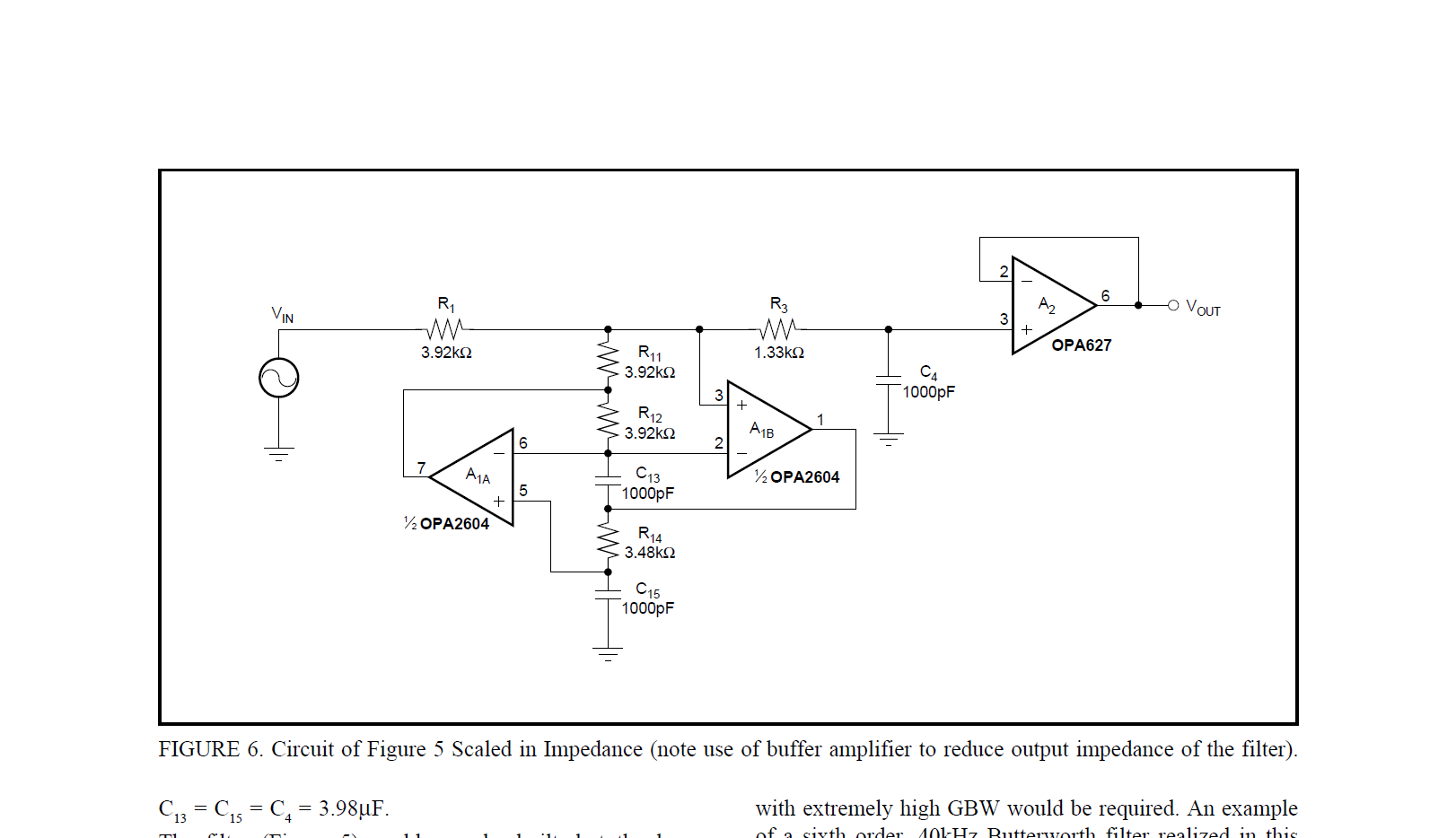

I was using a calculator from AADE and wondering what should I use for Zin AND Zout. Just experimenting.
Yes I looked at that kind of active filter when I was considering how to build my elliptic. It needs more opamps than the form I eventually chose and also depends more critically on the opamps' GBW. Seeing as the opamps with the highest GBW tend to be current feedback types (at lowest cost too) I looked into making it work with those for a while before giving up in favour of the less complex (in active components) schematic I'm showing on my blog.
Looks to be a Bessel (phase linear) type. Very good for phase, very poor for stop-band rejection. It might suit a 16X oversampled DAC design where the designer was mainly concerned about phase distortion (i.e. having no overshoot on a step function).

Cut off frequency's a subjective judgement call. I aim for -50dB at 24.1kHz, which is the first frequency for images to appear. With a filter around 11th order, this puts the corner frequency somewhere between 17 and 18kHz. If you want more of the audio band to listen to you can relax the image rejection (which I chose just on a whim) or you can increase the filter order.
As regards the steepness - again its a trade-off. Steeper filters have better rejection but poorer phase response. Eliminating the images improves the dynamics, subjectively, results in a lower perceived noise floor. A shallower filter will probably sound better than no filter at all.
