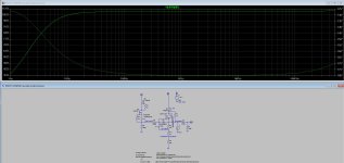

Here Ya Are.What's the output impedance using CCS for 12B4
Simulation shows -3 db is at ~180 KHz for 12B4 CC Loading
When R = Xc, if we know f we can solve for R
f = 1 / 2*PI*RC……………………….f ~ 0.16 / RC
F ~ 180 KHz and C is 200 pF
R ~ 0.15 / fC………………R ~ 0.16 * ( 0.2*10^9 ) / (0.18*10^6)
R ~ 0.16*1.25 (10^3……………….1.25K
The output impedance largely dependent of "lower" FET.

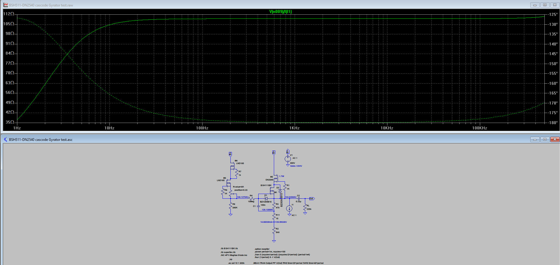

As you can see, the simulation of gyrator shows 109R impedance at 1kHz (105-109R at 10Hz..100kHz).I measured the output impedance of Ale's Hybrid Mu-Follower rev 0.8 with BSH111BK is 870R, load is 26.

Thanks for the links Bela, you are right the lower fet used is 2SK3557 not BSH111BK (I was confused because I own four PCBs sorry), I do my maths:
Ale's formula:
Zout = (Rp+Rmu)/(1+Rmu*gfs)
Zout = (7600 (tube 26)+470) / (1+470x 24mS for 2SK3557)
Zout = 8070 / 11281 = 715R as Zout not far the 860R measured
Ale's formula:

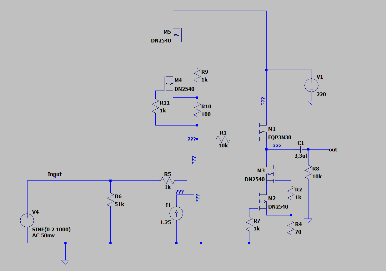

I have an old commercial pre based on 12b4a and its a wet dog. Wouldn't mind improving on it . I can use plate choke or anode current source or both and tweak it a little. I don't want to hack the design completely.I built a 12b4a preamp, tried multiple iterations and landed on my current version using Ale's gyrator and I have no desire to build anything else.
I tried a lot other preamp circuits 6sn7 01a 4p1l 2p29l and two well respected commercial preamp.
Psu is a 83 valve plus RC string. Regulated 6.3V filament.
Hi analog_sa,This is probably not news but ime a dht+mosfet follower kills both objectively and subjectively any of the low Rp triodes.
Do you have an exemple (schematic) for such a dht+mosfet follower?
Hi analog_sa,
Sure. Seems like LTspice lost the 4-pin triode symbol, sorry about that, no time to fix it atm. The actual mosfets i use in the ccs are IXTP-U-Y01N100D. Tube is 10Y.

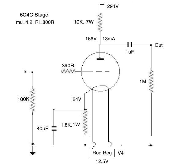

I just finished a 6C4C line stage which is very interesting - exceptionally lean, clean and detailed. Just about the complete opposite of my 26 stage which is full and lush. It's different from anything I've heard or built. Intriguing. For what it does it's quite remarkable, but it isn't full and lush at all. Very good on classical music and piano, wide precise soundstage. Dynamic and effortless - it's an output tube after all. Low gain and 800 ohm output impedance. Svetlana quality tubes. I could probably put more current through it. KBG PIO output caps.
