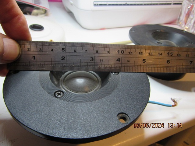

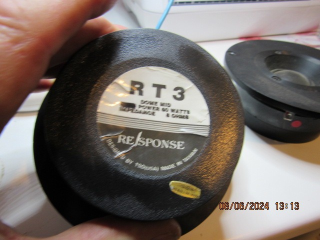

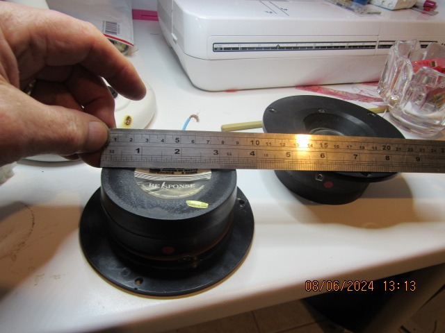

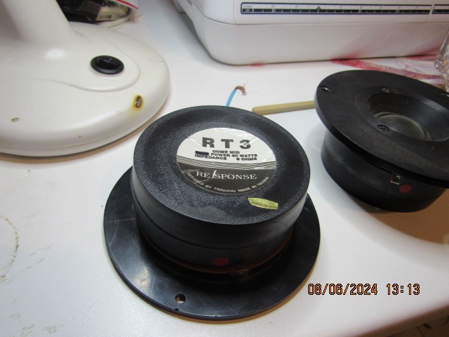

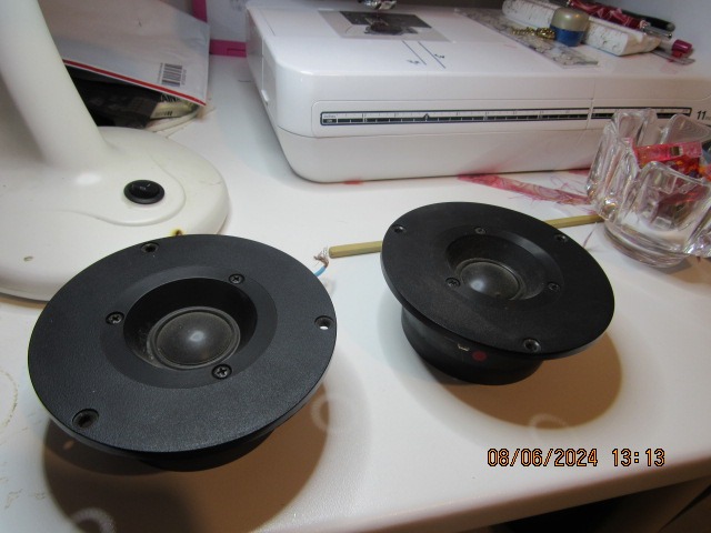

These are big tweeters that used to be sold at Jaycar way back
Designed by TSG in the USA if that means anything to members

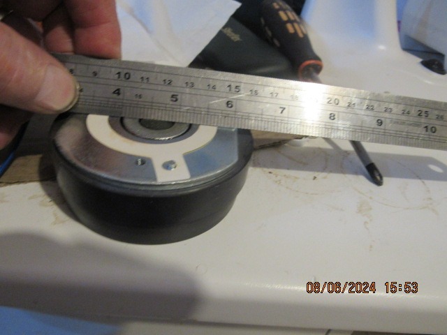

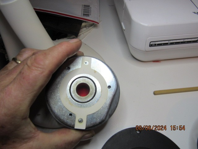

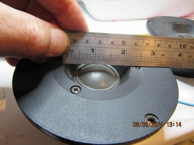

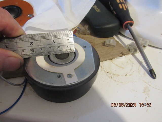

32 ~ 35mm Voice coils [ I'll take the faceplate off and measure later] with a drilled pole and a plastic back cap.

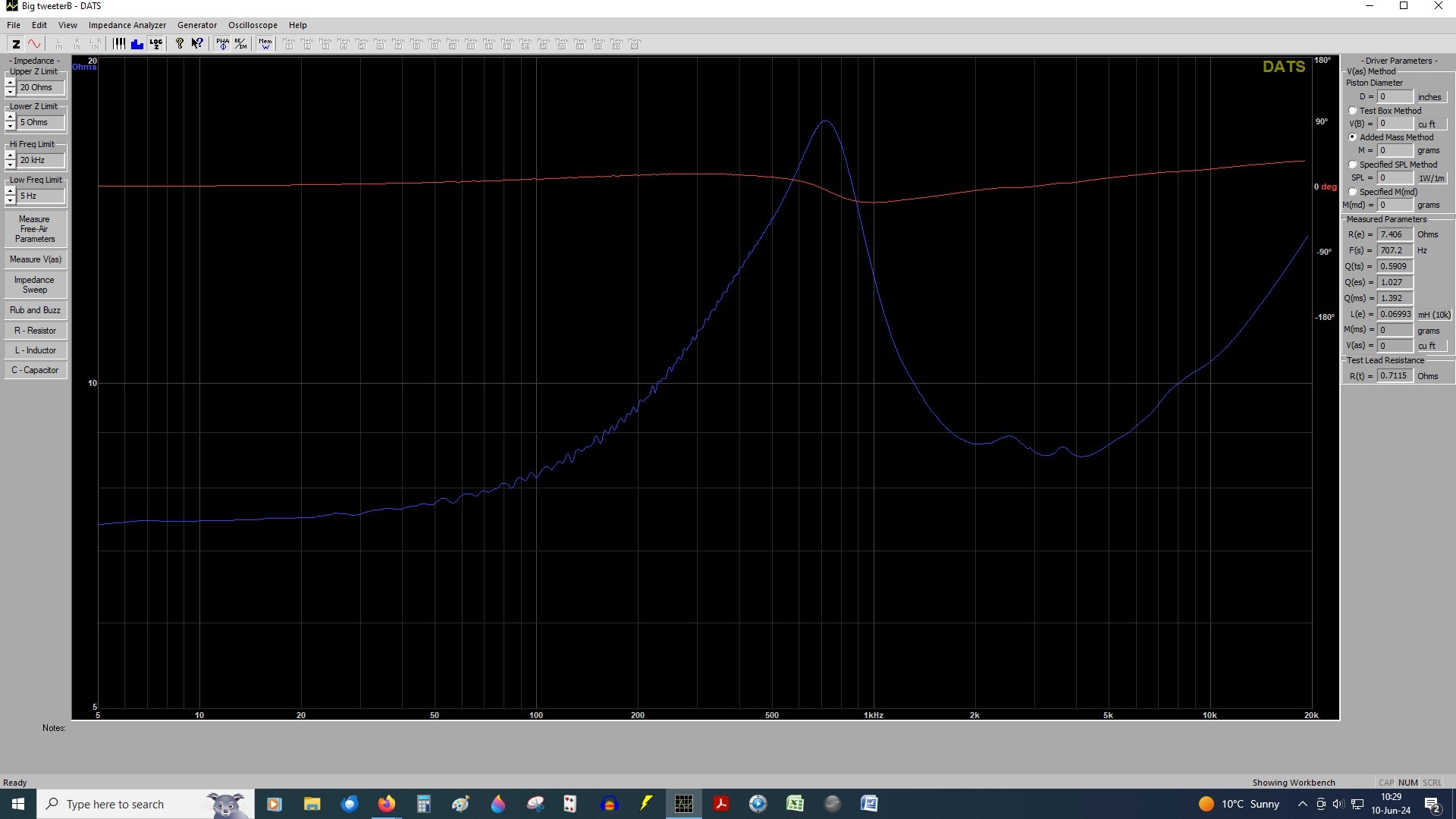

At the moment while they are working the Fs is much higher than than the catalogue says they should be. One sits at 665Hz and the other at 580Hz and it should be much lower around 350/400.
Leading on from the other threads on tweeter modifications is the best way to play with these taking the back cap off and making it larger so it can be stuffed with something like long fibre wool?

32mm

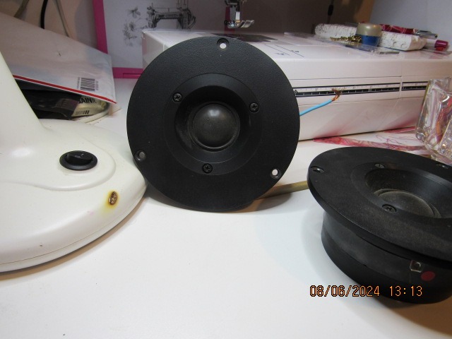

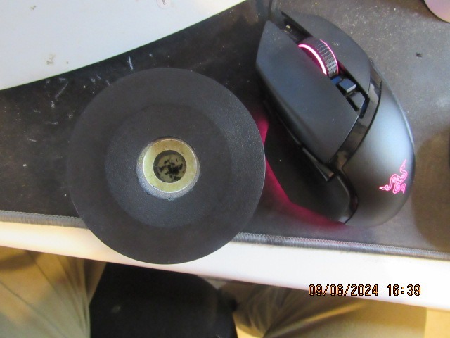

Here are the first pix
I can't find my old catalogues to double check my assumptions about the resonance frequency, but even so I'd like to get these to mate with that S/H garage sale Peerless woofer I got a while back.
Would heating in a low over damage the drivers assuming I popped the voice coils out

Standard answer to that is o drill a hole thru the pole piece and dramatically inmcrease the back chamber.

I read this as a 32mm VC

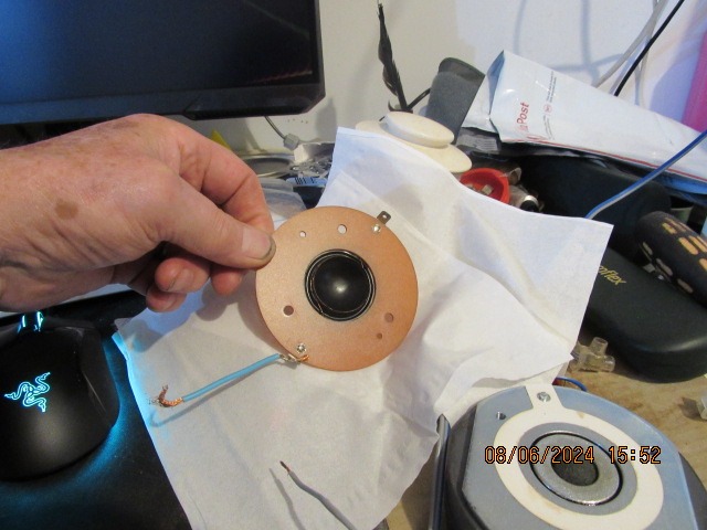

Some sort of plastic polymer dome and I might need to re-do the ferrofluid, it has dried out a tad.

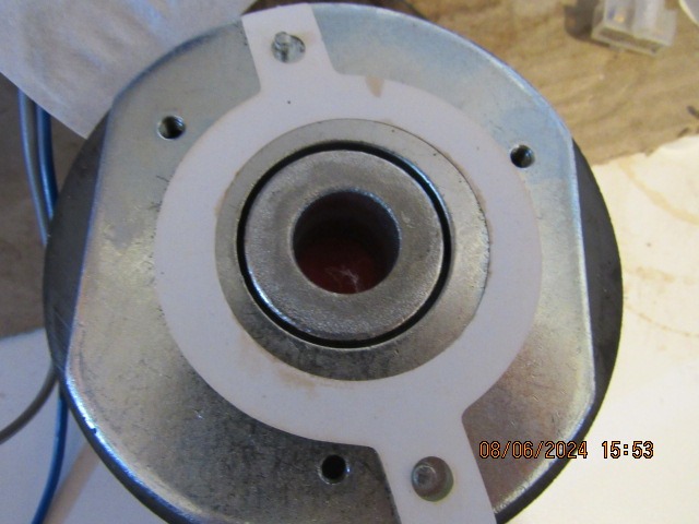

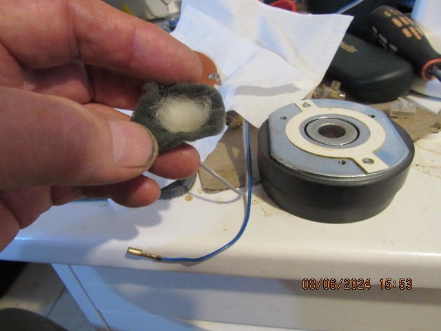

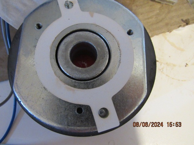

I got my little mosquito clamps and pulled out the factory damping via the pole and it was simply some semi rigid artificial felt and some open cell foam that has started to break down and go sticky and after re-assembly Fs has gone down to 550 but with secondary resonances now
I'm guessing the secondary resonance is a pipe resonance after taking out the long fibre wool I put there a while back?

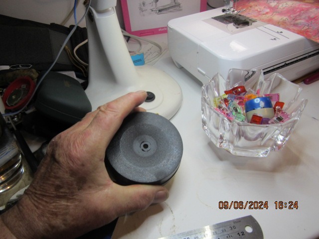

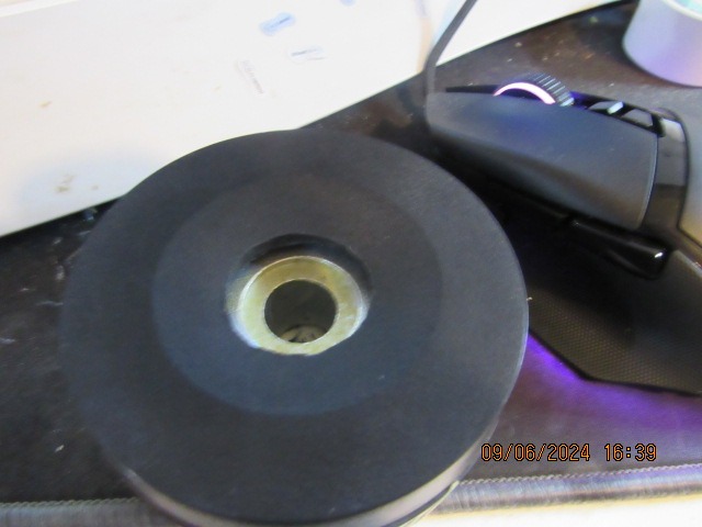

I might just have to take a saw blade to the plastic and use brute force to remove it but perhaps [ and this is a big "perhaps"] maybe I could use a 16mm spade bit down the hole and drill away enough plastic to allow me to glue something to the rear.
Lets see how this experiment goes.

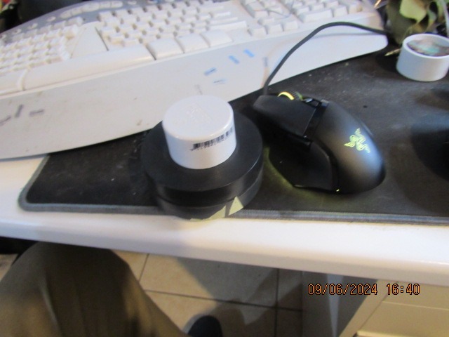

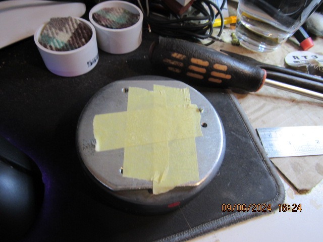

I bought a new spade bit, a plumbing end cap and some special plastic rated superglue.
Very carefully cut out a 25mm hole and glued the end cap over the hole. Just for security and making sure it was airtight I've also run a bead of plumbers silicone around the base of the cap.
I've used some scraps of 3-M Thinsulate and a patch of woollen blanket as the damping, not sure about the woollen blanket but I know Thinsulate works reasonably well.
I'll need to leave them now for at least 8 hours and then I'll test them using my DATS and that should give me an indication, I will need to find some more long fibre wool tho, for the damping in the pole piece

Not even 4 hours and the silicone has set well
Interesting results so far
Fs hasn't changed down, it has gone up on one driver and stayed the same on the other. What has gone away are the secondary resonances and while I don't have silver ears they sound cleaner and clearer to me.
I've been simply playing music with a 10uF cap in series
But I did clean out almost all the FerroFluid in the gap and this may have made a difference.
If these were designed to use FF I guess I should buy a bit and replace it, does using FF lower the Fs at all?
