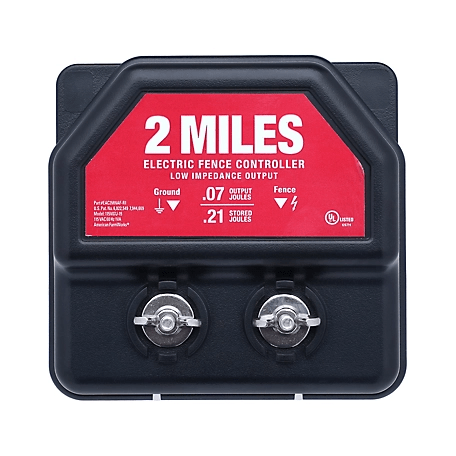

I'm not sure that there are many pots of any type that can withstand a few thousand volts, not that many 10k resistors either, come to think of it. Perhaps putting lower value resistors in series to make up the final value.
On balance though, I think the best and easiest idea is to buy the one Mattstat posted above.

I built one about 30 years ago.
I selected the power by selecting the value of the capacitor on the primary side of the output transformer.
The transformer ratio sets the output voltage and the capacitor multiplied by the primary voltage gives the shock energy.
The one I built used the flash driver from a disposable film camera powered from 5V to charge the capacitor and a VDR out of a filtered power strip to trigger the thyristor that sends the pulse to the output transformer.
